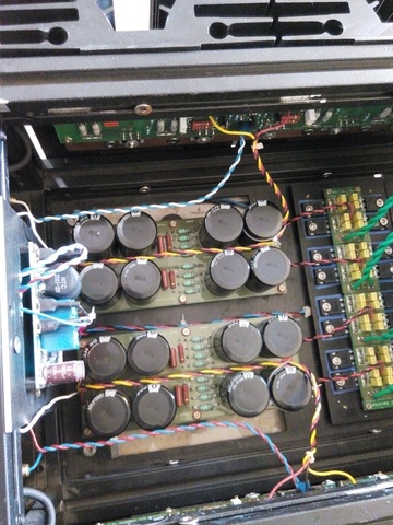

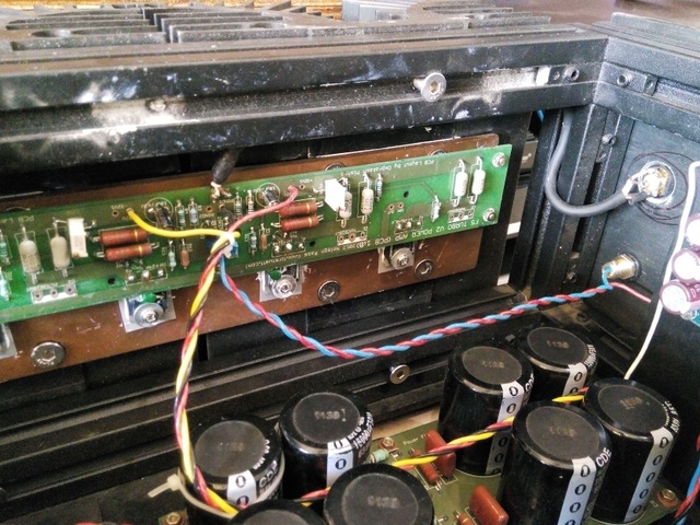

Have 1.5A bias for Class A output up to about 35W, expect this to drop during summers as the thermistors clamp hard. I am using a thermistor on each device. Higher is not possible within this kind of layout.
All things considered, it sounds great. Biased up first time without any issues. One channel was distorting badly at high levels, traced down to a frayed input wire. As simple and trouble-free as the original.
Props to Mr. Pass for a great amp. I still prefer the sound of the original F5 (I think, as I savaged it to get some parts for this build). I only had an old pic to put up....
Using two banks of 100,000uF for each of the amps post R. The forward sink takes a bit of time to reach temperature, but I still have under 50 degrees on the rear sink (adding a bit of headroom for the heatspreader). I am slowly convinced that my bigger build will turn out quite well, provided my back holds up.
I have since installed all the panels, and added a heat barrier between the caps and the heatspreader. The transformer runs warmer than I expected, even though it's a pretty solid 400VA unit. I may need a totally perforated top panel, but we'll see.

The rear sinks (the ones at the top of the pic) have a very long thermal travel distance (equals high thermal resistance).
This reduces their effectiveness.
You will gain much by spreading out the output devices so that all the sinks get a more equal share of the heat load.
Yup, I know 😀 Those are the front sinks, the rear is at the bottom of the pics.
I had planned on mounting the cap boards at right angles and mounting the PCB in the center - but for various third-world logistics reasons that didn't work out and I needed the build finished while the ambient temperatures were low enough to arrive at a reasonable level of bias. I've been harassed about space between the outputs plenty times in the past, but in practice it's not as bad as it seems.
The same sinks, when in one piece were 10" tall and could deal with 80W of bias though a single pair was very stressed out at that level. This version can do just a hair under, the added thermal mass of the 8mm heatspreader helps with keeping temperatures very similar at similar bias levels.
In any case after a few hours run the temperature difference between the sinks is just 5 degrees at the sink center. Initially they run quite cold, but catch up given time.
I also am depending heavily on the fact that the amps will be running flat out for a large portion of time. In which case the temperatures are usually much lower than at idle anyway.

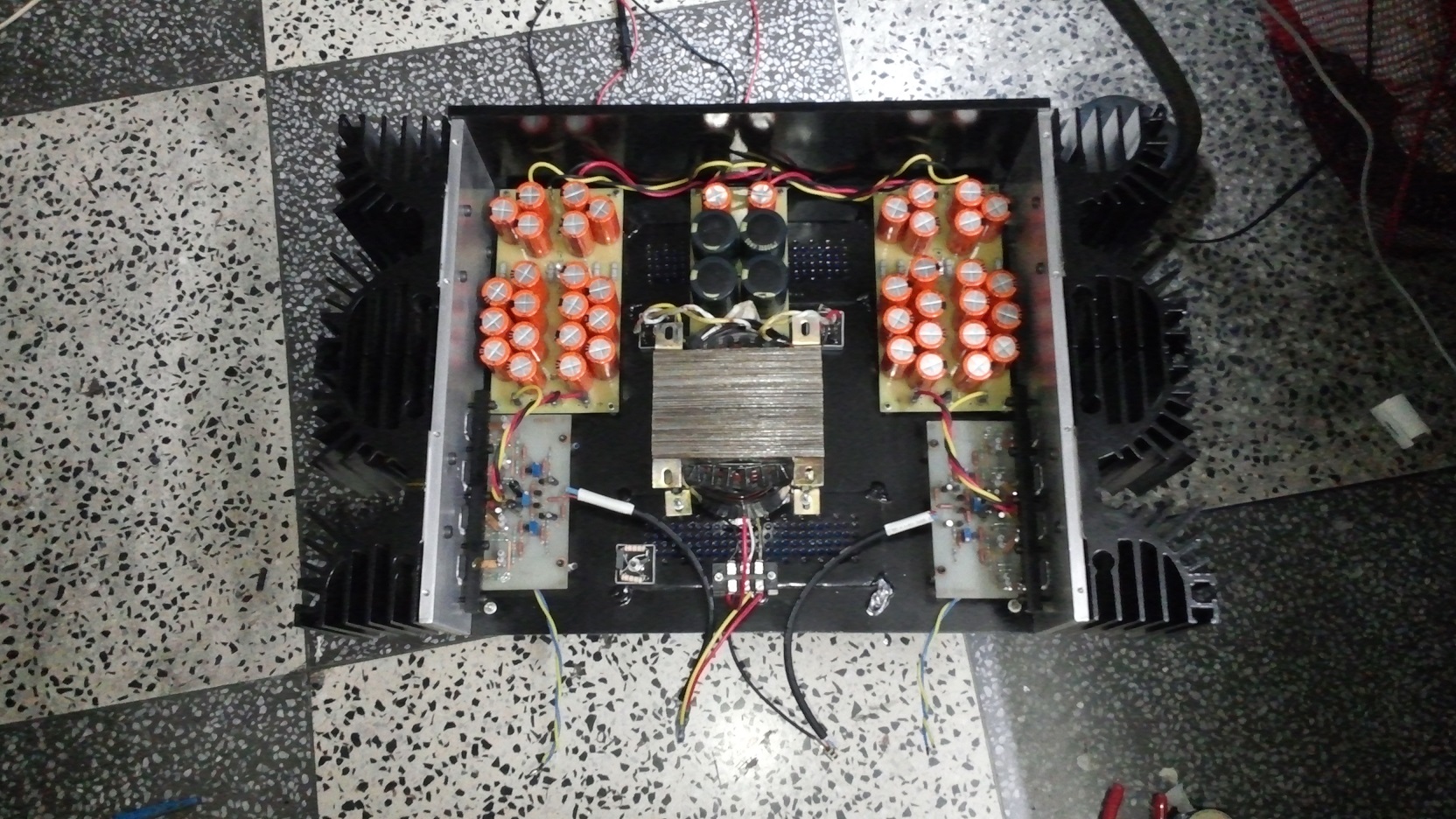

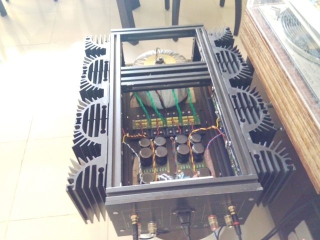

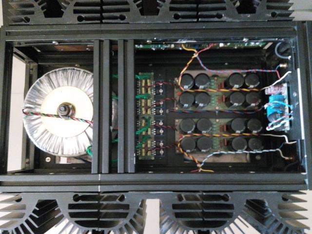

F5 Turbo build of Friend, playing nicely
My friend got help for soldering these part over PCB. He made his own chassis, heatsink height is 7", footprint is 12"X 24". I have completed wiring for this. Both channel are biased for 0.6A per device and running for 15 hours since last 4 days. Heatsinks are stable and could be touched all the time forever. Sounding nice with ~80W/ch biasing. Output offsets are ~11mV, -3mV after 15 hours continuous running. Complete silent, no hiss no hum. This is my third F5 turbo.
I haven't added MUR3020 diodes on amp board yet but planning to do so.
Big 1KVA transformer with 4 x 24-0 secondaries. Using softstart board from *bay. Ground isolator are from both channels 0 level are hidden below softstart board.
Power Supply with discrete diodes making 4 bridge rectifiers for 2 channels. Ground is derived at capacitor bank.

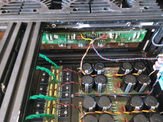

Board wiring-
See the signal wires, input is Gotham GAC2 cable with screen grounded at RCA socket -
Over all beauty missing faceplate yet.
Its huge build with >30Kg weight. We need 2 people to move it around.
