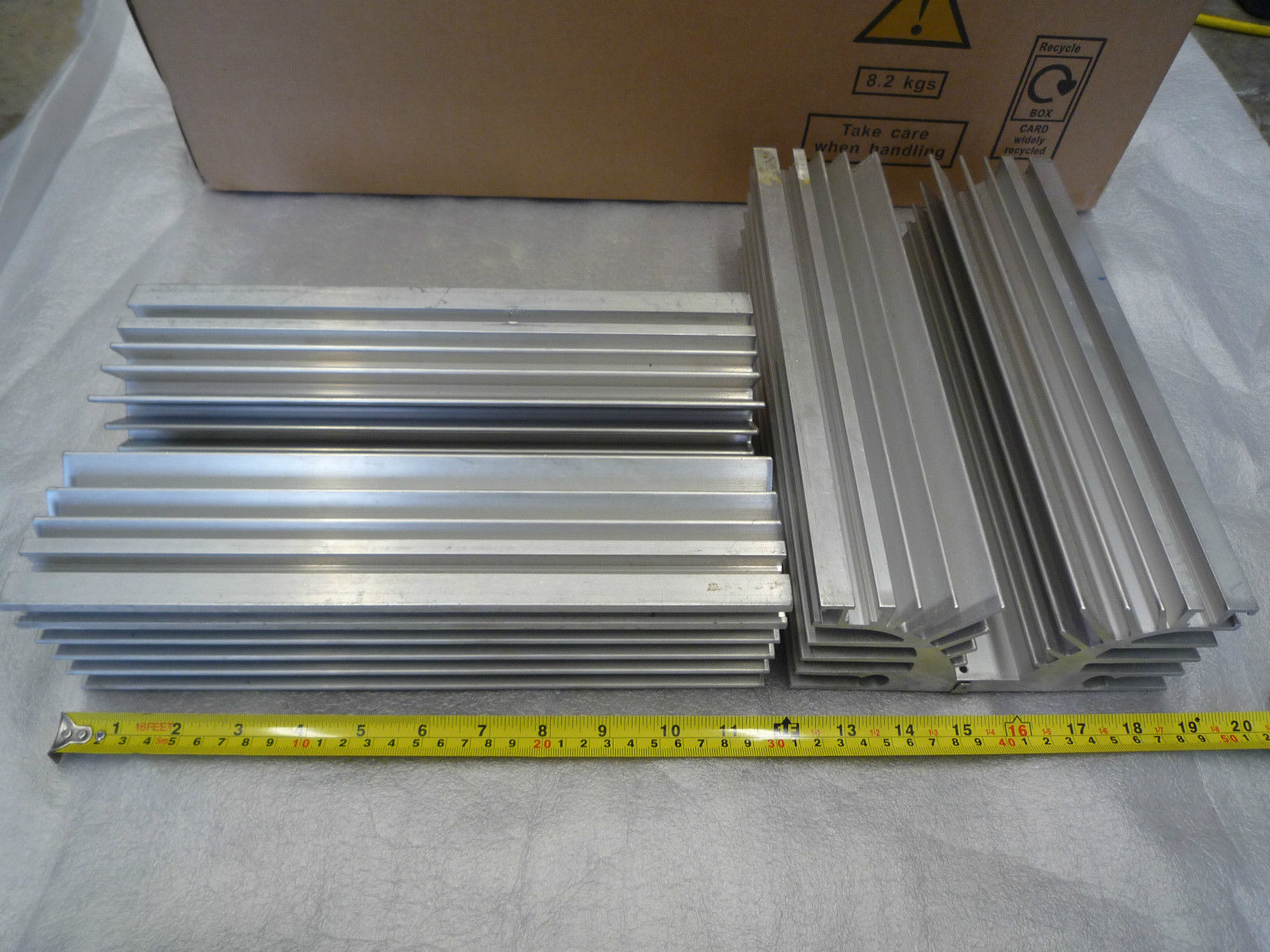

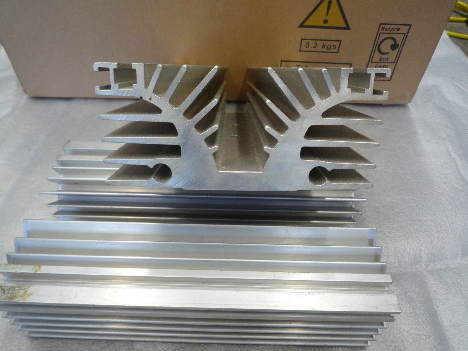

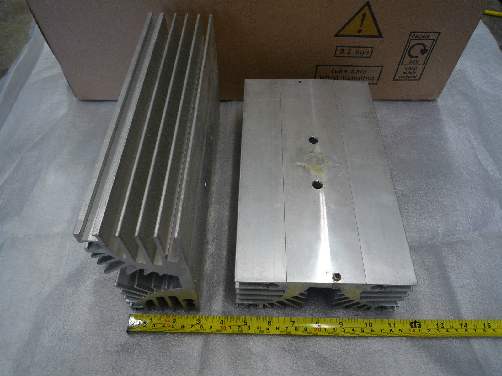

Rix,
They look good.
As I see you have two options on how to use them.
Keep them long and use two face to face to create a tunnel (preferably vertical with fan blowing at the bottom) to be fan driven.
or
Saw them in half and use as passive in a chassis standing 149mm high.
One pair, side by side would be 348wide by 149high by 75thick.
This could be a mono-block,
or use two pairs on opposing sides for a two channel version.
One big mistake with most F5t I have seen on the Forum, is separating the N channel devices from the P channel devices. This is probably down to the way the PCB have been produced.
It would be better to have each P next to an N. This N+P pair can be fed power keeping the loop areas small. Then set up lots of N+P pairs until you reach the dissipation capabilities you require. You could probably put two N+P pairs on one 149mm tall sink.
4 N+P pairs would make a biggish mono F5t, all on one side as described above.
Worth doing a FET + sink dissipation test on the bench.
See how much DC power 4 mosFETs on one 300mm tall sink can dissipate at the temperatures you think you can tolerate. Do this before sawing in half.

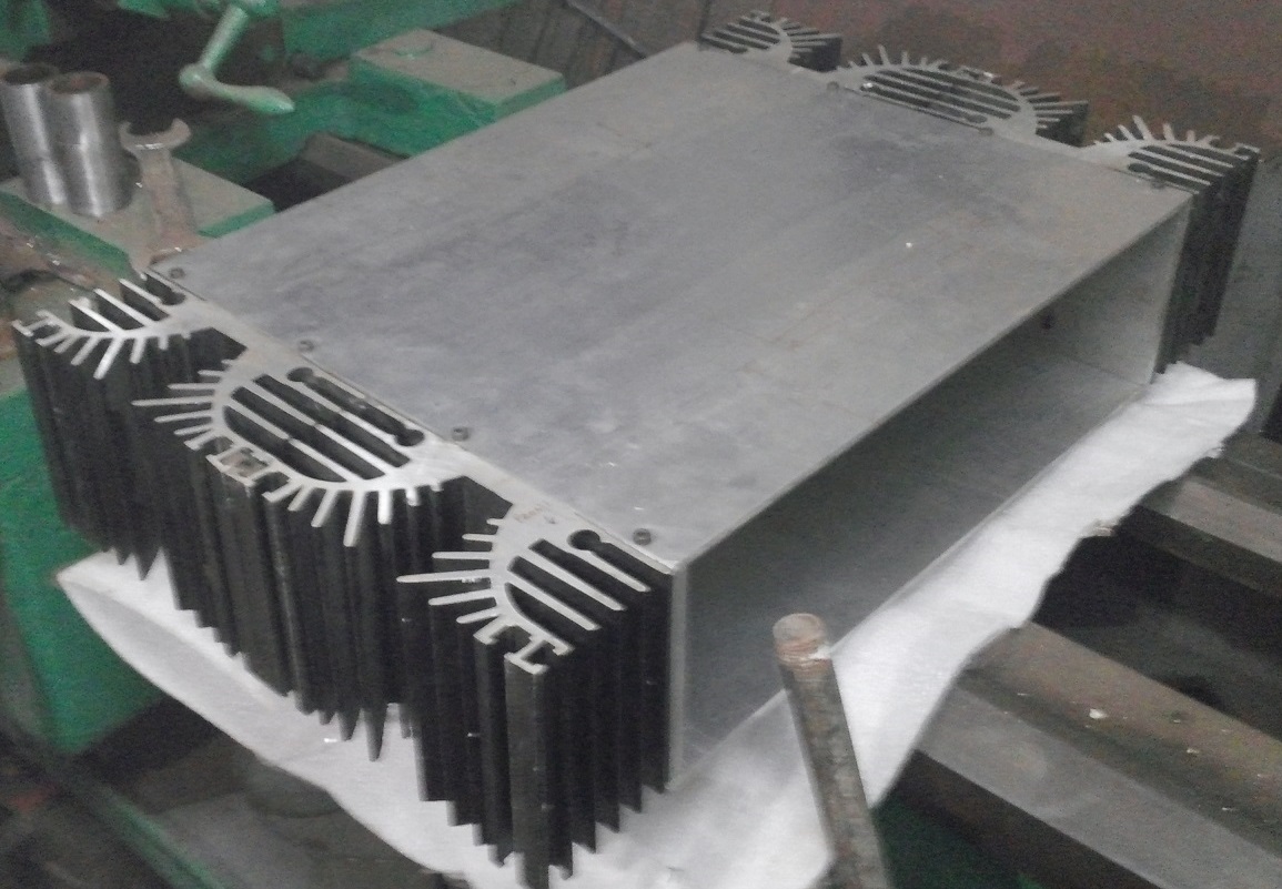

Rixsta,
Using the same sinks for my F5 earlier and now the F5 Turbo.
I have them side-by-side for both these (F5 currently in progress, F5T cases are done but rest is yet to be put together). You can see them in some of my posts earlier in this very thread.
A single 10" length can handle about 80W dissipation at 30C delta. Obviously this goes down a bit in summers as the delta becomes smaller, but still over the ~60W requirement of the F5 (per channel).
Two 300mm lengths should manage at least 120-130W dissipation at similar ambient and with good mounting. Over here summers are about 35 degrees so keep that in mind. You may be able to manage to get more power into and out of them.
I am using a heatspreader and have not sawed them down, and mine are mounted at the front of the case. The heatspreader is 100mm tallx13" wide, so plenty of thermal footprint. You'll also need the same because those have a raised contact patch. Use M4/5 bolts to hold the spreader down, you'll have to drill the contact patch for that. The little lips on the edge of the extrusion, the outermost fins, can also be used for heatsink alignment using two thin pieces of aluminum and a bolt - a 'lock', so to speak.
magma on this forum has built a similar one, but with three 5" lengths joined by a heatspreader. Not sure how much bias he has been able to put into them.

Rixsta,
Create a wind tunnel using 140mm noctua redux fan. Less than 15dB of noise moving a lot of air. You would be surprised at how much bias you can run. There are nice fan controllers available that can keep the sinks at needed temperature
