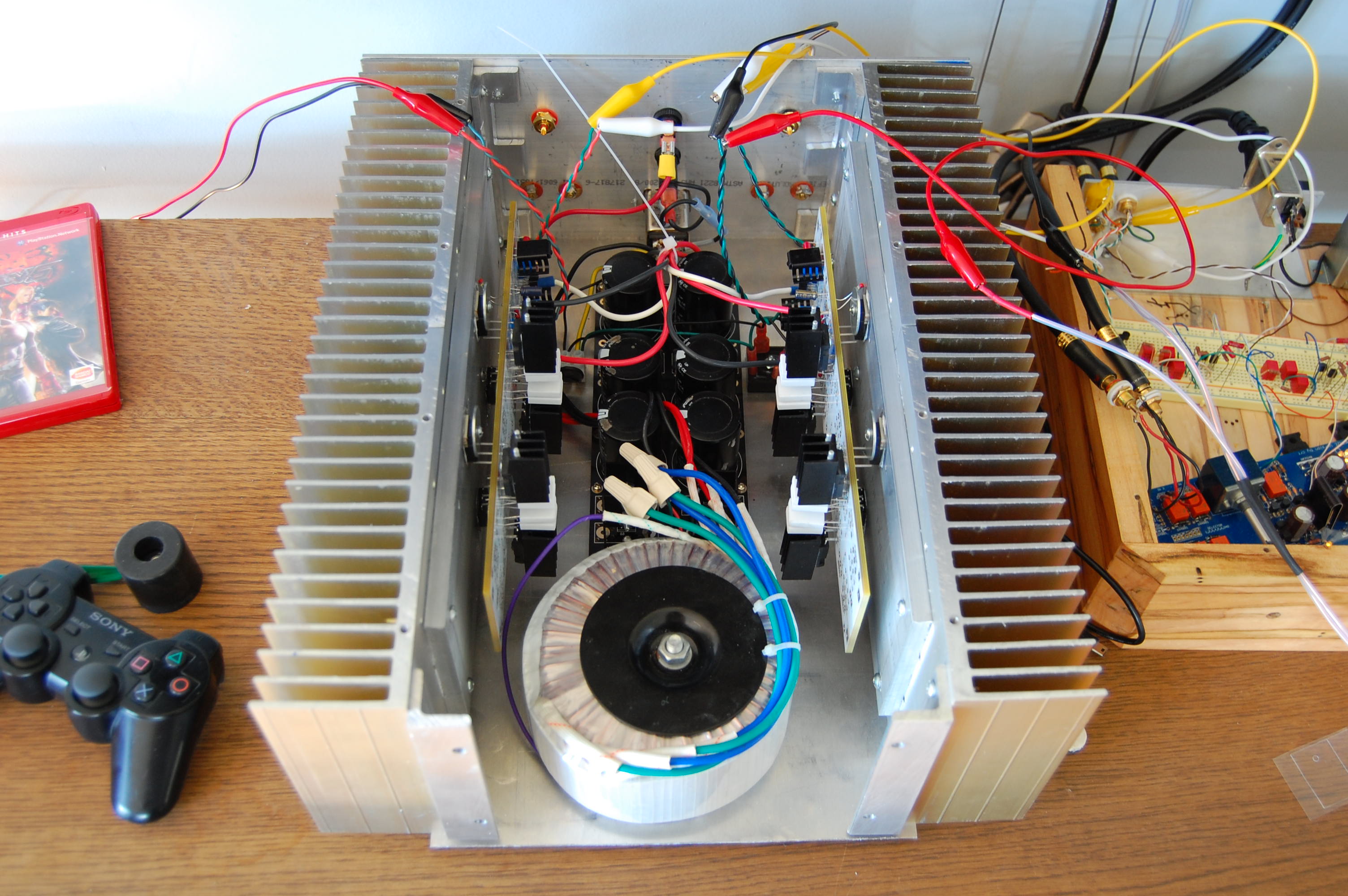

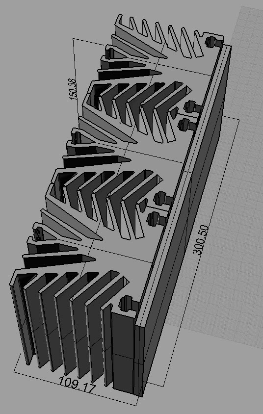

here's mine...shorter box ( 300 mm ) but 11 cm of heatsink depth by 15 cm high
should make a really nice and compact build 🙂
Gama aluminum....... unfortunately a bit far off for you, in Slovakia.

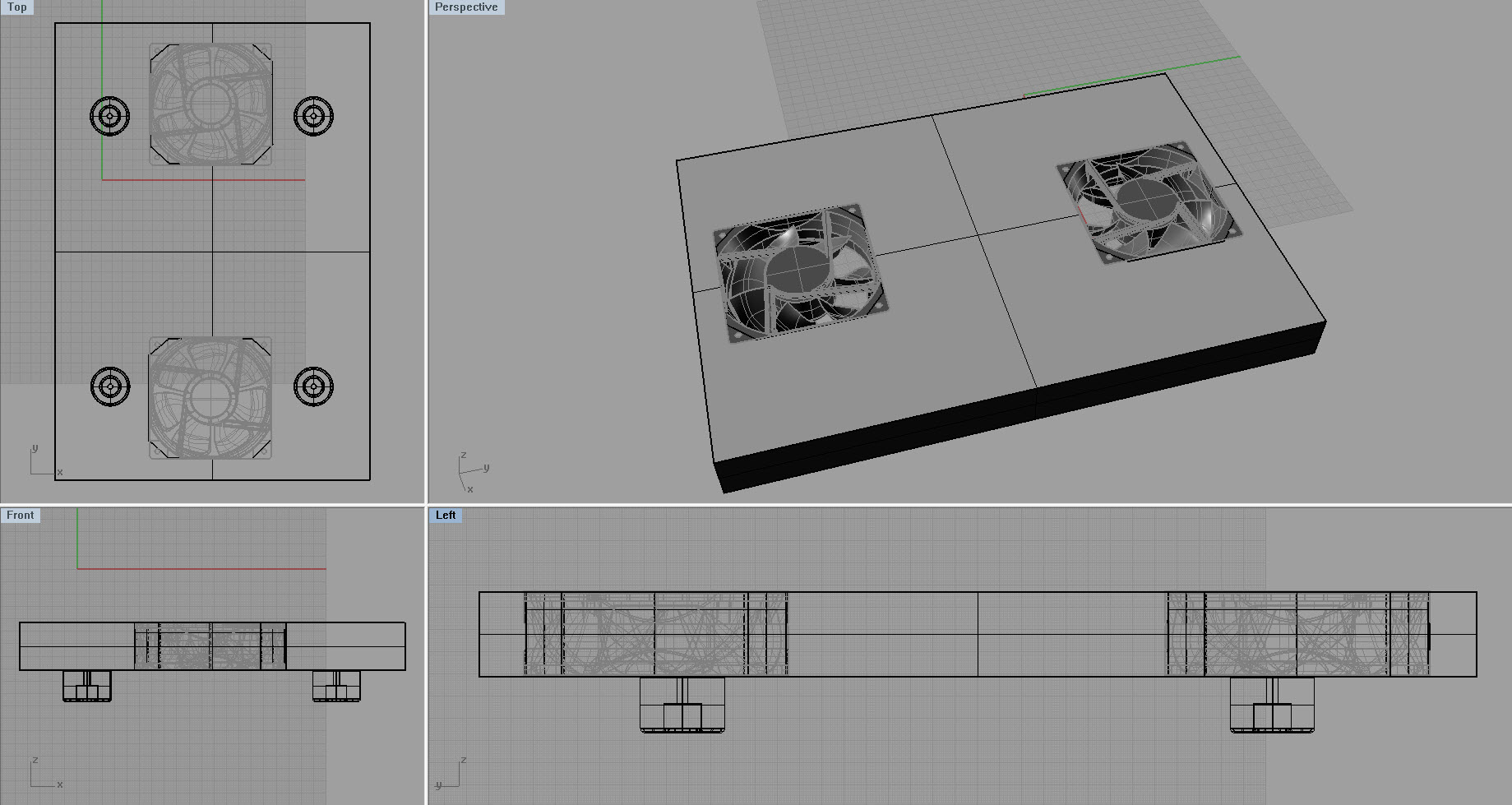

'course if it is too hot i have master ZM's Babysitter:🙂
I run them a little above half rated voltage... extremely silent.
All you really need is to get the air moving a little, makes a huge difference here in Lisbon summer 😀
Absolutely. I built a box with dual 120mm fans pulling across a single 10" x12" heatsink and was able to run 300w. It got hot in the room quickly.
