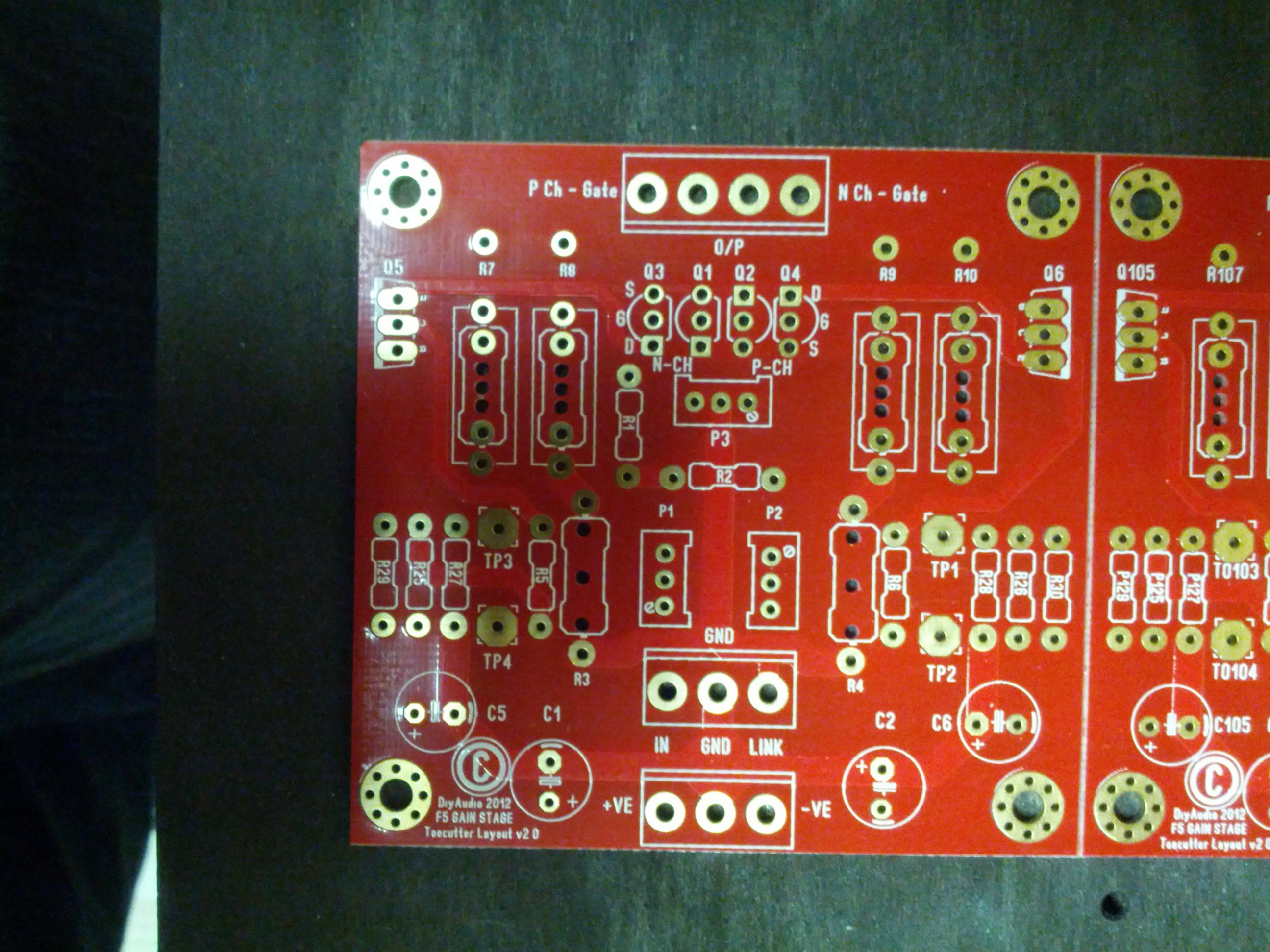

I would suggest following.
Remove BJT and FET. Measure the drop at base of the BJT, R25/27 junction.
Put in the BJT. Put a 10k resistor in place of the JFET and measure the voltage.
Now put the bias pot to middle resistance. I am assuming your power devices are not in circuit at this time. This should not be done with them connected.
Put in the JFETs and take a measurement.
For each of the above, take a measurement at the base node of the BJT, the top of the cascode (BJT collector) and the bottom of the cascode (BJT emitter). Try it with pot at minimum resistance and at middle resistance. You should measure the resistance from rail to the BJT collector, set it to about 200 ohms using the pot. More is not necessary.
Post these three for each of the above. We should be able to guess at a solution then.
Is the polarity of what you measure positive in both cases? We could be seeing a measurement error.
Please report the voltage along with its sign measured at each pin of both jfets referenced to ground. Probing at the unused pad as you describe is good.
Q1 source
Q1 gate
Q1 drain
Repeat.
OK to try and answer Sangram, Bob and Buzz and AndrewT's inquiries. Here is a summary.
AndrewT : no I didn't measure Idss. I don't have a tester
Buzz : yes I'm pretty sure I installed the JFET correctly, unless the board is marked incorrectly Q1 or sk170 on the board is marked from top to bottom SGD so flat would be facing the other flat of Q2(J74) which is marked from top to bottom DGS #3102
With BJT and JFET out I get :
Q5 --> base to collector 40V
Across R27/28 -> 16V
nothing at Q1 and Q2
Just BJT in :
Q1 -> gate to drain 15.87V
-> drain to ground 15.87V
Q2 same as Q1
BJT and Jfet in :
Q1-> drain to ground 0.7V
-> gate to drain 0.7V
-> gate to source 50mV
Q2 -> drain to ground 0.5V
-> gate to drain 0.5V
All these were done with with the P1 and P2 at close to min resistance.
If I remember correctly (I'm not infront of it ) TP3/TP4 tested at 1.8V and TP1/TP2 at 1.3V.
Bob, when I did the measurements I believe I did try testing G and S to ground but it didn't give me any higher reading so I never wrote it down. sorry I can try it tonight.
Sangram when I get back I can turn up the pots and see what happens. would this actually do anything though?
Oh one other perhaps tidbit of info that shouldn't affect the readings but I might as well report just in case. I did change the feedback resistors (R8 and R9) to 200ohms instead of 120ohms I was hoping to get a gain of 27dB instead of only 22dB. However I don't think this would make a difference in the issue here.

dazed,
using this board as a reference, are you sure the k170 are on the left and the j74 are on the right?

I agree that this seems extremely odd. It is unusual to have the VDD disappear when the JFET is inserted and only indicates a fully short circuited device. It is also unusual to have two sets of devices behave in the exact same way.
You have to test all devices out of circuit. This is probably the only way. The BJT seems to be OK as the emitter voltage is fine when open circuit.
As Andrew says, a jfet test is not difficult as it requires minimum components. Maybe you need to run one for all those devices, remember to reverse polarity for the j74.
