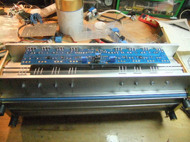

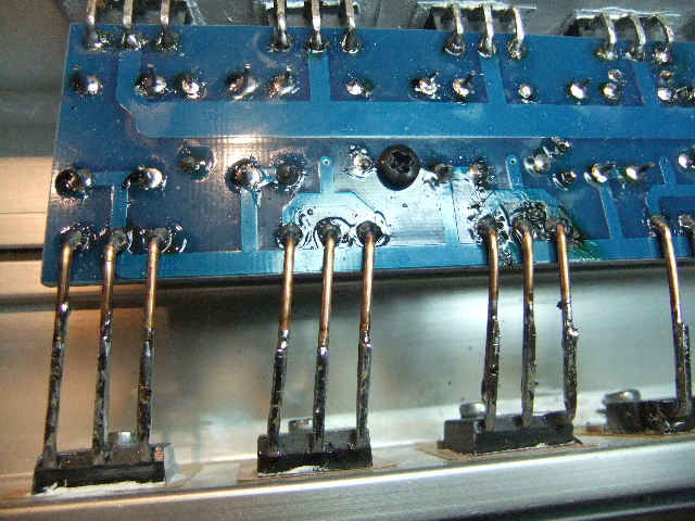

I have previously visited this thread, "F5 turbo is posted", for advice regarding the use of the cooling tunnel to F5 turbo V3. Now the construction of F5T V3 is well under way, and I find it appropriate to move over my questions, experiences and pictures to this thread
In order to utilize the PCB to the cooling tunnel as good possible, I have chosen to use the PCB from Jim's Audio.
All output N-FETs are matched, as well as all P-FETs . JFETs are matched so they have quite similar Idss (and > 8 )
Both channels are tested. On one channel biasmeasurement was similar within a few mV. In the second channel , however there is a difference of approx 35 mV
The question whether this is of any importance have been raised in this thread earlier. The ansewers from serveral members have been quite clear (# 2493.2481 and 2484 ): What I measures are not important, and therefore this will not take away a good nights sleep.
P3 affects offset measurements of the output. However, I chosse to set P3 in the middle position, since I have no ability to do THD spectra measurement/analysis (#2502)

I am building a V3 Turbo with 4prs output devices. 34V transformer secondaries with estimated 45V loaded rails. I think I have enough heatsink to be able to bias at 0.31V across the paralleled 1ohm resistors to give bias current of 0.62A per device to give about 100W rms Class A into 8 ohms.
Looking at the Vishay MUR3020W chart for If vs. Vf it appears that at a Tj of 50C (Mosfet and diode side by side on heatsink at 50C) the diode starts conducting at about 0.42V which across 0.5ohm resistance equates to 0.84A. Does this not mean that in this example the diodes will not conduct until the amp leaves Class A?
This is exact what I am bulding.- I do have one 2x33V AC 660 VA transformer, and will recap another one to be equal.
Using MUR 3020 is for me something "new" in building NP. The last F5 I built did not have this diodes. To be on the safe side and not get in to a runaway the bias should not be higher than 0.31V across the paralleled 1 ohm resistors(like nashbap). I hope to regulate the blow to keep the temprature well under 50 C.
Does this sound reasonable??
I must admit I have not fully understood the benefits of MUR 302. Can anyone explain?

when you crank the volume , current going from amp to speaker goes up
it's passed through source resistors ....... resulting in greater voltage loss across them , when current goes up
diodes are there to conduct when Urs is at/above diode voltage drop/treshold , keeping voltage losses at bay
