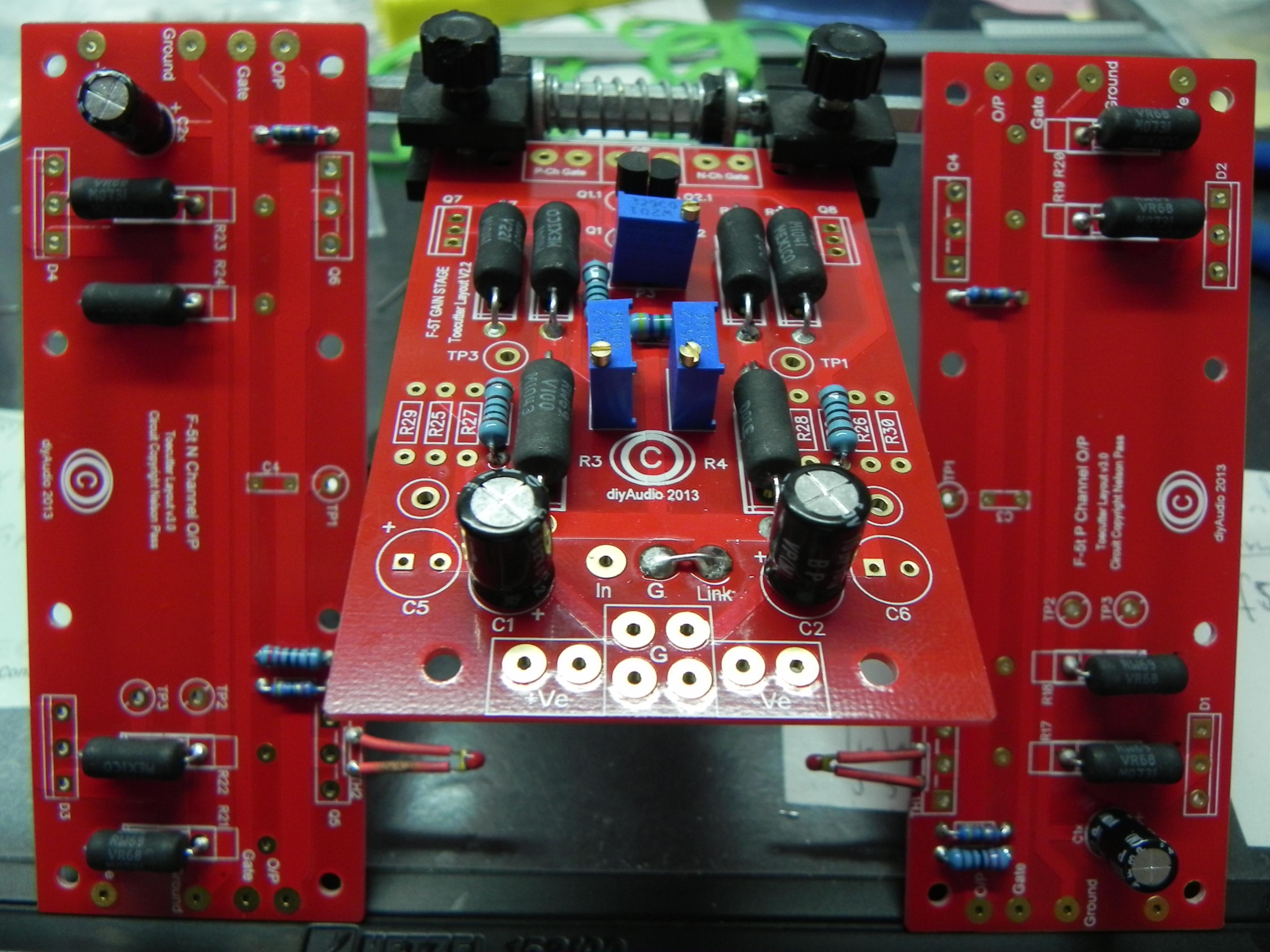

Speaking of F5T cascode - (this is a 2pr v3, or probably better described as a v2 cascode...) Here are some teaser photos. I only have one channel installed in the chassis as of now.
600VA 24+24V with new diyAudio PSU v3 board, (8) 18,000uF caps.
Newest revision PCB, the new front-end will fit on existing holes in the UMS!
Biasing. I have both sets of leads reversed on the red meters, hence the negative values... Lol.
6L6, it's looking very promising.

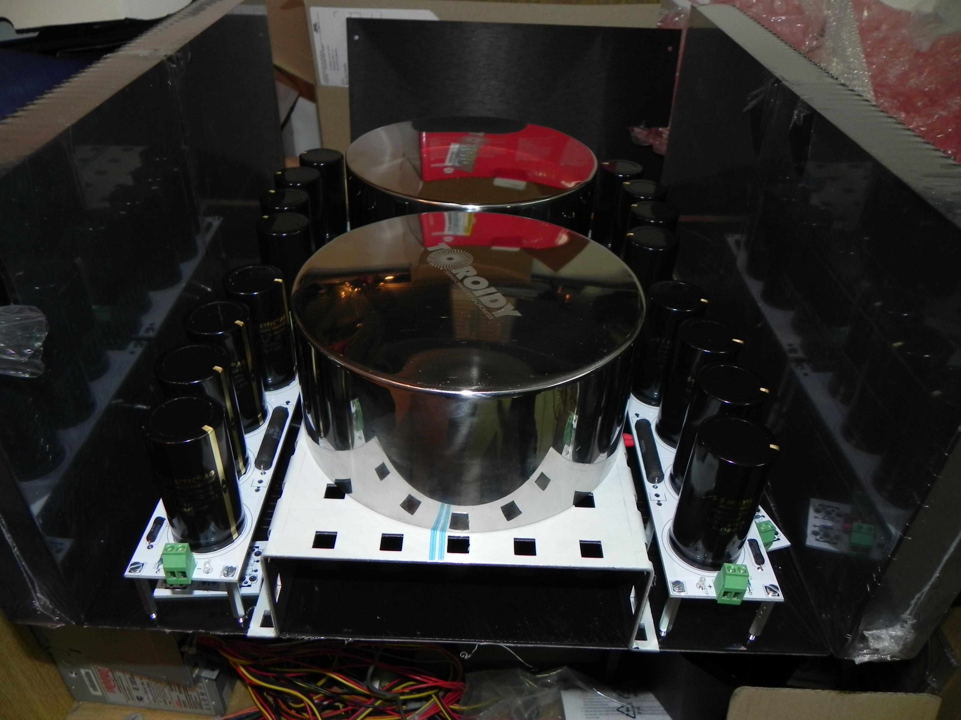

First Results of my F5T V.2 build
After collecting a couple of expensive parts and a few soldering hours I just want to share with you my first results and plans how I want to build my F5T V.2
Of course there is still a lot of work to do: drillings, wiring...
I'm still waiting for all the diodes so I couldn't fire up the PSU for testing.
These big toroidals are so incredibly heavy I have to use a special mounting construction in order to spread the weight smoothly over the biggest possible area.
More to come later on....

6L6 looking nice.

Hi Mallard,
Very nice build... Impressive the 2 toroids! Are so beautiful that it will be a shame to close them in the enclosure.
Keep us update... with more pictures🙂
Ciao
Enrico
