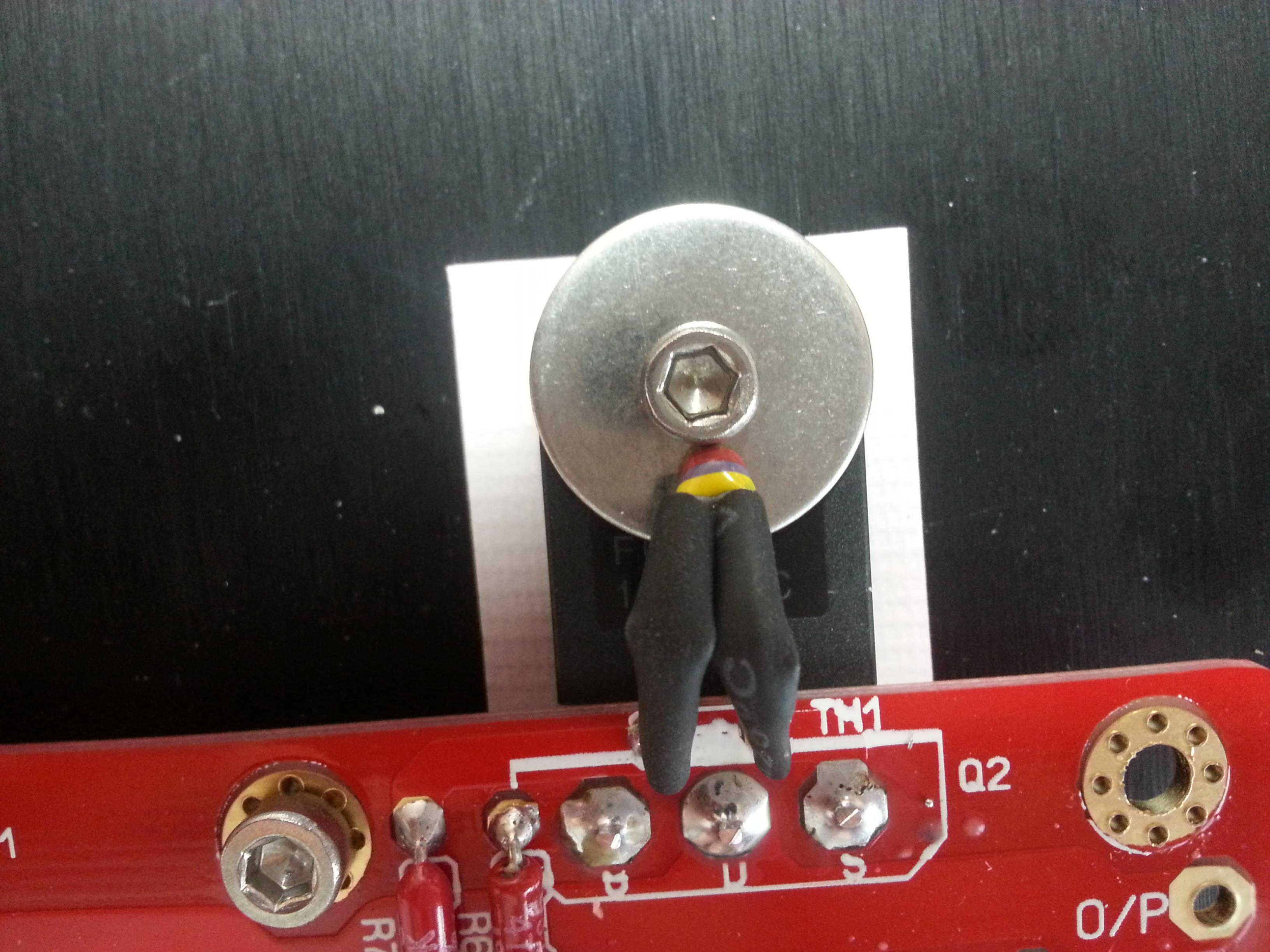

This is my first post on this forum. I've taken on Gabsta's F5T as a project with a view of building my own sometime in the Future.
As posted previously, one half of the amplifier, the right channel is completely fried. That half is now disconnected awaiting parts for a rebuild. I've just been checking the left channel as if its a new build.
I am biasing the N & P channels but I cannot get the voltage between the source resistors to match exactly. By that I mean I cannot get them closer to within 40mV of each other regardless of the DC offset. If I adjust P1 or P2 the voltages rise and fall together.
Is 40mV difference at ~300mV acceptable or is there an issue?
The power supply rails is reading ±32.35V so it doesn't seem to be an issue with the PSU. With the power off and the resistances of the source resistors measured, both reads 0.7ohms.
Any help would be greatly appreciated.

Hi AndrewT,
Thanks for the response. The voltage difference I am sure is accurate. It's still approx 40 mV when measured with a single multimeter.
The output I left open circuit, the input I have shorted to make sure there is no transient input. Unfortunately I do not have a micro ohmmeter so I am unable to measure the exact resistance of the source resistors beyond one decimal place. What I measure minus the lead resistance is 0.5 ohms. The source resistors are Dale 1% 1R. But the voltage difference suggests the variation would have to be a magnitude of 16% which I should be able to pick up even at one decimal place.
As a piece of mind I may rebuild both sides with all the components measured off board as it's difficult to tell if any other part of the circuit is affecting the readings.
Regards
You don't need a micro ohm-meter.
String your low value resistors in series.
Pass a CCS current of ~100mA through the string.
Measure the voltage drop across each resistor.
Keep ONE resistor as a reference. Mark all your other relative to that reference.
Pick two that match. You can get better than 0.2% with care.
Bridge matching gets you even closer.

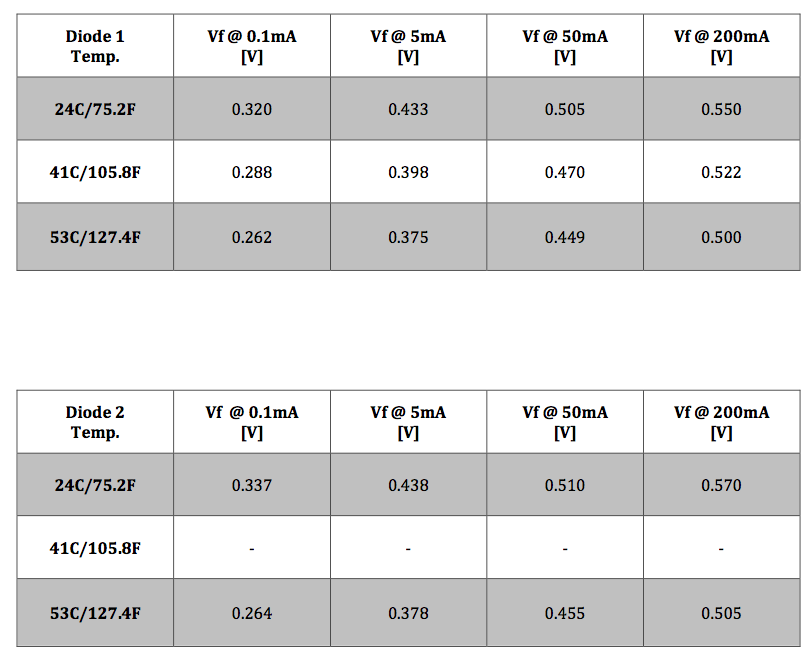

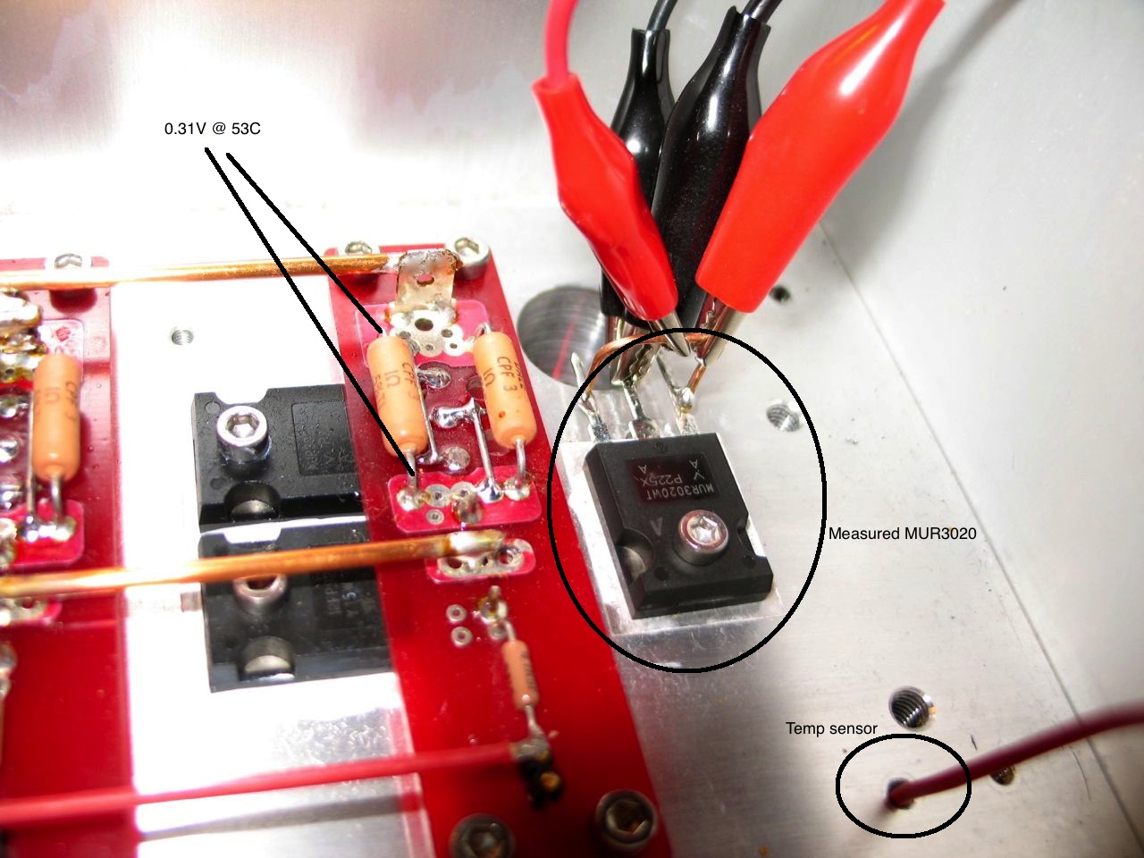

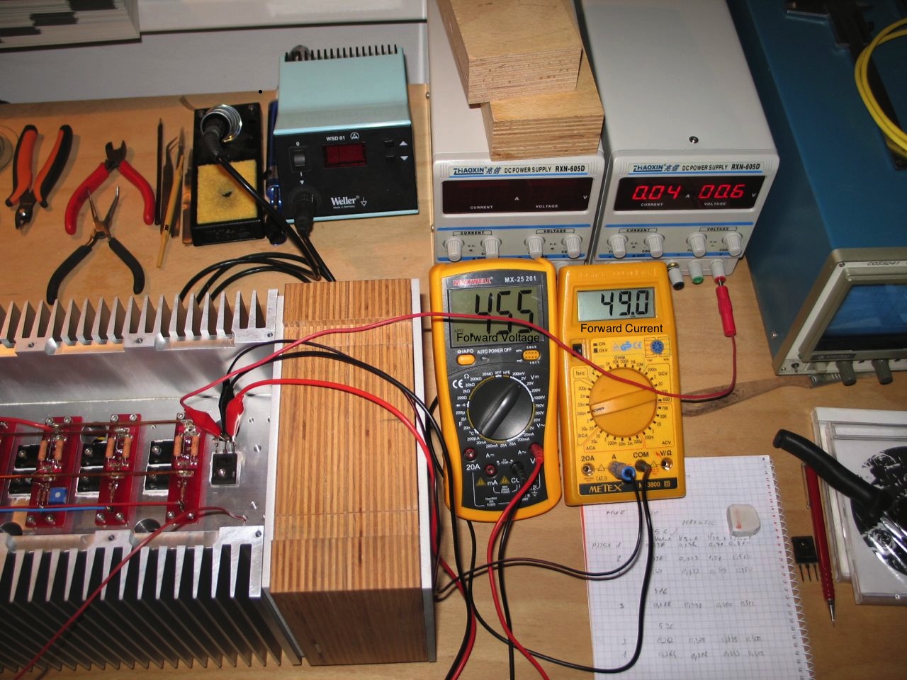

I'm a fraidy-cat, so I measured 3 different MUR3020 diodes.
I wanted to know the forward voltage drop at 53C, which is the operating temp of my own F5V2 at summer.
