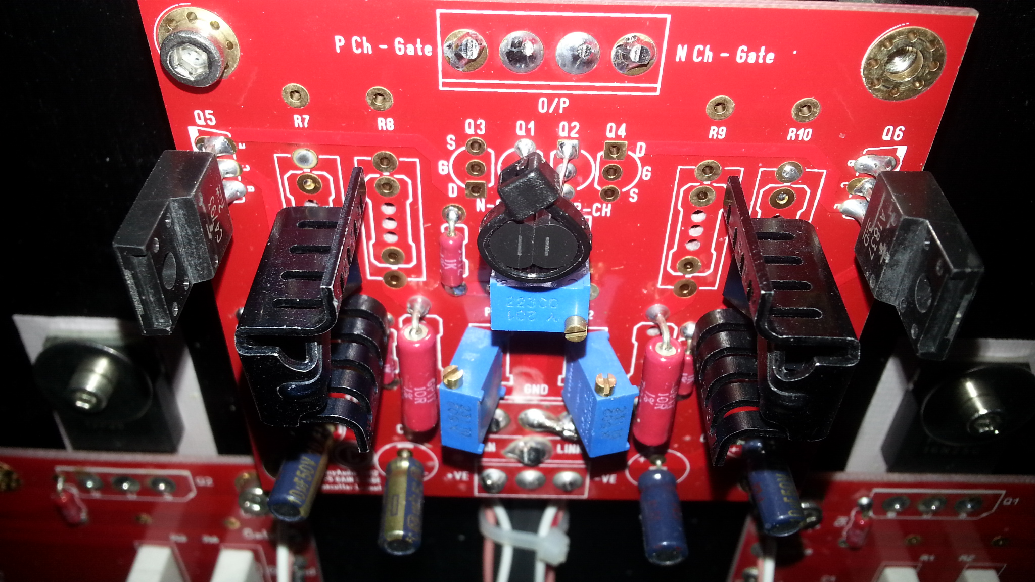

Hi 6L6,
I suggest to revise the P1 and P2 with the 3296X that have the lateral regulation that is more easy to turn during the bias.
I see that also the new PCBs in the Store now have the serigraph with the lateral.
In the photo you can see what I mean. Now I can bias the ampli easier with the enclosure closed.
Enrico
Enrico

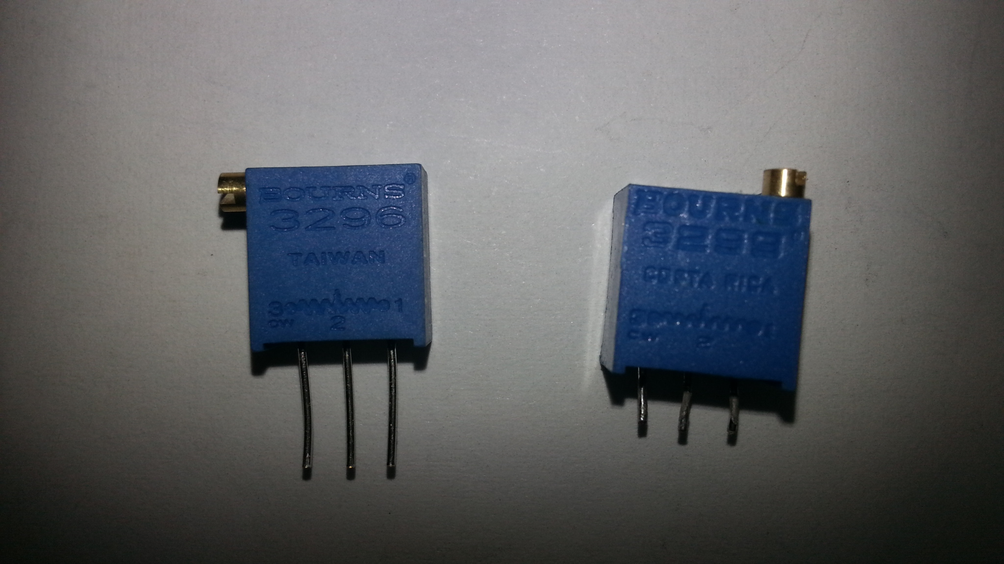

sorry for my bad english... I mean that in the store you can found the photo of the PCBs of the F5T. There you can see that the serigraphy has been modified and now the screw for regulate the trimmer is in the "lateral" side and not in the "top".
I attach a photo to show you what I mean... the 2 trimmers with the "lateral" regolation and the "top" regolation.
Ah, I see.
In actual fact the silkscreen (serigraph) is agnostic of which 3296 variation you choose as the screw is not shown.
It is then left for the individual to choose.
The BOM is only a guideline
Offcourse... was just a suggestion because I realize only at the end that is very difficult to bias the ampli with the encloser close and the screw on top and I loose a lot of time to found the ones lateral. I have also to desolder the old one etc.
Maybe is good for everybody to know about.
Enrico
Enrico
