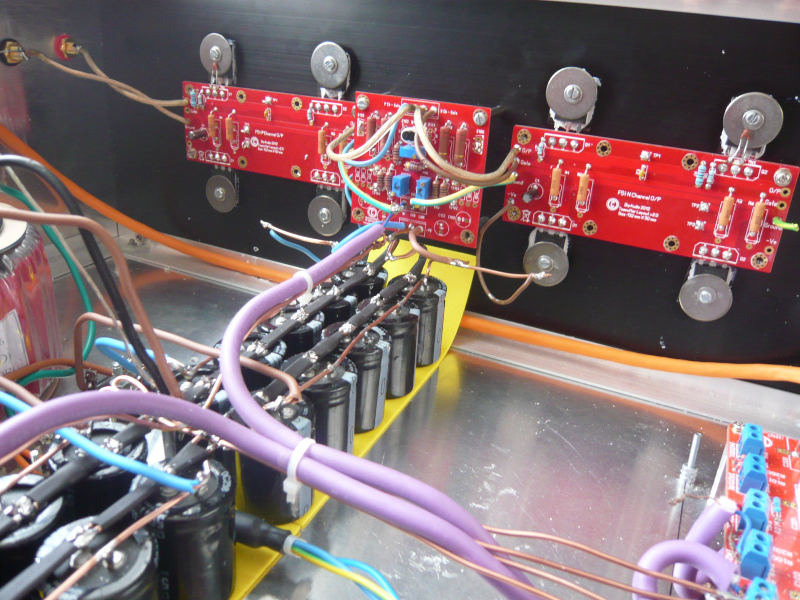

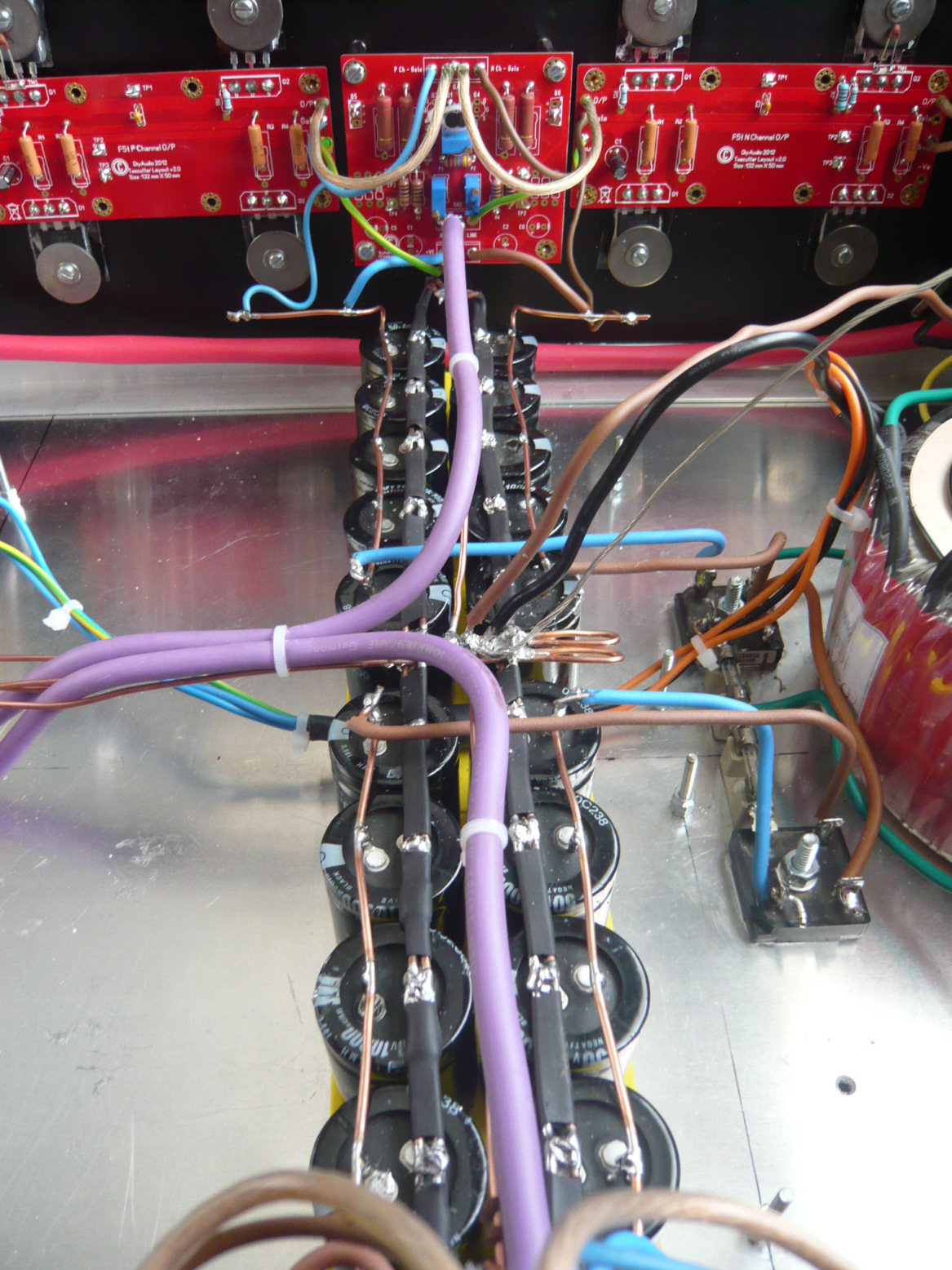

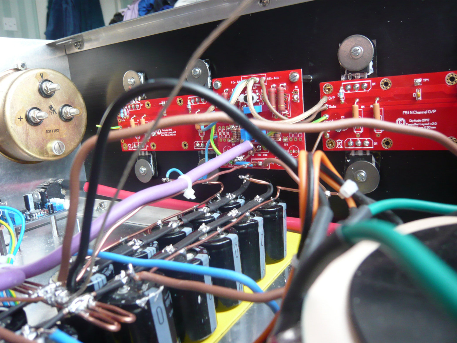

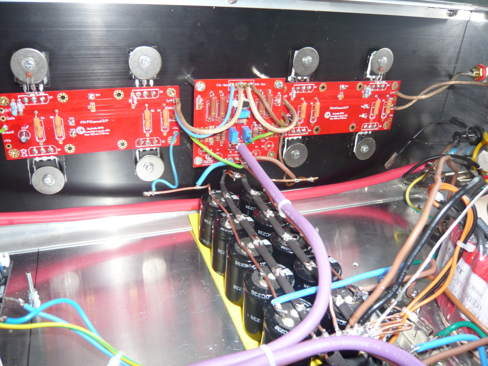

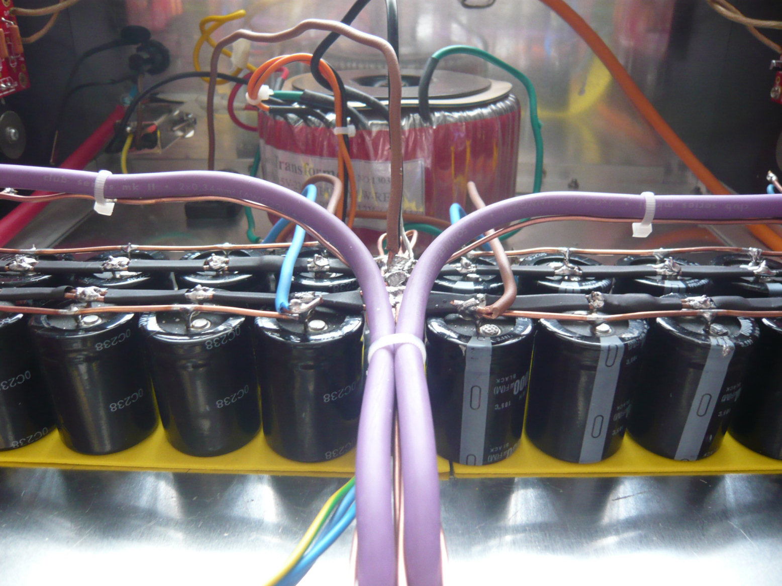

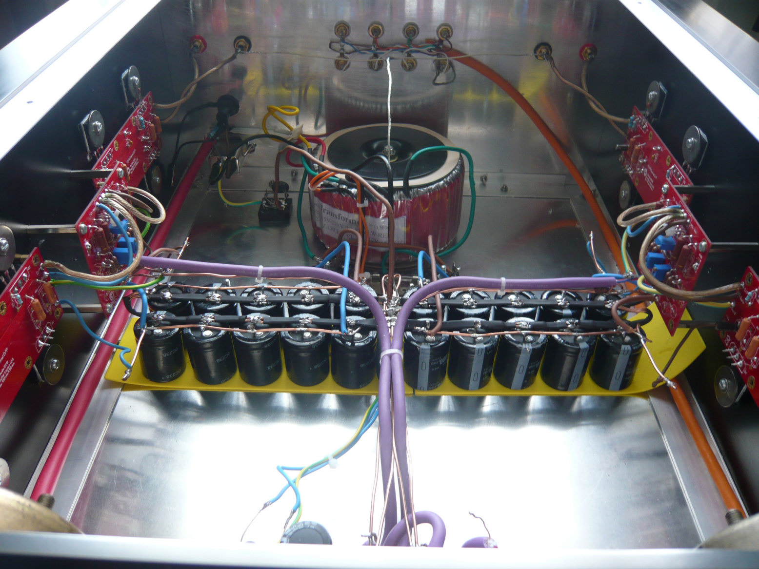

here how we begin to wire up the 4th version of the power supply when the other 3 were causing issues.
Point-to-point and Thick wire all the way, getting there and a little bit more to do then wire up then test then hopefully nice clean PSU.

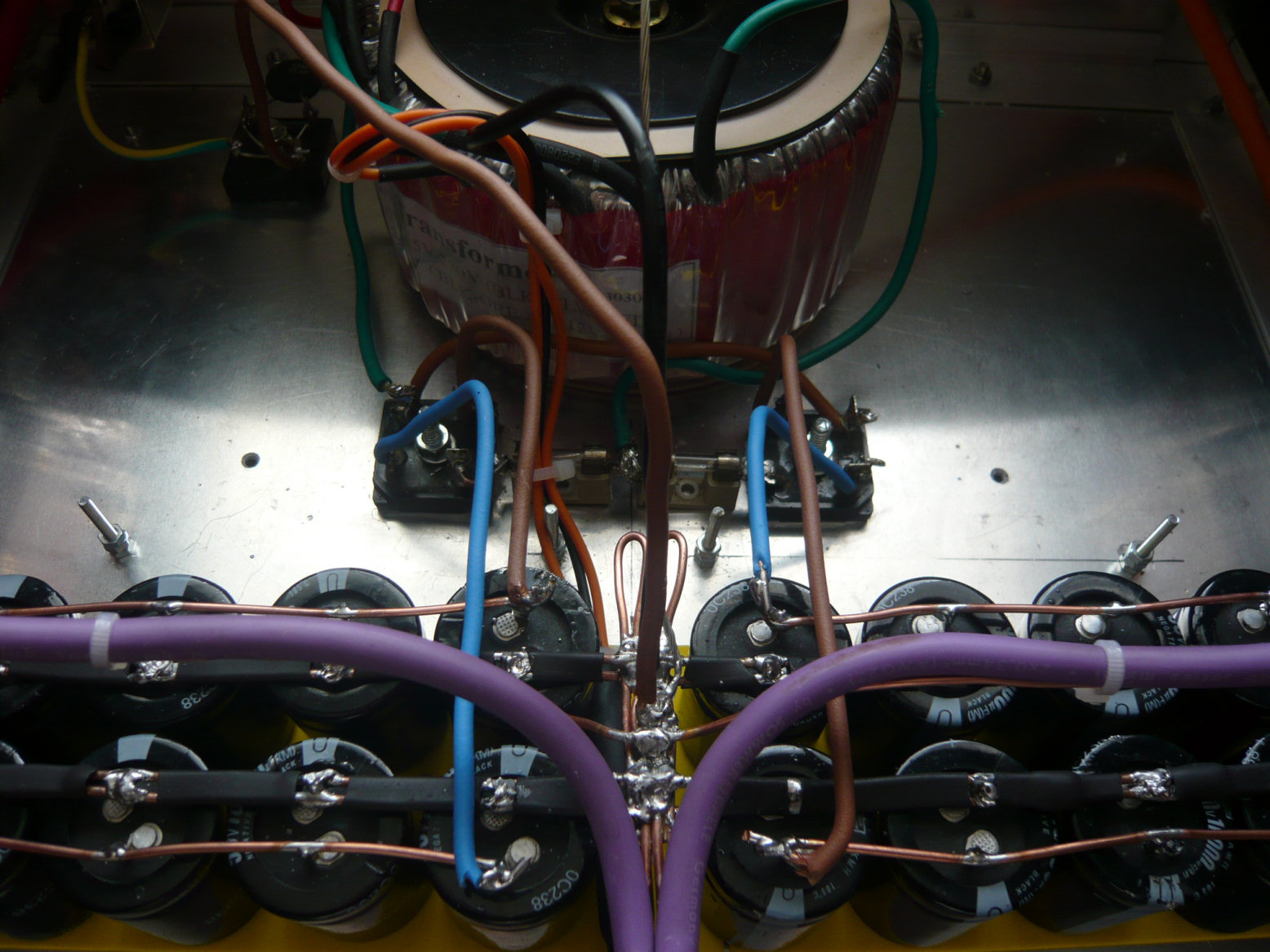

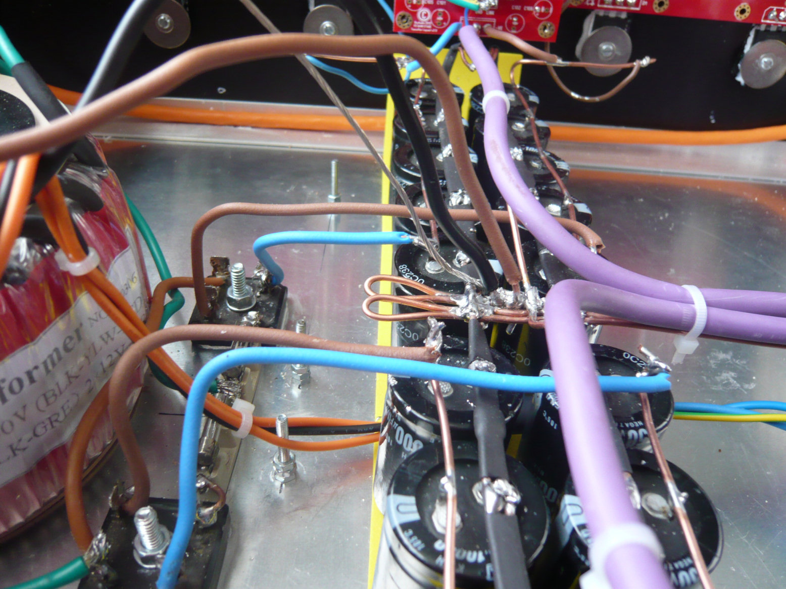

I looks like you are going to attach the power ground to each channel at the end of capacitor run. That will not get you the single point or star ground you need to eliminate hum.
All the grounds should come to one point in the center of the capacitor bank, not at the ends. I would bridge a heavy wire between the runs in the middle and tie all the channel grounds (power and speaker) at that one point. It only takes a few inches of wire separation to induce hum.

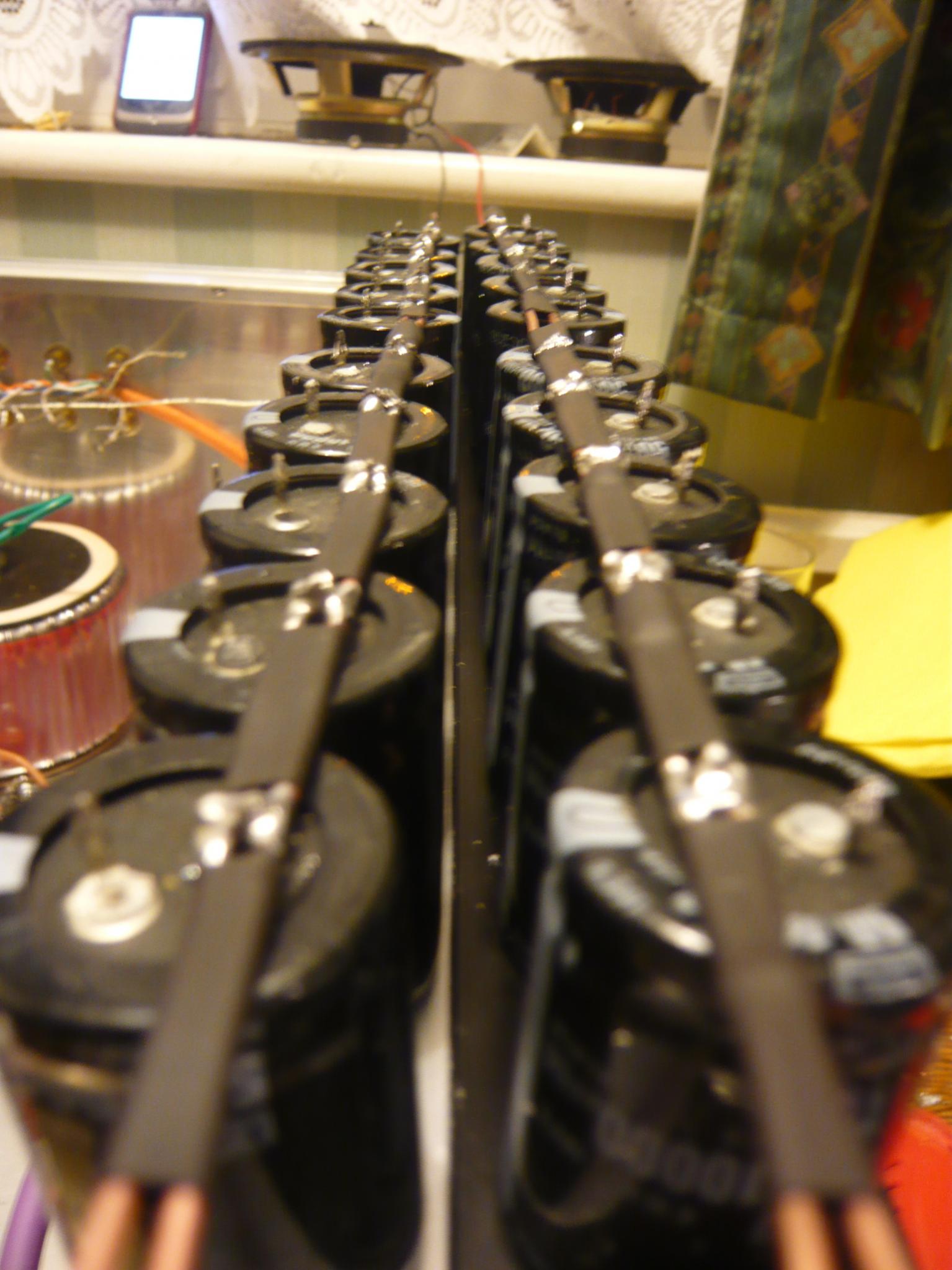

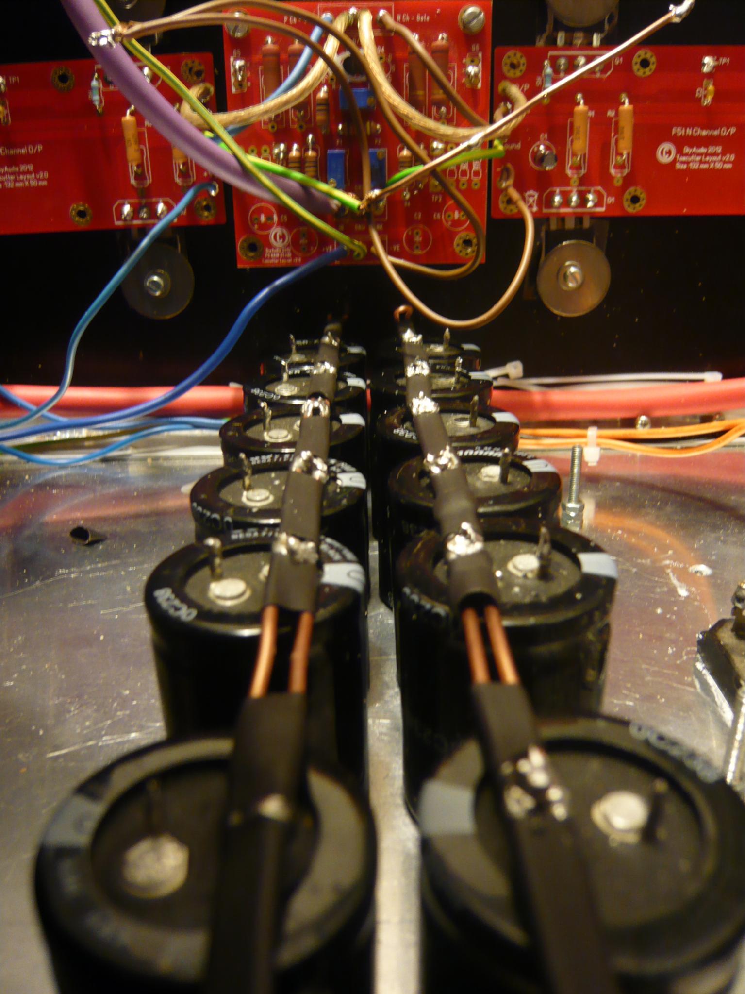

Why are you doubling up the hard-wiring of the smoothing caps?
Bring the rectifier in at one end. Take the power out at the other end.

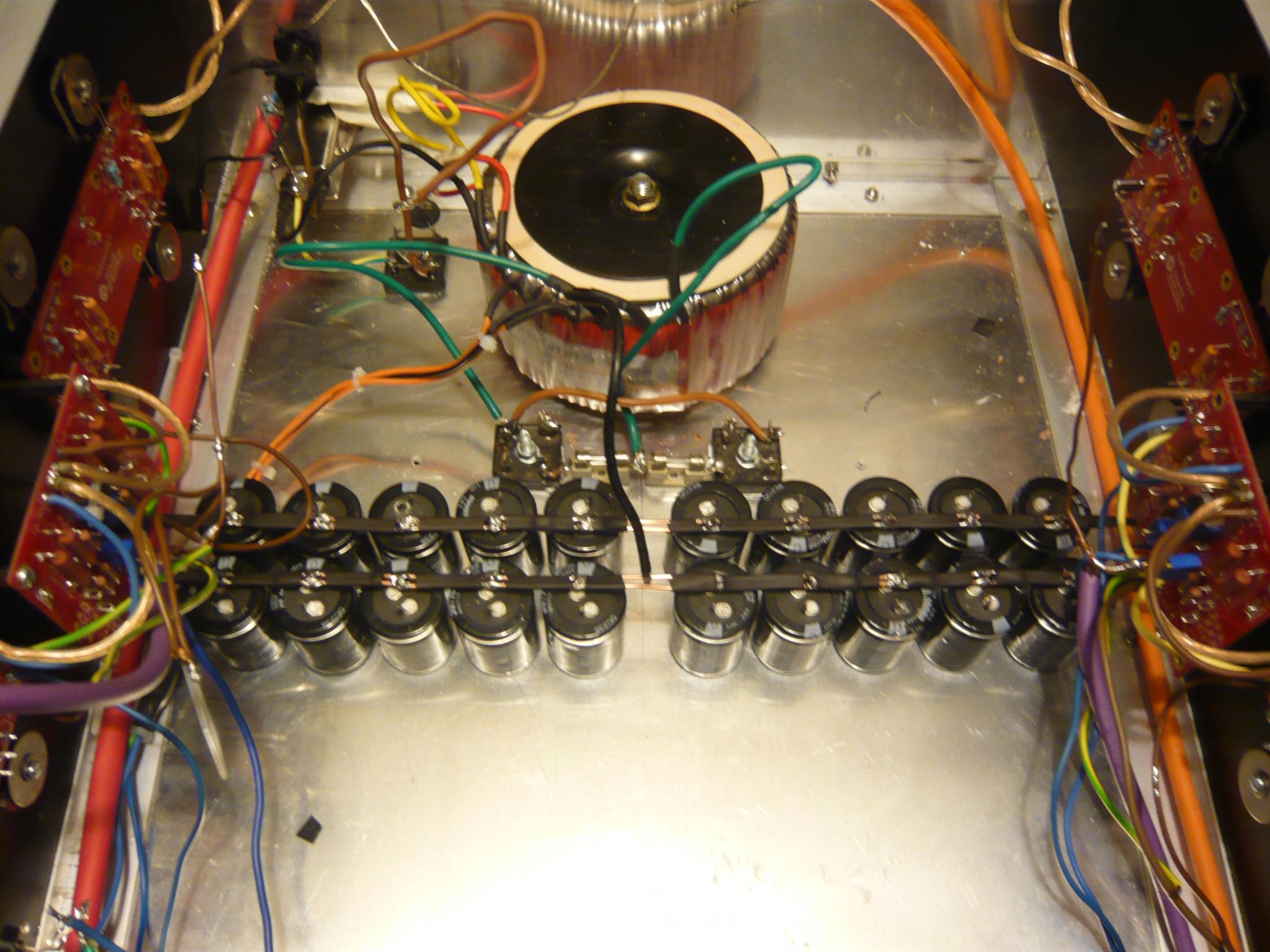

My grounding layout in the PSU was a problem
"I would bridge a heavy wire between the runs in the middle and tie all the channel grounds"
thanks was the original Idea 🙂
Well im not going to avoid my embarrassment, blew up one channel today after rewiring with better wire and taking the ground from the center point rather than from the end of the capacitor bank, which of course seems the right thing to do, so somewhere i made an error!
