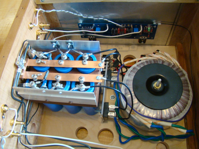

here is a picture of my f5 power supply...couldn't get much simpler. I have done the same type with proto board and snap in caps.
Thats pretty good, maybee I should do that! I also have 2x Rectifiers laying around like them. The diodes im using at the moment are getting a bit hot, can't actually remember now the difference between the normal rectifiers and the MUR ? diodes.
Whats between your caps ?
Hmm u got me thinking now.
.1r caddock mp930 resistors. could be others, but these were convenient.
copper bar could be on hand copper wire.

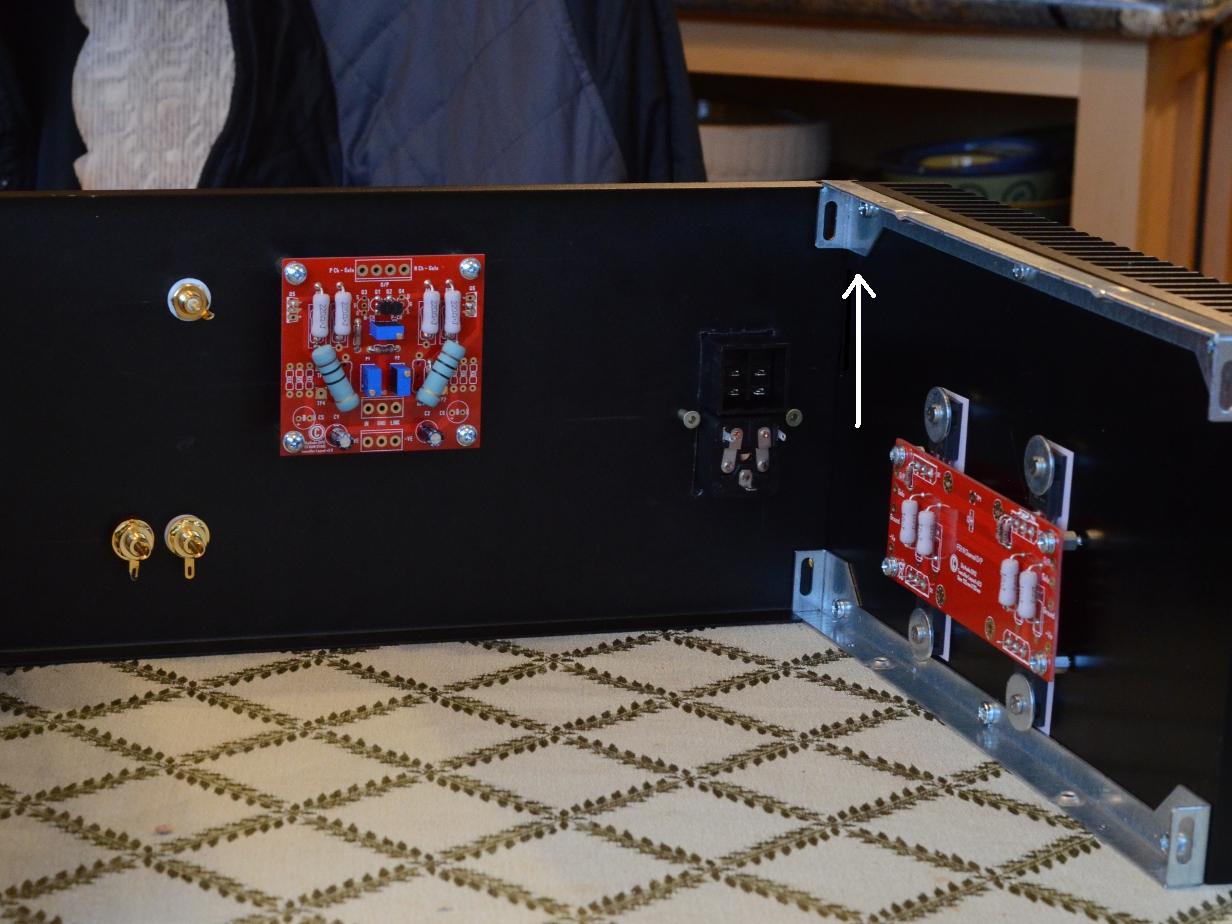

Where buy these brackets?
Congratulation for your nice work!
If it is posible i want to know where buy theese brackets

Hi dear .Finished wiring up a V2 monoblock last night. I am in the process of powering up the first time right now. I'm kinda guessing that P3 gets set near the middle of its range.
Anyhow, here are some photos. New UKToecutter boards, diyA chassis.
The plan is to get it up and running (biased) by tonight.
I'll post more details a bit later when I've got a spare moment and the amp's done.
-Nelson

Those brackets come with the chassis' available from diyAudio Store.
We're getting in another batch of chassis in a month. ( i know, some may be skeptical) I believe that chassis is the 4U model. The brackets aren't available in the store but HiFi 2000 in Italy might sell them separately
