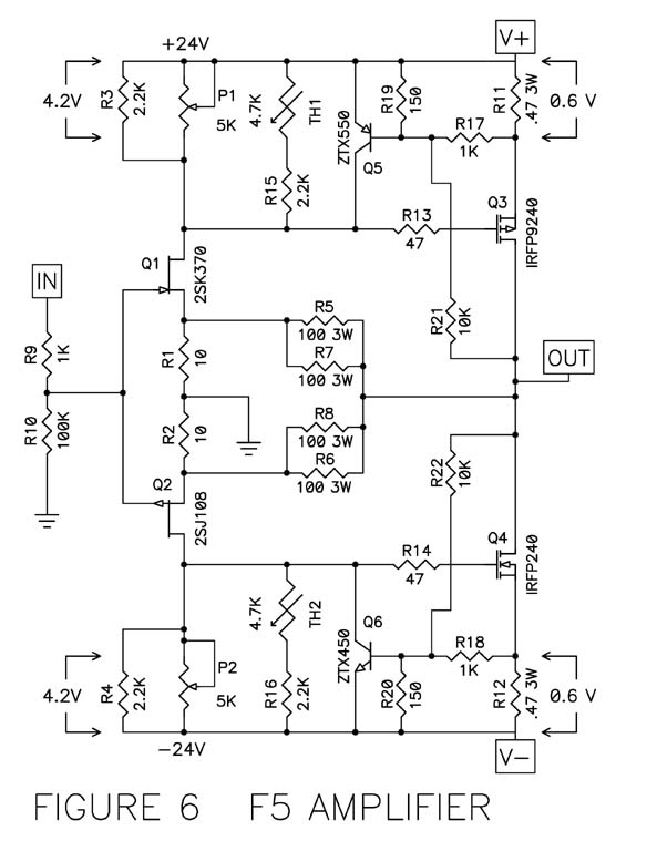

On the good channel R5 R6 R7 and R8 all have about 18-20R across them
On the bad channel R5 and R7 have zero R and R6 and R8 have 18-20R across them....

Could you post the schematic that you are using?
Ok, then remove (or lift one end) and check R5 and R7 for value.
Also check for ohms R1, R2 and the outputs Q3, Q4 while R5/R7 are disconnected.
just lifted one end of R5 and R7.....R5 is a .13R resistor...supposed to be 100R...R7 correct at 100R....

Was your R5 marked as a 100R and wasn't? If so, it was damaged along with the R1,
probably due to high DC output voltage. Check that the DC offset voltage is small.
Or was R5 actually the wrong value part? I always first measure each part that I install on a board.

No I installed an incorrect R value for R5... .13E blue ohmite looks just like 100R blue ohmite..until you read the fine print. That explains why this channel has never worked...I hope.
Wrongly binned parts happen, always measure first. There's no way the amp could have worked with 0.13R in there.
Be sure to replace R1 also. The R7 will be fine, since it was protected by a short across it.

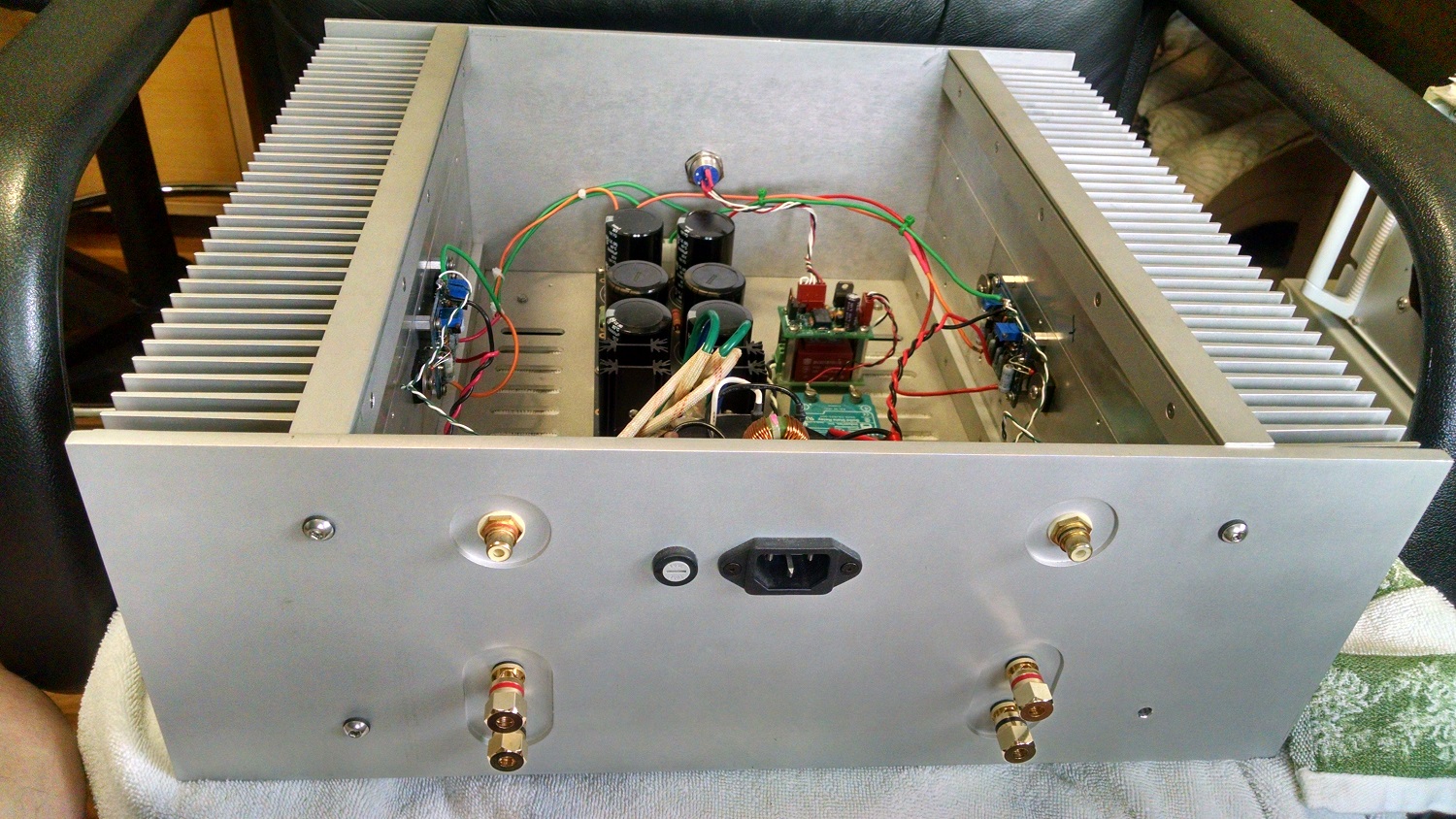

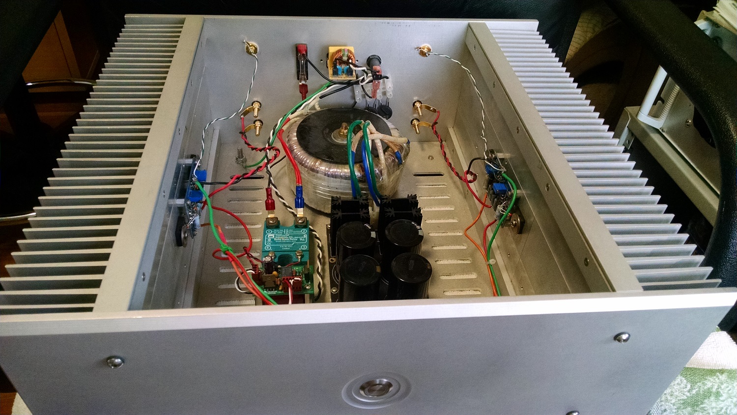

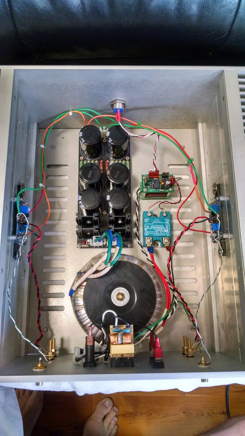

Here are some pics....the little stacked PCB assembly and SSR are to support use of a Fancy Bulgin momentary switch. This chassis was used for years as an F4 without issues..
The simplest first thing to try is to disconnect the long input RCA wiring, and add an input short
right on the audio boards. If the hum goes away, there is 60Hz hum pickup from the transformer,
which is right in the middle of all the wiring.
