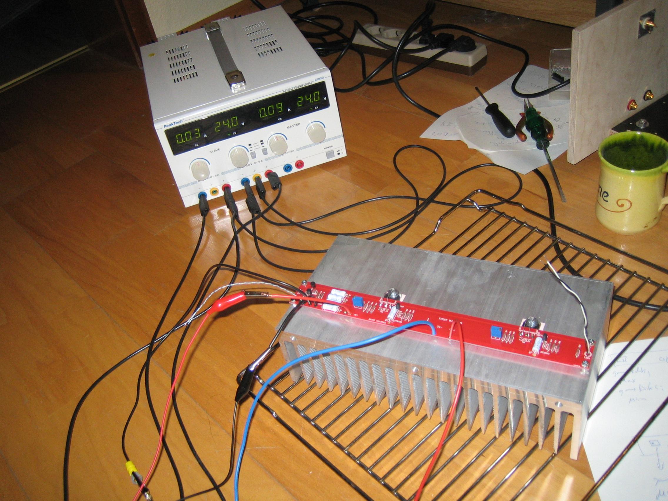

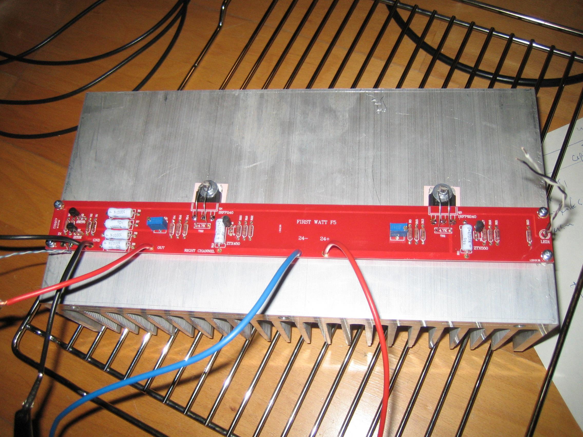

I built F5 with 2sk170, 2sj74, Fairchild mosfets.
I used Jims audio board, firstwatt look clones (nice spanned transistors...)
My problem: I was able to bias one channel, run it at 1,3 A, I shut down the power supply. Then I repowered (after 1h), and bias shot up. Luckily limited by the lab suply. Now I can't readjust bias, it shoots up on one polarity. First I set to zero bias, then I was able to bias around 0,4 A, then I cant really do any senseful adjustment...
What is a possible problem? Jfets get quite hot, I really have no idea.
With the other channel, I was in the adjustment process:
All was fine, I touched the input cable, suddenly lab supply shut down voltage(due to current limiter), Pmosfet: G=2V D=10V S=10V, Nmosfet: G-25V D=10V, S=-25V
Sj: D=-25V, G=1,9V, S=1,6V,
Sk: D=2V, G=1,9V, S=1,7V
I could not trim down the voltage, I decided, the sk was dead. removing the sk brought down the bias to zero.

I put the pots to minimum. Current reading was: 30mA neg, 90mA pos.
then 50mA neg, 100mA pos. JFests hot, shut down.
Restart: neg, 10mA, pos 70mA, now stable.

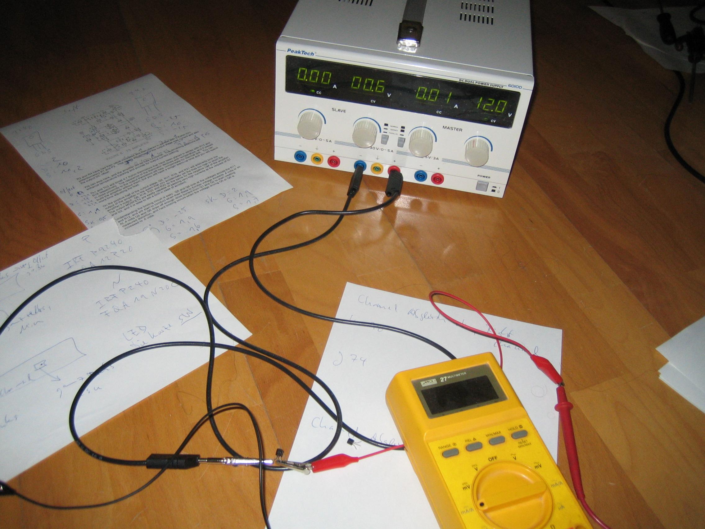

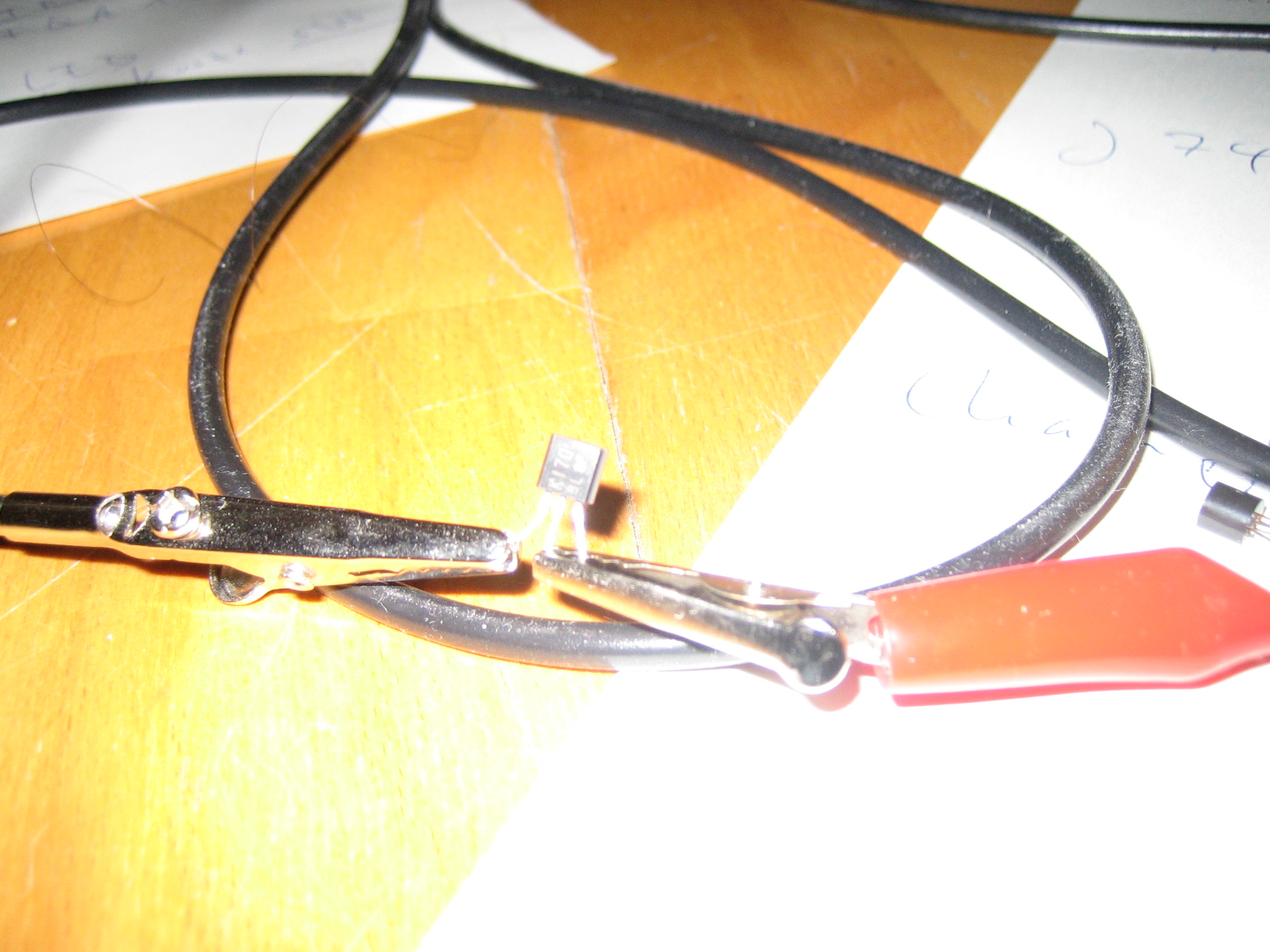

I measured the jfets of the temporarily working chanel.
exemplare k170:
Lab supply 12V, source gate connected, drain +, g-s -, in between fluke in mA setting.
I measure zero current flowing.
So I fried the jfets.

Idss - considering prescribed BL group , that means everything from 6 to 12mA will do the job

- resolder 3 "not so hot" solder point
- replace 2sj74/2sk170 fets
- put 220uf electrolytics in the powerlines (I use a regulated lab supply)
- clean powerfets and cooler with isopropanol, new kapton isolators
- shortcut input with alu foil and clip
I then limited lap supply current to 2A and started.
Result: No problem adjusting the idle current. Everything as it should.
