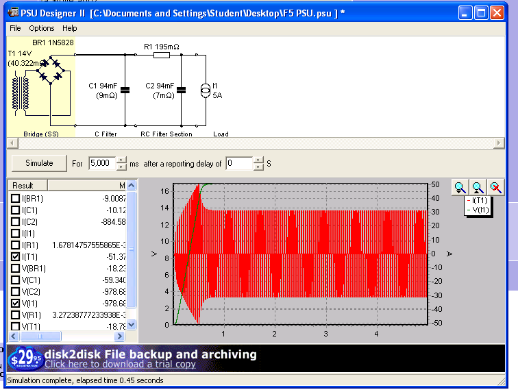

ashaw said:Would the following PSU be okay for The balanced F5 posted by Patrik a while ago?
I was thinking 4 Jenson 47000uF caps per rail per channel, could i get away with less?
Look at SM, it can't be much simpler. I have 2x22.000uF followed by 2x 25W R22 and 4x 33.000uF per channel. Across the 22.000 caps additional 1u/250V and the 2k2 5W resistor as well. Hope the simulation is just for one of two required rails per channel.

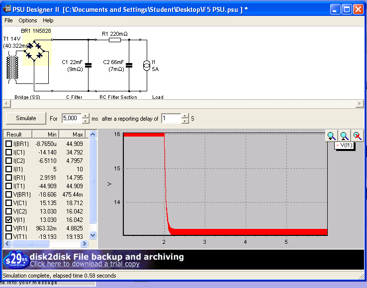

ashaw said:SM? so like this - per rail?
(note steped load 5 than 10A)
Something like that. 18VAC before the bridge but twice, meaning 18-0-18VAC to get rectified 24VDC per rail, plus and minus 24VDC measured from the center tap. SM is service manual downloadable from passdiy site ...
There's a full schematic drawing of the suggested PSU, but really not critical. Across each 22.000uF goes one 2k2 5W (can go with less power but I had these at hand)
I have a single 500VA transformer (toroid) with four 18VAC secondaries. Go back a few posts and pages and check it out. Very simple, very stable, completely silent... I suggest you get one NTC TH with around 6-10 Ohms for the primary that will act as a soft start and two more to ground the signal's ground. But it's all in the manual...

Ok, then, sorry for talking about higher rail voltages. Still, adding the drain resistor across the first pair of caps and being wise about the grounding plus adding the thermistor in the primary remains a valid recommendation. I guess you have the service manual at hand and that you have checked how it was done.
Patrick's balanced Cct uses just 4 amps per channel (2A per side).
Suggest smaller caps in R-C-R-C configuration if using Jensens - not the usual setup but very effective - 1st cap (ripple) = 10,000 (maybe 22) and 2nd cap (power)= 22,000 (maybe those 47s) and R = 0.1R - 0.12R.

My balanced version has +/-16V rails and 4A per channel total bias. More the transistors won't take.
Leaving at least 4V Vds for the MOSFETs, I get max swing 24V (as it is balanced output) and 4A. This is set to peak for 6 ohm speakers, giving 48W (rms) assuming sine wave.
For 4 ohm, it will be 32W (current limiting) and for 8 ohm, 36W (voltage limiting).
No idea how you come to 10W.
Patrick
