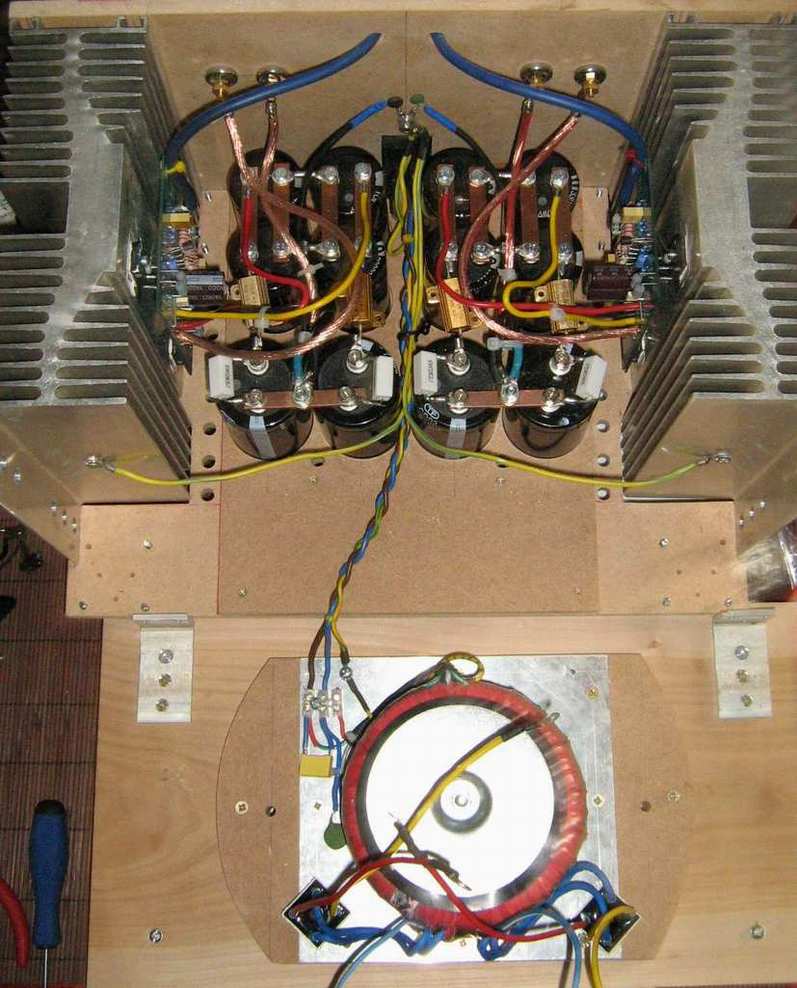

F5 power amplifier
and one more showing the wiring layout, before closing the box

Re: Re: another diy f5 newbie layout
estman said:
Sure F5 works, just take care to connect everything right way 😉
I can confirm that. It surely works, and for that matter, works good. (event though saying "good" doesn't give it a credit that it deserves)
Once your PCBs are populated, box prepared be sure you do the wiring the proper way. The image I posted (http://www.diyaudio.com/forums/attachment.php?s=&postid=1612093&stamp=1221668297) shows some of it, and take care you don't ground the 0 potential directly but through the TH (I used a 8R NTC, one for each supply/channel)
On the image these thermistors are at the center of the rear panel. The heatsinks are grounded directly.
