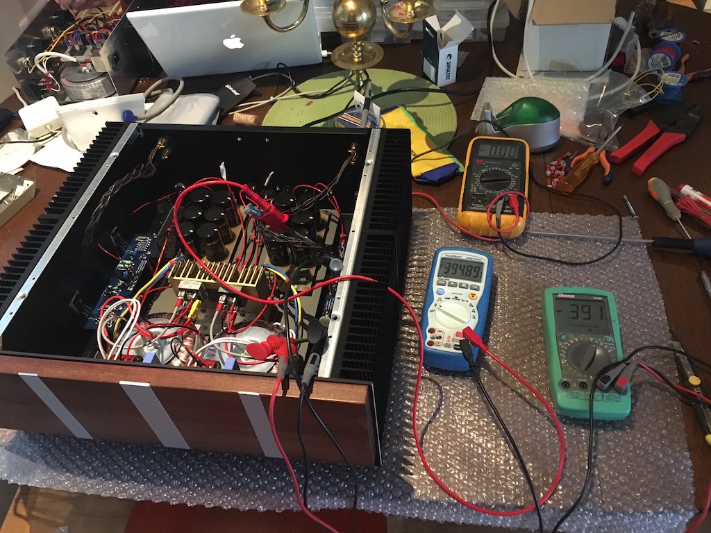

Ah.
Assuming you have -
0.6v (or close) measured across R6 R7 (meaning the bias is full on both sides of the circuit)
and close to zero DC offset at the speaker terminals
a difference in bias of 20mV (0.02v) across 0.47ohm is approximately 43mA and absolutely nothing to worry about. 😀
If it were my amplifier I'd say that's very close to perfect, pour a glass of wine and enjoy the music as I dream about the next project to build.
I have built F5 with significantly more difference between the two sides than what you have and it worked and sounded beautifully.

I have 0.47v one side & 0.50 on the other at R8 or R7, I took the 2 measurements on each side left/right.
The offset at the speaker terminals fluctuate -0.0002 ~ +0.0002.
So you confirm it is good, lovely, I am very happy.

as long you have one side good for Iq and practically 0 offset at output , who cares for other side Iq value , except to confirm that you didn't put wrong resistors in source 🙂

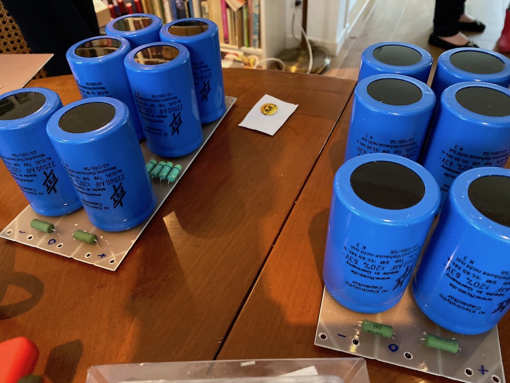

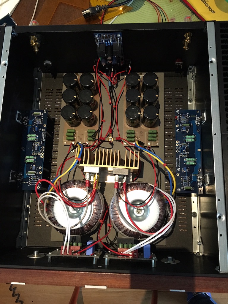

I've built my F5 3 years ago and love it! But I have 2 questions 😉
But I want to make 1 big change and that is add more capacitance to the amp. Currently there are 2 Amplimo 225VA toroidal transformers that feed 2x60.000uF Mundorf caps. But from reading some other posts, that might not be enough capacitance, and I hear a very slight hum (50hz) when my ear is buried in my speaker.
So I got 12 new 22.000uF caps in total, 2x132.000uf for my F5, which might be a bit too much, but, hey why not...
1. Am I correct that 60.000uF is not enough capacitance for a 225VA transformer, and therefore I might hear some hum?
2. Or, as I have also a Pass Pearl 2 phono amp, are the LED's on the cvilier v3 boards not meant to be on long leads and function as pretty lights on the front panel? (so the LED's should be as close as possible on the boards)
thx!
And also I added 2 images, 1 a bit old, of the internals of the amp, 1 of the new F+T 22.000uF caps on new boards
