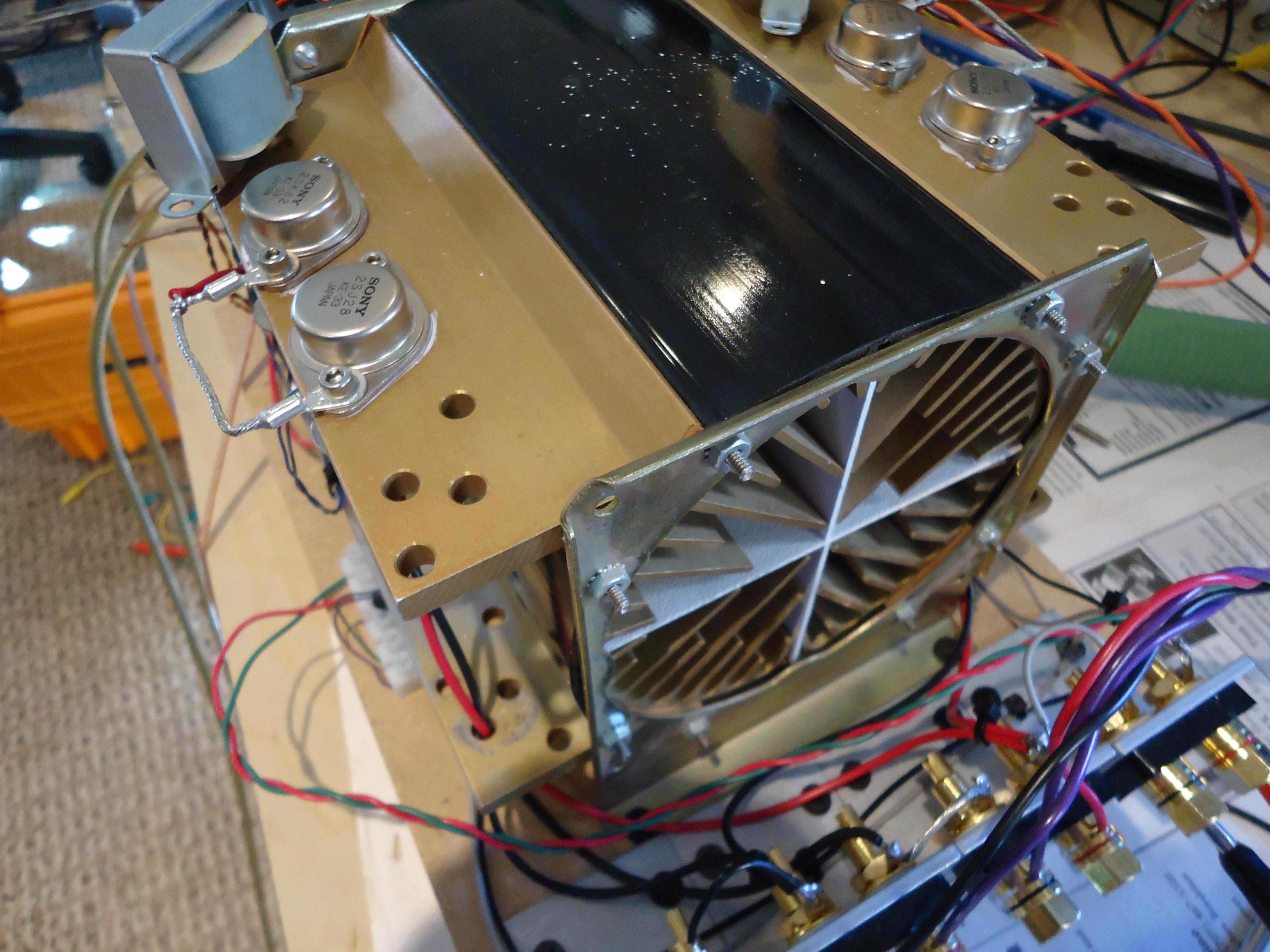

Happiness is an F5 running decent bias with good temps. Last week I dug into the thing again to replace some heatsink compound with some better silver stuff. In the process I discovered a reliable way of splitting mica insulators in half with a pair of tweezers. Solidly running 1.3 amp of bias now, I can get a good 10 seconds of skin contact on the MOSFET cases. I might try for a tad more and call it as good as possible. I'm surprised how much of a difference splitting those things with better compound made. Thanks for all the help and kindness!
