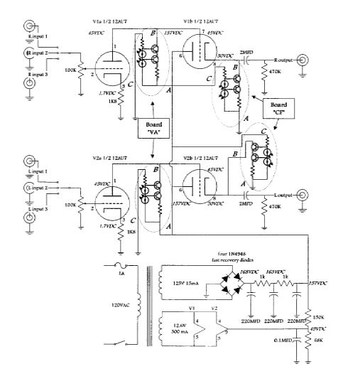

On to the subject of the cause of the failure - here's the schematic of the preamp. The preamp hadn't been powered on for more than a few seconds when I powered up the F5. The oscillation started immediately and the gate resistor smoked in a few seconds.
Anything here that would be of concern? It's a sweet sounding pre that mates well with the F5 but I probably not going to chance it again.

even if schematic is pretty much unreadable , it isn't crucial to analyze it - pretty often physical execution is of same importance as schematic itself
however - important tip - when you see tube schematic with nothing else than pot connected to grid (no grid resistor to gnd!!) , just skip it and leave it for suckers
I'm not positive about the 'mates well with the F5' comment, seeing as how it turned out.
I also don't much trust tube circuits that directly couple the two tubes. It looks like a pretty standard two-stage pre from the 40s with CCS loads on each tube. Nothing particularly special, or safe.
At the very minimum consider using back to back zeners to clamp the signal across the input of the F5, about 9V - this should protect your investment. Also the caps across drain and gate, to help with local oscillation in the output stage even if you don't have any yet. You don't know what will cause it to kick in.
I don't know what rating of output cap you used on the pre, but I would rate to at least 1.5x the supply voltage. Some builders/kit suppliers would put a 50-100V cap there. At the very least try it with another amp and ensure it is safe before hooking it up to the F5. All of these tube preamps give me the heebie-jeebies.

"Mates well" meaning SQ and an adequate amount of gain for the F5. But I won't be using the tube pre anymore. I have a nice new Marantz AVR with a respectable preamp stage and I'll go back to that.
