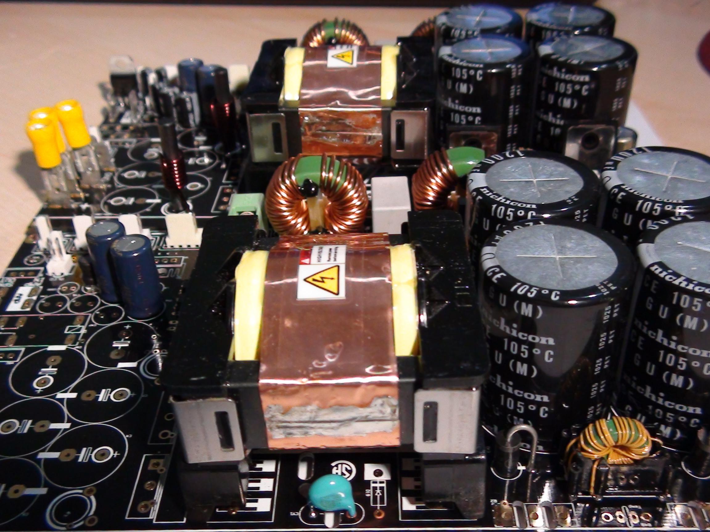

SMPS for CLASS-A Amplifiers +-25VDC 26A
Hi Everyone
Any one interested into SMPS for CLASS-A Amplifier? +-25VDC
The SMPS drops 6 Volts per rail at 26A DC output.
Just developed a nice 1000W SMPS specifically designed for CLASS-A with on board Turn ON delay / DC Protection.
Attached a picture of the PCBs under assembly.
Other voltages available also
Thanks!
