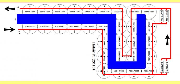

I just noticed your photo of your wiring scheme on post 14,936 (23/6) and am a bit puzzled about the coloured lines detailing the layout of the power supply - is this the way you intend to wire it up or is this how you've done it? - let's see if I understand the layout correctly ...
If I understand your blue and yellow lines, the block bridge on the left hand side connects to 15 // capacitors, then presumably thru a resistor (with the 2 // axial caps?) and then thru another 15 // caps to feed both channels the -ve voltage power, yes? and the same ly for the +ve rail?
The supply connections from these supply assemblies is passed directly behind the transformer and over the top of those 'noisy' block bridges, on their way to deliver current to the amp pcbs, yes?
And the '0 Volt' wire from the amps pcbs is twisted with these supply wires and then passed directly over these block bridges and transformer on their way to the central '0 Volt' point then onto the 'ground lift' thermistor, yes?
And the SPKR return wire is twisted around the SPKR+ wire and continued on to the central '0 Volt' point, yes?
I'm surprised that Andrew hasn't commented on this before but here goes for my opinion ...
First, I dislike GB block bridges in amp power supplies and especially in the F5 design, but that's just me - there are some Schottky ones available that are okay - my opinion here, plenty of other people have no problems with them.
Second, this string of capacitors in each bank for each channel has created it's own series resistance (like multiple parallel R - C networks), and the 'best filtering' is at the far end of these banks (where you've added those 2 // Phillips caps) and this is the point where you connect the wires to the power amp pcbs and take them directly across, not looped them around the transformer, block bridges, etc - twisted together as you've indicated - not anywhere near those extremely noisy block bridges - more about this below
This will take all your supply wiring away from both the transformer and the diodes.
I would suggest you change the wiring - rewire your capacitot assemblies so you have the +ve and -ve rails on each assembly - although this halves the capacitor total value, the benefits are shorter wires, separate supplies/channel, bigger distances between diodes, transformers, etc etc

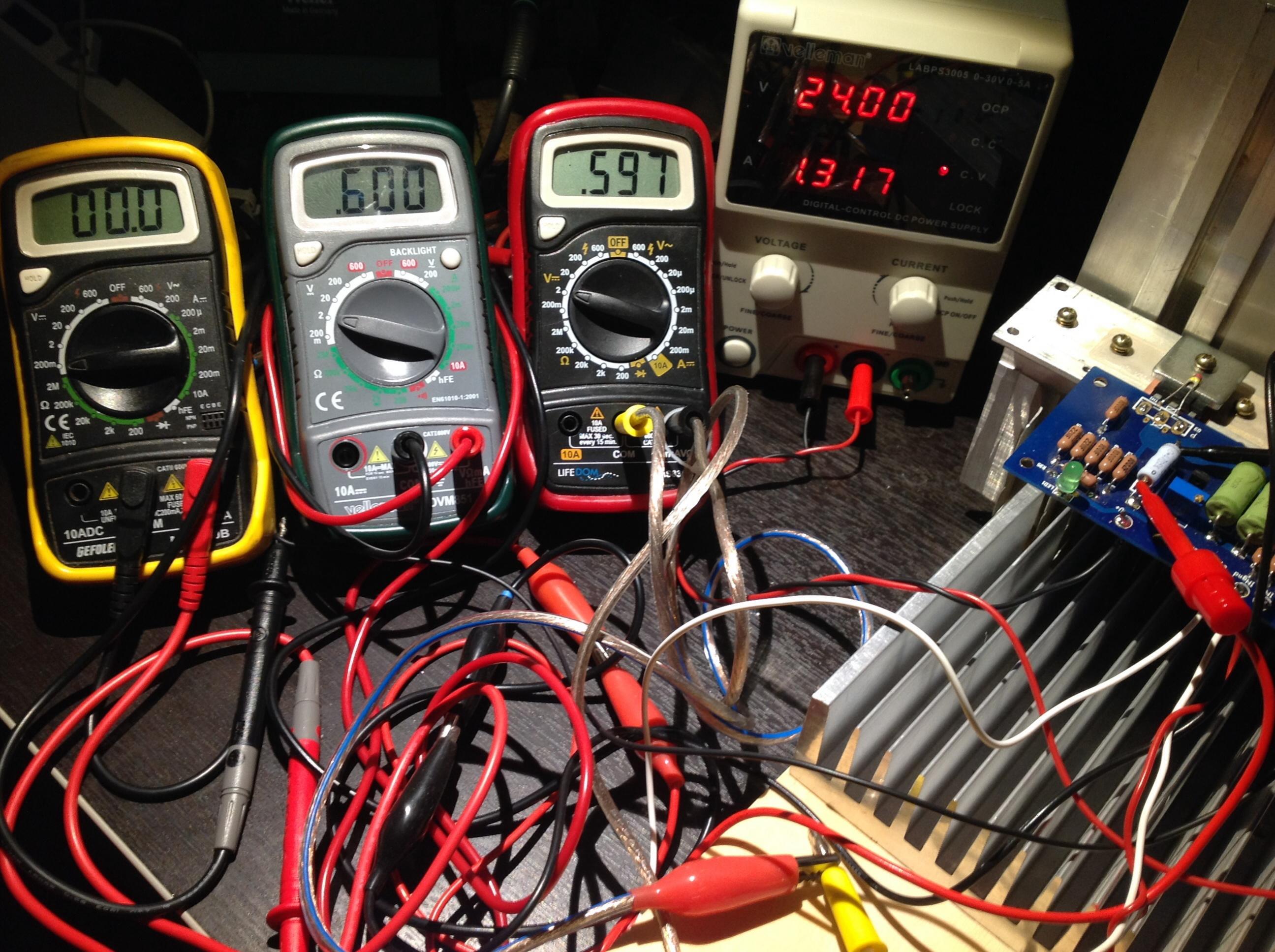

Mmmm... quick first F5 board test 🙂

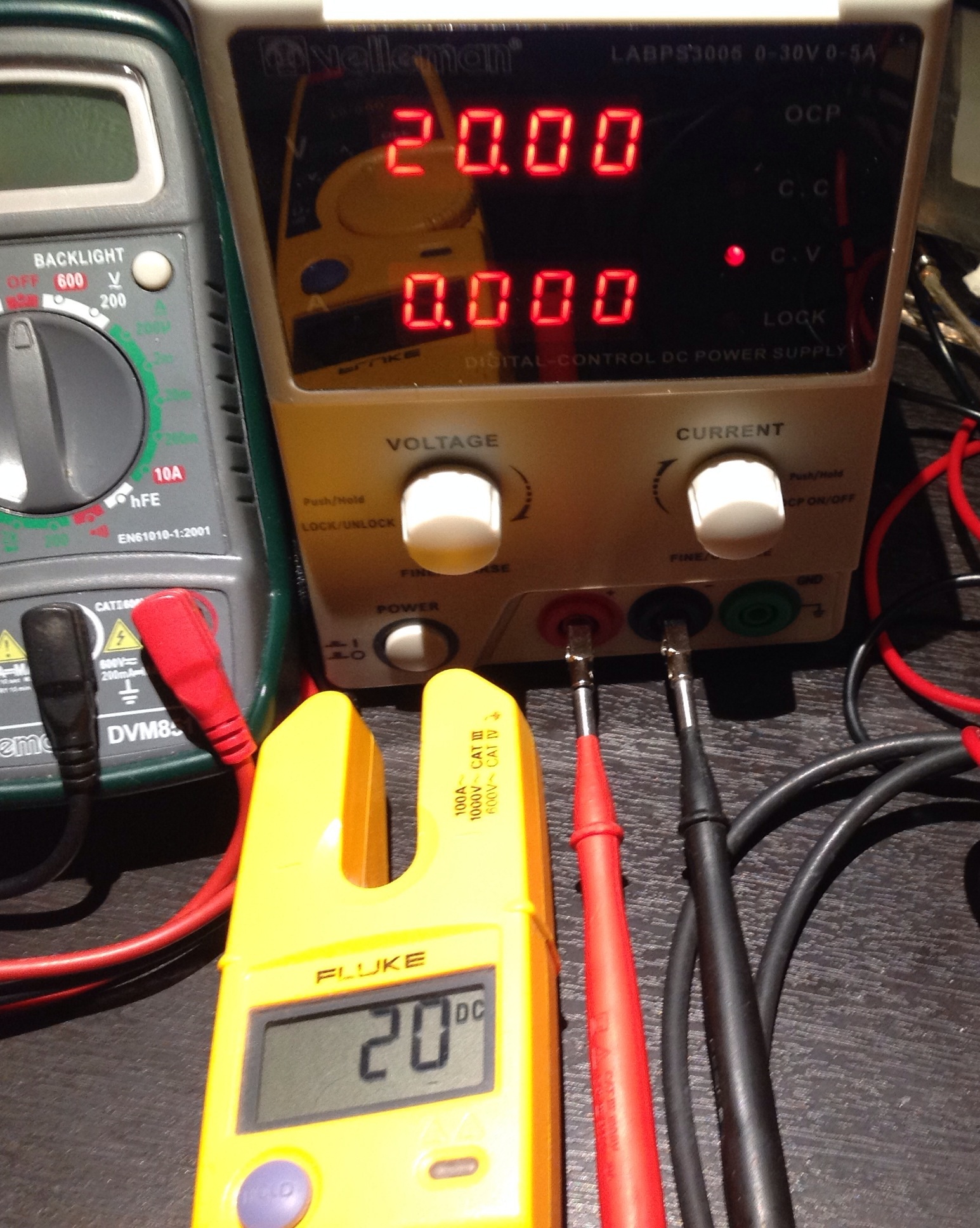

Just a word of warning, I own the same Velleman version in the middle, it's readings are often off by about 10%, compared to my fluke and Osciloscope..
@ Stijn001
I have verified all multimeters and bench psu calibration with Fluke
after your message and it's the same voltage value on all windows.
Thanks for council and best regards
Probably internal battery discharge in yours ?
Agilent , HP or other 000 $ very high precision
lab multimeters not this time 😉
For bias and offset is just ok
Best regards
I have two identical DMM's where one is low on power, it will read incorrectly 0,9V while the fully powered DMM give the expected reading of 0,6V. (A third DMM verify 0,6V as correct value)

Hi and again thanks for adding in 🙂
1 - The drawing you refer to show the actual wiring layout as it is today.
I have also added a drawing showing the actual layout of the positive power rail.
Good point regarding power line running in close proximity with the bridge rectifiers, I was not aware of the possible issue but it makes sense. Will investigate as time allows it.
2 - Yes
3 - Yes, but I did add a jumper from speaker negative terminal directly to star ground and the level of hum was reduced.
On my test speaker (84db sensitivity) there is no audible hum detectable with ear next to driver, on a different system with a high-80 sensitivity level there it barely audible hum (not audible at listening position 2m away) and with my Line arrays in the high 90's I can hear hum from listening position at 3m distance. It is not detectable when playing music but its present.

I have three battery powered DMM, all fairly cheap.I have two identical DMM's where one is low on power, it will read incorrectly 0,9V while the fully powered DMM give the expected reading of 0,6V. (A third DMM verify 0,6V as correct value)
All have a battery warning symbol.
The two older DMM still read pretty accurately soon after the battery starts to show as low.
The new one has not run out of battery yet, so I don't know if it becomes inaccurate as battery goes low.
