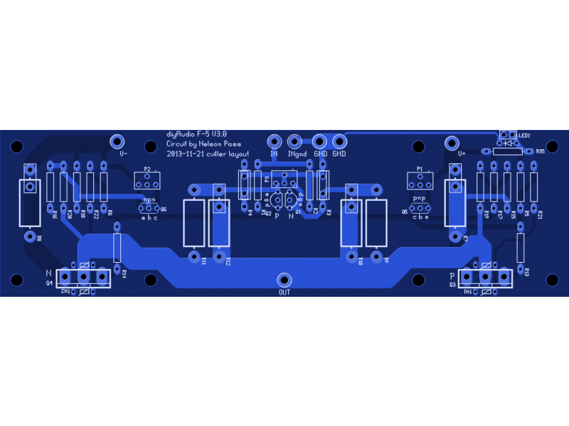

See attached close-up. I can't remove the boards at the moment to take a photo of the under-side.
I can't find any info on the KR4002. Thought it might be equivalent in the same way that a LSK170 ~= 2SK170. Same part, different manufacturer. I'll get some 1N4002s to be safe.

What 6L6 said (drew). Assuming no other traces connecting signal ground to power ground on side B of board.
the signal return/ground has to go somewhere when it enters the PCB.
Where does it go?
That was what I could not see in the first pic, nor in the second pic.
Remember what I keep having to repeat. The input CIRCUIT must remain as a circuit and (preferably) all the Flow and Return traces should be close coupled.
Where does it go?

OK, I see the problem. Cutting the trace and adding the HBR there would put the HBR in the signal path. But I don't see any other path for input gnd other than through the common power ground as seen on the board. I don't think there are any traces on the under-side of the board connecting the input ground to anything else (would appear as dark lines on the attached photo (without my yellow arrow obstructing the view)).
So, to implement Joffe, I might have to not only cut the trace and add the HBR, but also add a jumper (to where?) to complete the input signal circuit.
Again, this is well beyond my level of understanding, so correct me if I'm wrong in any of my assumptions or conclusions.
Not sure I can see the detail, but here goes.
The pads at the centre top are left to right
IN, INgnd, GND, GND
IN connects down to a wide left to right trace. This wide trace has two components at it's ends, are they resistors?
INgnd connects right to GND
left GND has two connections, down to a pad and down again to a capacitor
and right to the right GND
right GND connects via a thin trace to a LED pad and maybe a diode?
Back to the left GND.
This looks like part of the INput circuit.
What are the components just below the left GND?
What traces are on the bottom side of the PCB. The right GND cannot just stop there. It must go somewhere.
IN, INgnd, GND, GND

Yes, R1 & R2 on the V.3 schem. 4.75R & 47.5K respectivelyNot sure I can see the detail, but here goes.
IN, INgnd, GND, GND
No, the 4 pads aligned below the left GND are for R3 (extra holes for alternative resistor case styles, I guess). No capacitor (this is an F5, after all).INgnd connects right to GND
Yes. Don't know what the diode's for... optional, not in the schem.and right to the right GND
R2 and R3.Back to the left GND.
I can't take the boards out at the moment to see the bottom traces. The darker lines on the photo of the board (from the diyAudio store page) show the bottom-side traces (at least those portions not obscured by the top-side traces). I can tell from the photo (linked below, again) that InGND, LeftGND, and RightGND are interconnected, and also connect to R1, R2, R3, R4, and the wiper pin on P3 (not used in my build). This is consistent with the schem, and thus I don't think there are any additional traces connected to GND on the bottom side of the board.What traces are on the bottom side of the PCB. The right GND cannot just stop there. It must go somewhere.
