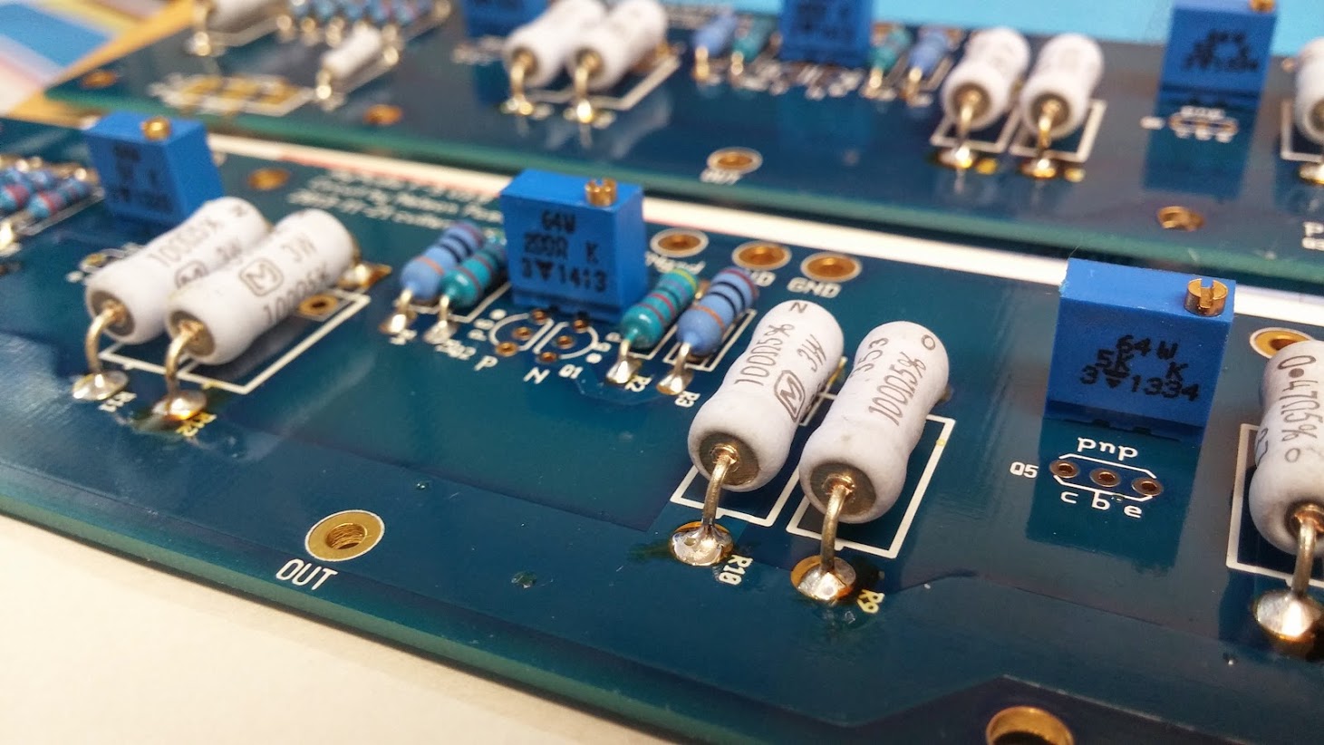

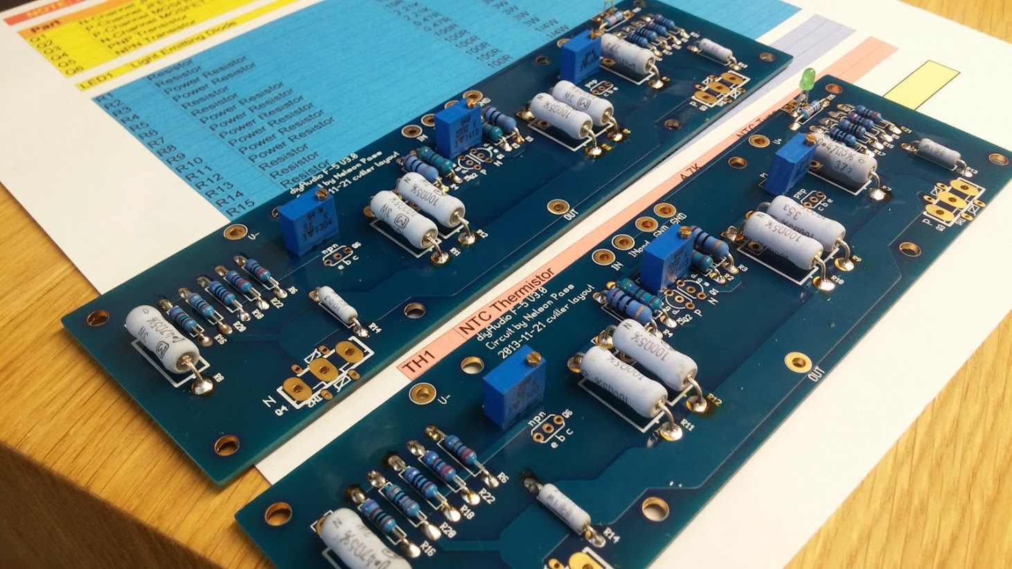

Some closer look at V 3.0 boards. I used Panasonic power resistors, and 0,6W 0,1% tolerance for the rest..
But, that is not a "Turbo" F5 version? That would be page 9 of the Turbo manual: http://www.firstwatt.com/pdf/art_f5_turbo.pdf
The F5 Clone PCB Version 3 is here: F-5 clone boards (2 PCBs, makes 2 channels; Rev 3.0) - Power Amplifiers - Circuit Boards And the schematic from that page is : http://www.diyaudio.com/forums/imag...n/P-F5-1V20/P-F5-1V20-schematic-revision1.pdf But called V2? And the BOM is apparently "Under Construction"?
Same confusion I ran into about a year ago, when I build mine, ... 🙁
DiyAudio store F5 pcb V3, follows the component/numbering of the schematics in the F5T manual (page 2)
