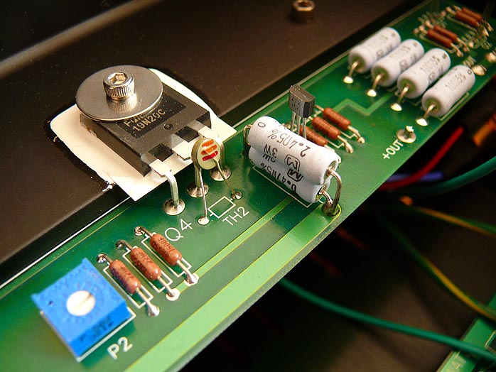

Hello,
I have large washers and they pretty much cover the entire FET.
On the 6moon audio site picture, the production model F5 thermistors are not touching the FTEs.
On this thread and build guides, it is being recomended they do touch the FET
In my case, would it be ok that the thermistor touch the Washer on top of the FET ?
Thanks,
I'm building original F5 R1
Thanks !!
I find it weird that the production model thermistor is 'in the air'
See pic attached.
Also sorry, but how would the insulation of NTC itself get scratched? My mishandling?
I was planning to put a dot of thermal conductive expoxy to hold the thermistor in place as my thermistors are soft-leaded with a tiny head, all black.
Thanks !

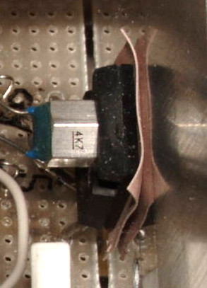

much better to touch case of mosfet , not washer
in case of scratched insulation of NTC itself , amp will go Dodo
I'm usually not having too much doubts in Papa's solutions , same case here
it's us - Greedy Boyz , chasing our tales ......... :rofl:
so - whenever you are puzzled how to do something , just take a look how he made it
insulation scratched - dunno - don't ask me , but few guys on board had exactly that problem

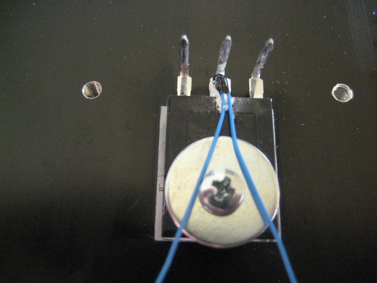

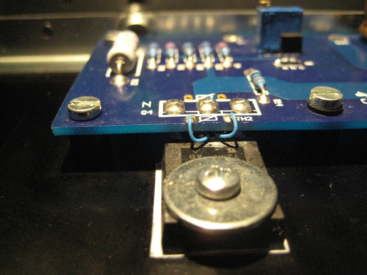

You describe the same NTC I used. Scratching is almost not possible.
I did it like this:
Is there any issue mounting the PCBs on the heatsinks but with FETS on the down side?
I don't think there would be much more heat going up to PCB that if the FETs were on top.
Just in case, I could go throught trouble of mounting it at 90 deg, but I want to get this done soon 🙂
