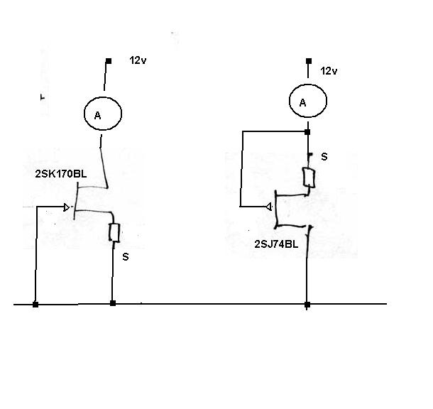

can you give me a scheme?pull out all semis and test them with simple matching jig

http://www.firstwatt.com/pdf/art_mos_test.pdf
small bjts you can test with diode test on your DMM ; http://www.bcae1.com/
you can use 10R for in lower pic
use 9V battery for V
