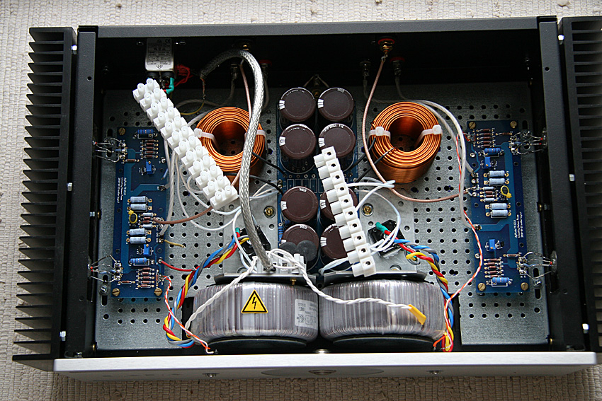

I can see that I should have credited Pass on the faceplate, but rigtht now he wouldnt be proud of me 🙂
I use 2 trafos because I originally wanted to do 2 separate PSU´s, but I didnt find the space sufficient.
The screw terminals are to isolate the power supply.

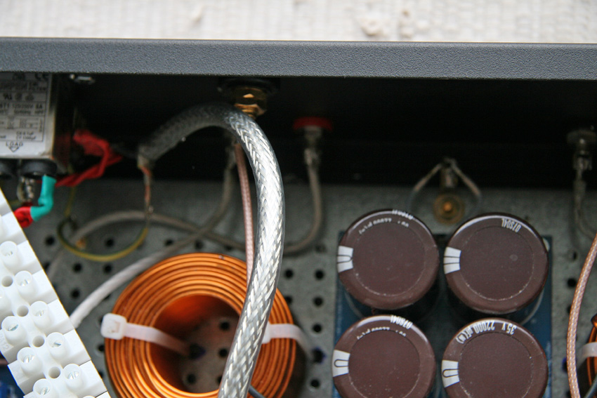

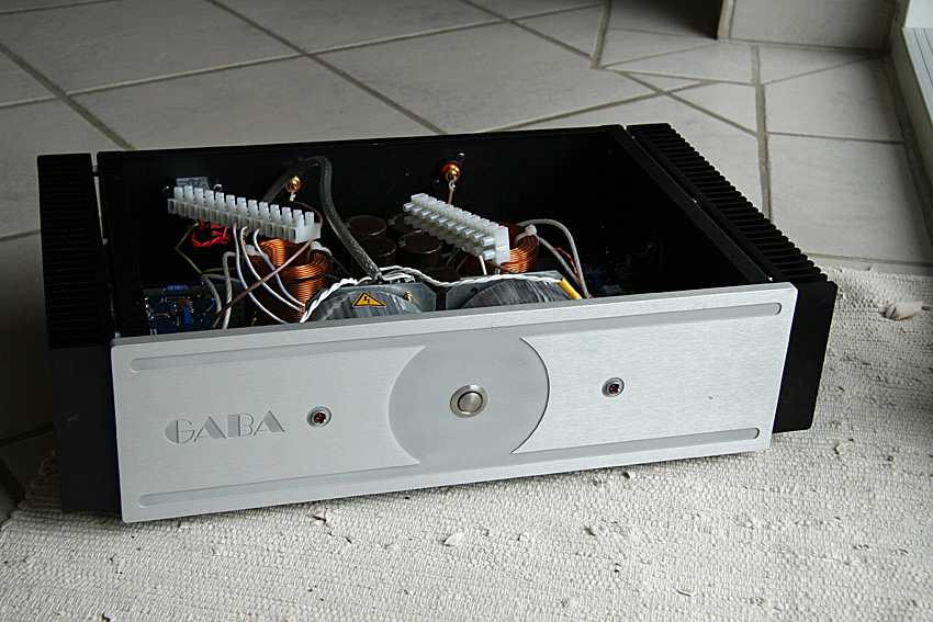

On picture 3 you can see the 2 chassis connections. On the left the mains earth, and in the middle the PS earth.
Could a stray wire from the mains shield be shorting the mains? The picture makes it look close to the connections at the transformer end. With good twisting of the wires you don't need to be so aggressive shielding. A bit of heat shrink on the ends of the connections would keep the ends of the braid under control.
I like your home-made fender washers on the output devices. 😉
Double check that you have the transformer windings connected correctly - are they anti parallel causing a short? When you get to the check the rectifiers stage, try one winding at a time.
Silly question but I can't see any insulating washers between the MOS-FETs and the heatsink.
The shielding does not touch anything, but I have put some isolation tape on now. It is of course not a silly question, but I do have isolation washers on all the MOS FETS. But when I measure from ground to the MOS FET pins I get different readings on the amp 2 sides.
One side shows about 18Kohms from all 3 pins to ground, (I think that that was on the channel that I connected last time) and the other side shows indefinte on all pins? Maybe that could be the problem, but what is the course?
The home made Fender washers are Danish Crowners 🙂 They are not good for much more than this 🙂
I think I have the windings correctly connected, in that when I the last time tested the PSU without a load it worked correctly.
But when I connected the amp board the diode bridges died.
