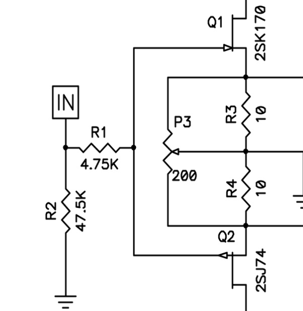

Over time I have run into examples of DIY F5's that were marginally stable
or perhaps a bit twitchy on the top end.
My own observations of the top end of the F5 with some of the full range
drivers was that it was a bit like "putting instant coffee in a microwave oven"
I went back to that recently and found that increasing the value of the 1K
input resistor to as high as 4.7K helps this, and recommend that people
experiencing overly bright sound or instability try it.
The resistance forms a low pass filter the input capacitance of the Jfets, and
takes the bandwidth down from the 1 megahertz region.

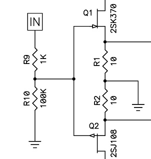

Hi Nelson,
Thanks for that explanation. Did you increase the mosfet gate resistors for the same reason?
Also of note, in the first F5 schematic the 100K ground reference resistor was placed after the 1K input resistor, while in later versions the ground reference was placed in front (as well as changed to 47K). Can you comment on the advantage (if any) of that change?
comment is already there - you quoted it
Nelson said why the input resistor value was changed, but didn't say why he changed the configuration of the resistors.
There are other differences in the F5 V2 schematic besides R9:
R10 is 47.5k
R10 R20 are 100R
R22 22 are 10K
R13 R11 are 100R
I wonder if it's worth changing all of them? I didn't realize there were two versions until I looked up R9.
Additionally P3 pot was added and TH1 and TH2 don't go to the rails. I'm wondering if there will be new boards available which reflect all the changes to the circuit?
