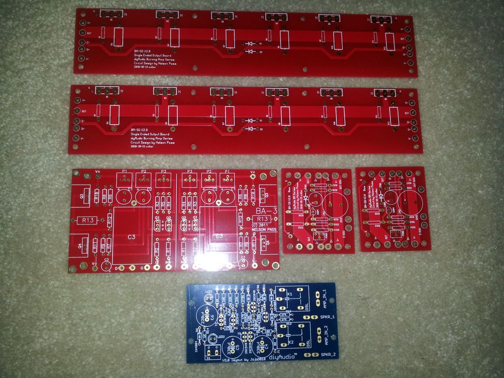

Here's my stash. May need some fill-ins once I determine my direction.
I've been moving in small increments, but cooling a BA has been my target all along. Should have some good info and pics to post in a day or two.
BA-3 front end, BA-single ended output boards and bias board, and (I think...) a speaker protection board?

Yes, I went with SE cause it reportedly runs a little hotter and presents a bigger challenge.
