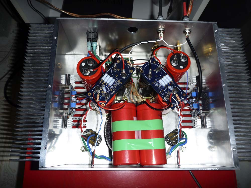

Also I referenced ground from the ground of the RCA input and had that connected to PSU ground.
Please excuse the caps and the mess. This is an old pic, it doesn't look like this now 😀
If you can see I combined the ground at RCA and went directly to PSU ground. I also took speaker ground from PSU ground as well. The ground from the amp board should "flow" towards the RCA ground to PSU.
I had hum as well when I connected otherwise. This way I don't get hum even when attached to 104db speakers and 25db gain pre.

Remove the -ve wire ( black ) to speaker from amplifier board , and connect it to power supply board ground .
That was much louder. In fact the mechanical hummm of the transformer was increased in that configuration.
grounded inputs - same reading ?
Yes
what's happening when you feed just one channel with present PSU ?
I will try it and find out. 🙂
