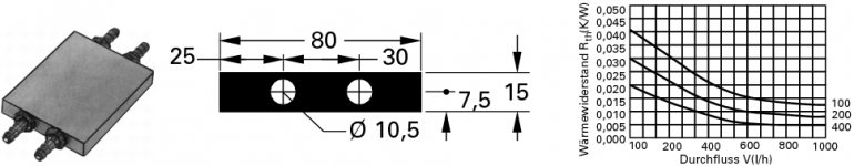

When water flows through a gap, the water layer next to the solid surface is the laminar flow regime.
If the water speed is low, the laminar flow layer is thick. If the water speed is higher the laminar flow layer is thinner.
If the water speed is raised even further the laminar flow layer becomes very thin.
The laminar layer acts as an insulator, it reduces the amount of heat flowing from the solid surface to the turbulent layer.
The more turbulent flow one has in the fluid/water gap the more heat will be removed.
Vortices can be added to increase the turbulent flow and thus reduce the laminar flow thicknesses. Or simply speed up the flow for more turbulent flow. Either will remove more heat.
Slowing down the flow is NOT the way to improve the heat transfer!

I did make another steel tube if you will,I found some aluminum and will go after it soon,The 2 sided heatsinks works well,I used 2 square tubes one on each side of the fets,and clamped the 2 together squeezing the fets in between them,I have a pump and a 5gal. bucket no cooler/radiator yet,but I ran 2 amps or around 1.3 volts on the source resistors,and it was steady at 45 C at 24 volts on a stock F5,I turned down the voltage to 18v and it stayed at 41C ,I am going to go with .250" wall thickness on 2" square ALUM tubing,the .5" tubing that I connect the hoses to,will extend into the square tube and get some holes in the sides to spray the wall inside the square tube that has the fets mounted on the outside wall,squirt it in the back,lol.The fronts of the fets run hotter than the backs,surprised me ,I guess it's the plastic to metal,but I'm happy it does work, I'll get these 2 amps up and going then try the F5c,Thanks for the comments,at least I still have working FETS this time,The other ones had to be burried they smelled so bad...RIP,LOL.any more Ideas I'm all ears!!!!!!!!!!!!!!

The Aluminum tube should help a lot, look up the thermal conductivity of steel and aluminum.... Being a lot larger and thicker is going to help a lot too..
