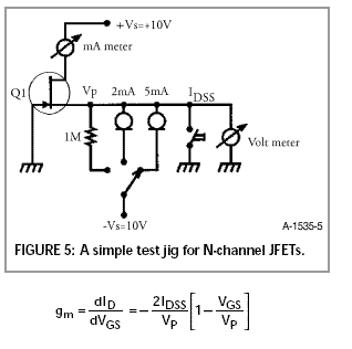

Below is Erno Borbely's "Simple JFET Tester" -- of course it's set up for N-Channel devices, but just change the polarities, and reverse the direction of the current sources (you can use JFETs for the current sources since the diodes are rather hard to get.)
Engaging the first position of the switch gives the pinch-off voltage Vp, read by the volt meter. Shorting the source to gate (ground) gives Idss. Thus you can calculate gm.

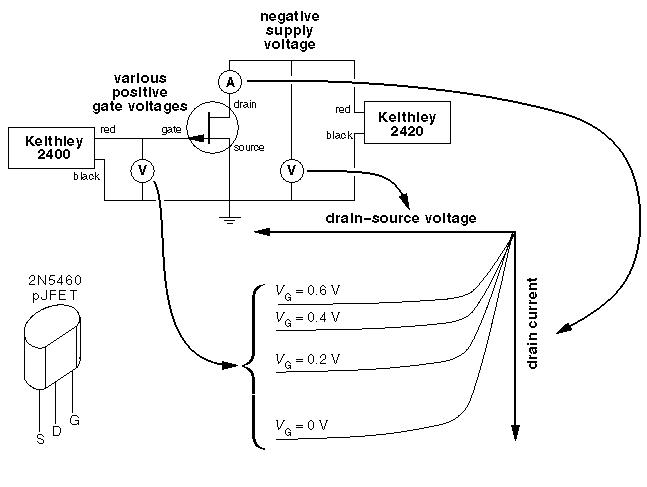

Hi Jackinnj,
Thanks for the pinouts I'll be sure to check those parts when they get here ,I got that circuit from their site, pins are different !
Thanks for the schematic it looks like it's easier to use
NS
NS

Hi, it likely has been discussed here, but searching through about a half of this thread I still cannot find it, so can anybody advise/point to: what has to be changed on cviller's boards (v.2 - not the current one rev.2) in order to build F5 Rev.1?
