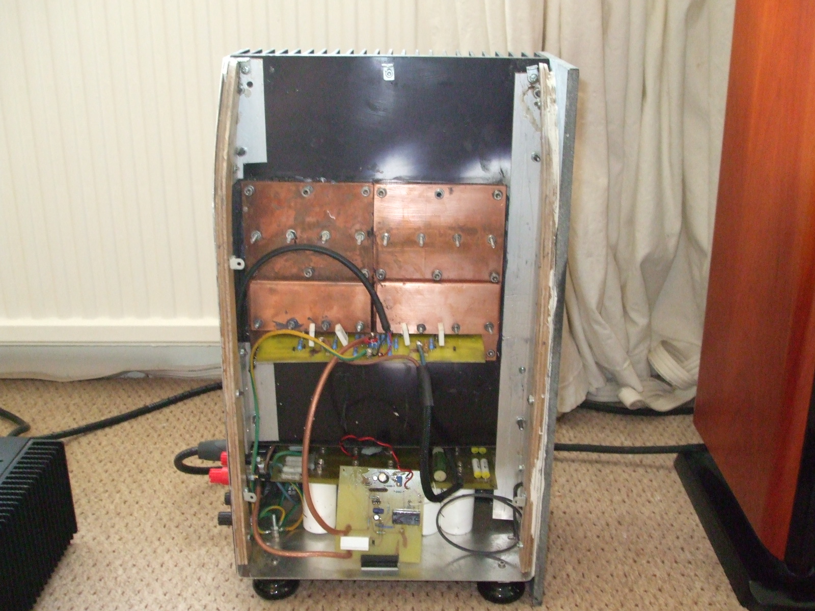

I have been running pairs of FQP19N20 and FQA12P20 at 32 V 2.6 A since last August on 300 X 400 X 86 sinks (190 W) soon I am going to do balanced on same sinks and may need litle fans to help a bit.
And Papa uses Mica and goop with big washer so there may be same head room if one uses Kerafoll and prety uge clamp bar and massive screws :D
Bksabath wins todays FAB award
what the F...k is a FAB do I get prize for "to dumb to get that":D
and as one mention big heat sinks...
not big enough for balanced!:(
