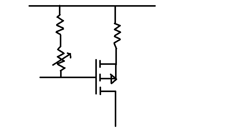

could any one tell me why the Thermistor and the 2.2K Resistor are different in the revised Scheme? They are not coming from the Rails but now from the Pot.
What is the advantage of this change?
not really...
the revised version inserts the 0R47 source resistor in the thermistor circuit.
V1: temperature compensation is static only.
V2:the voltage variation across Rsource makes the compensation dynamic also.
My 2 cents.
The way I see it is that a resistor to "earth" (the rail) is in parallel with the drain resistors and pot (parallel the values) so that means that the amplification changes with temperature. Even if we believe that the temperature stabilizes.
Now when we connect it to the source then the value cannot be paralleled as the virtual impedance of the resistor connected this way is HIGHER! This is because there is feedback from the dynamic changing Vs.
Very smart move!
Very smart move!
I think i got it.
For compensation, you want to act on the Vgs of the mosfet.
In V1 compensation network takes into account the source resistor (Vgs + VRs) ans so, sees some kind of nfb. (See fig.)
In V2 compensation is directly source to gate. Which is more efficient.

I think the only difference is 0,5R (Source Resistor) and the voltage drop across it which does not matter that much. The V2 has the advantage that it is easier to find a layout with the ntc closely mounted to the mosfet.
Depends how many amps are flowing.
Of course. The second variant is more exact as stated above, I think the principle remains the same.
So what if one get realy good set of matched mosfets and drop the source resistor to 0.25 (or there about) homs.
what efect this will have? (soundwise)

I use 0R22 in one of my F5s without problem.
