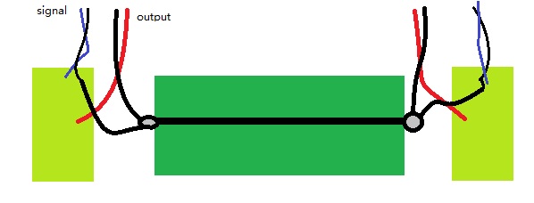

I have switched the pre amp to my audionet with 1m Nordost Tyr
and made a quick star ground modification to my psu pcb:
The result:
Still a small hum in both speakers, when both interconnects are connected.
It vanished only when i short the right input...😕

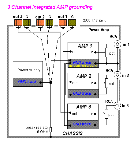

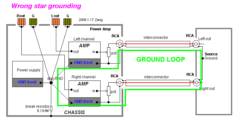

Hum problem located and fixed
With the information from digi01´s thread http://www.diyaudio.com/forums/power-supplies/115698-understanding-star-grounding.html, i have located the hum problem!
On the PSU pcb from Jims Audio is a grounding failure!
As you could see on the pcb, the amp GND´s left and right are connected direct to the central "star" ground.
That gives the ground loop, when the cinch cables are connected.
The correct grounding must look like this (also for 2 channel amp´s)
The GND from each amp channel must be connected together to one point
and from there to the star ground.
To fix the failure on the PSU pcb from Jims Audio, i made a small modification.
I cut the amp star ground connection on one side of the pcb,
and connect it direct to the amp GND on the other side.
Now both amp GND´s share one point and are connected to the star ground.
Result:
NO HUM
Thanks to all
for the help !!!
