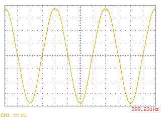

Here's a teaser, output into 0.1 ohms at +/-38 Amps.

so 0r6 is no problem.........
Note that the near short circuit current requires only 3.8Vpk to drive that 0r1 load. That is an output power of 72W.
You would need to test the amp into 0r6 and find out what voltage peak it can maintain.
If it is truly rated to drive that load then the voltage should remain fairly high. Certainly no less than 50% of the high load resistance output voltage and preferably >70% of the high load resistance voltage.
Short circuit current tells us nothing about speaker driving capability.
Vpk into resistive load, near speaker load, tells us much more.
Short circuit current can be used to assess what the protection systems could potentially do to valid audio signals.

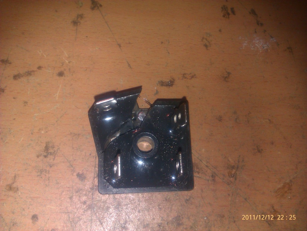

Be carefull when mounting the RIFAs! I have discovered in the bad way that the bottom mounting bolt is electrically tied to the negative side of the cap. I mean the PEH200 series (See picture). The datasheet vaguely point it, but not as clearly as it should be.

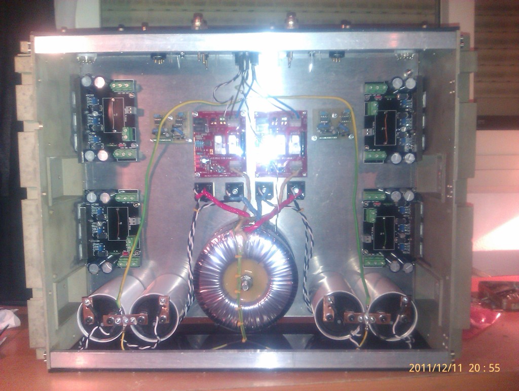

In the dual PSU amp I am building, everything worked fine outside the enclosure. The first time I powered it on mounted inside the case, it cracked in two the two diode bridges from the negative rail of the supply. I wonder why they tie the mounting bolt to the negative pole, being this a very convenient way to mount the capacitor, and neglecting this advantage as now I have to think how to mount it... electrically isolating this bolt 😱
