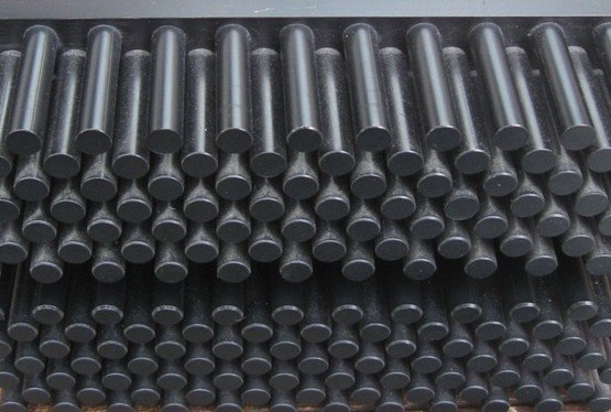

Thanks Bear
The heatsink idea was not mine.. I got the idea from the Burning amp chassis that were given away at burning amp a while ago..
Each tube is attached using 2 screws from the inside of the tube into the back plate..
Given away by?
Mr. Pass or some other person.
Don't think I have seen that one before... not sure why I did not come up with it, but it may be that the extrusions in that shape are actually fairly expensive compared to some others and other solutions...
Would like to give credit.
_-_-bear
make a neat heatsink.
Best and prettiest heatsink for DIY.
(rods are shrunk in the base plate holes, easy peasy to do at home with an oven and a zero-F freezer, then anodize)
