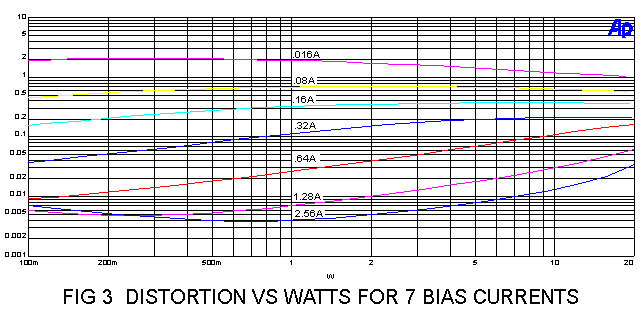

F5 power buffer only?
would it be possible to reduce gain of F5 to say 5db or better to unity-gain? If so, lowering bias current to say 150mA and I would have quite good class AB power buffer with NFB, right?
As I am looking for class AB buffer with some NFB or error correction. It is intended to be driven by tube preamp, but whole amp will not have global negative feedback loop.
Thanks.
Joined 2006
Thanks.
why not an F4.
The one and only
Joined 2001
So I want to have lower bias because of lower heat - thus class AB operation. I do not need more power (I am fine with 30W-50W into 8 ohms), but I need to lower the distortion in class AB mode(bias). How can I do that if I do not want global feedback from output back to preamp? Thats why I was thinking adding additional gainstage between preamp and buffer and making close loop of NFB within buffer and added middle gain stage - F5. Can it be done to lower closed loop gain of F5 - thus increasing NFB to say 5db or better to unity-gain without stability problems and lowering the overall distortion in lower bias mode?
I am not an electrical engineer, just had this idea.
Thanks.

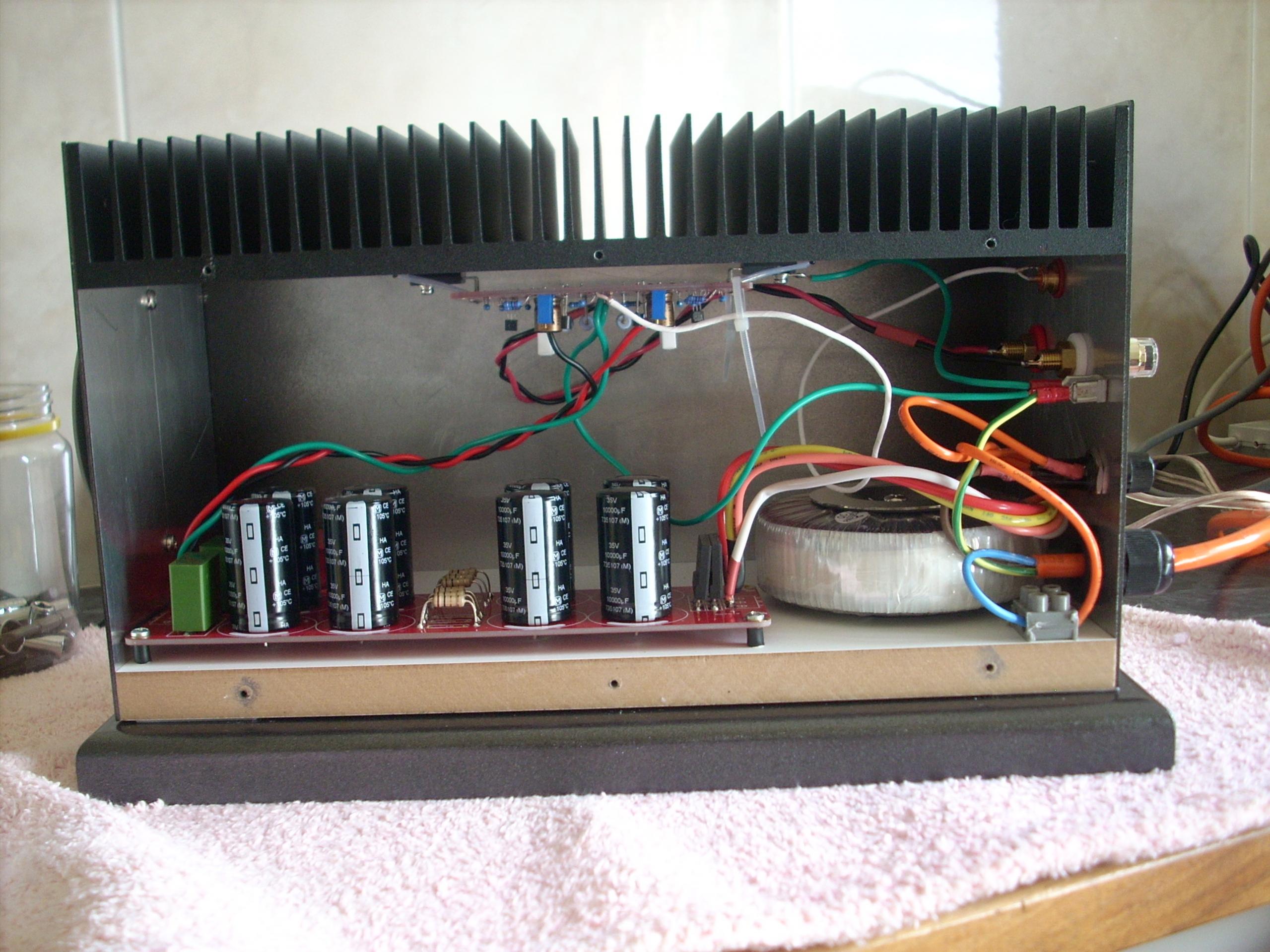

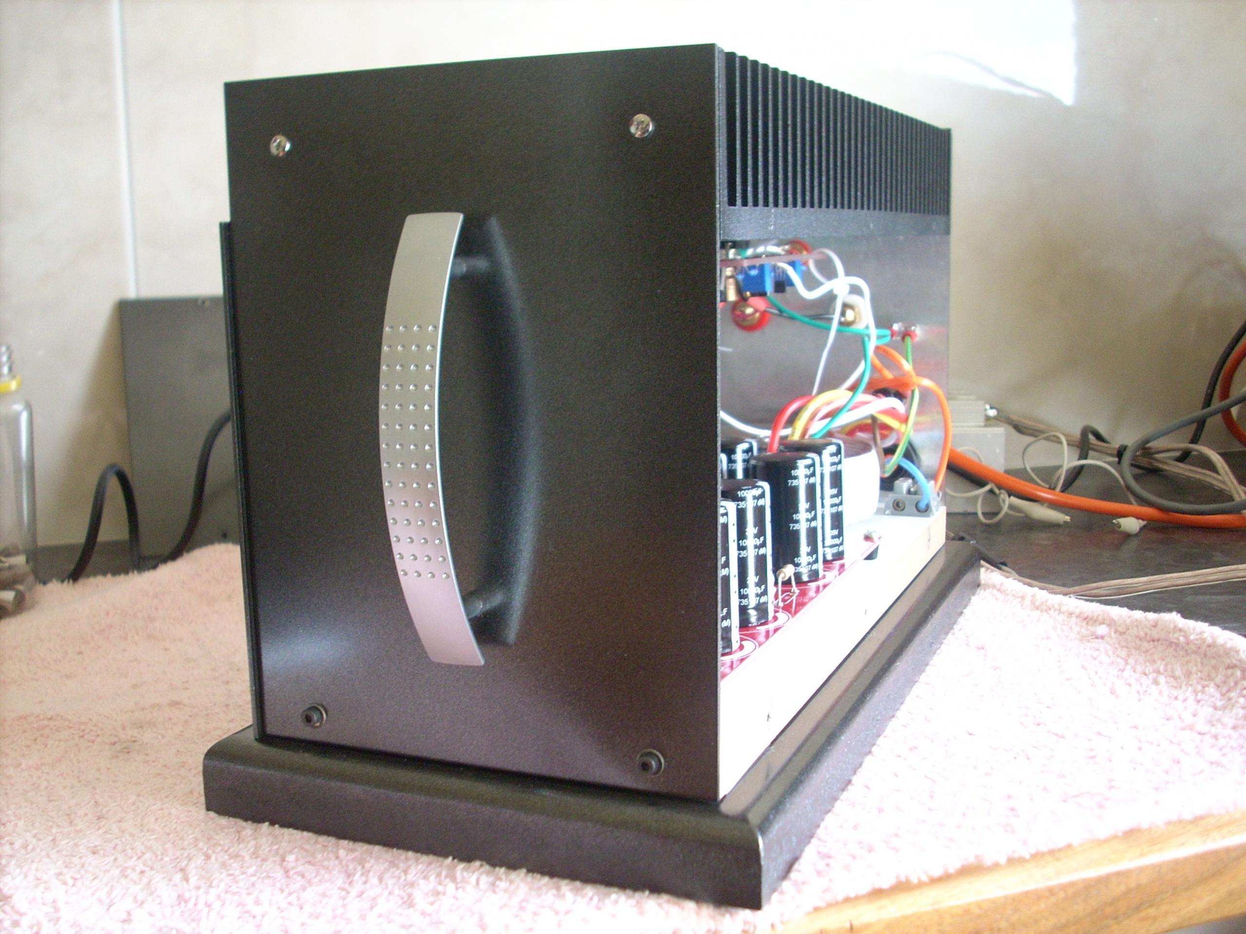

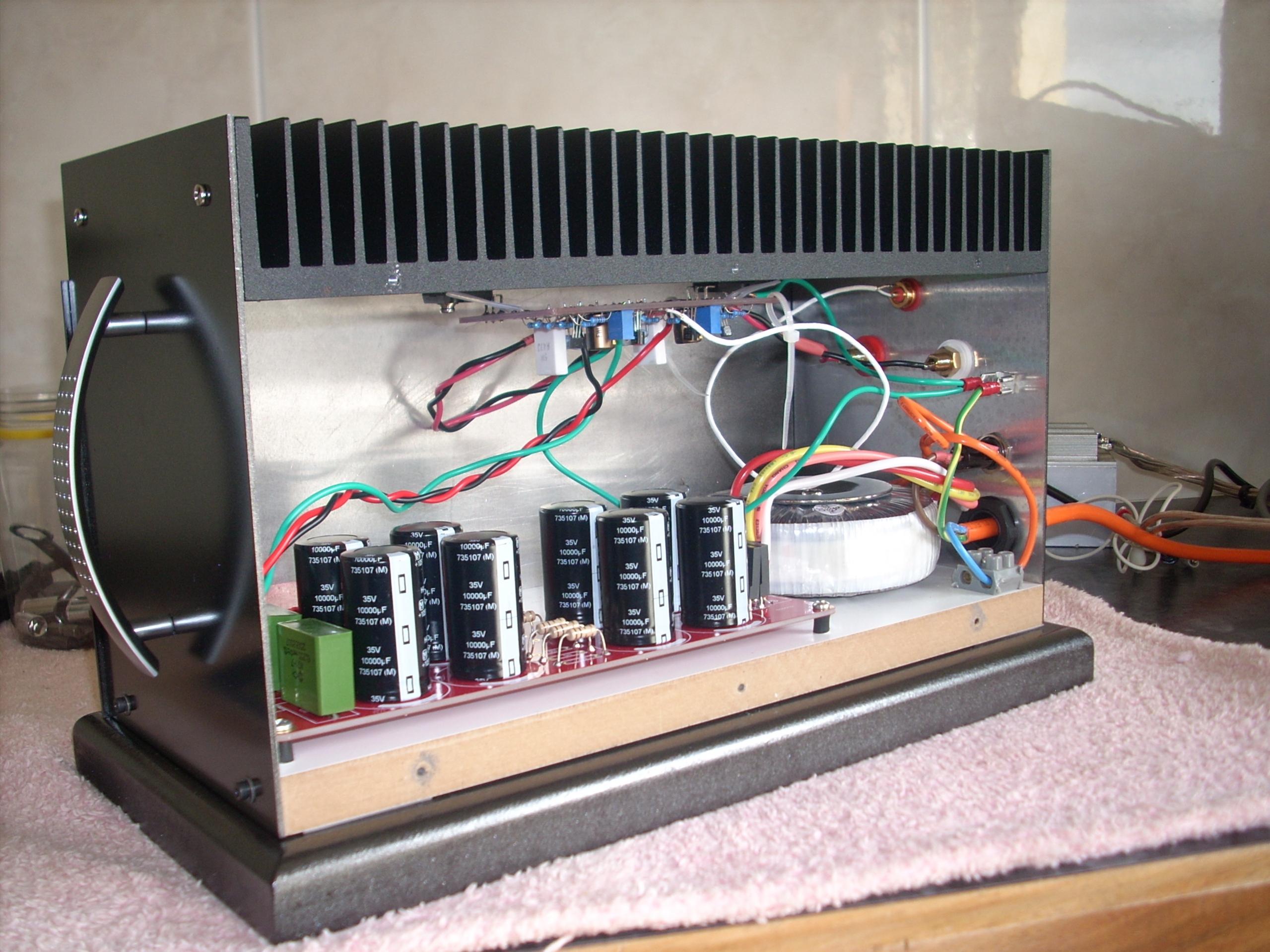

F5 Monoblocks.
This is my first post so here goes. I have just completed these amp's and they have been running on and off for 5 days. They definately give my 845 SET amp's a run for their money. The bass drum on track 4 of Doug Macleod "Come to Find" startled me with its realism. The drum has the sound of the drum skin and a real "whack", not just a soft thump. Guitar is utterly believable with string sounds that could cut paper. On the EMI Classics recording of Scheherazade the dynamic range and clarity almost allows you to imagine you are there at the recording session.
Build: JIM's Audio F5 and power supply PCB's, Conrad heatsinks, Panasonic caps, 160VA Jaycar transformers. Power rails bypassed with 0.25uf polystyrene caps. Front handle from Bunnings. Hard wired mains lead with 10A cable and mains plug.
Equipment: Osborn speakers, Rega Saturn CD, passive ladder attenuator, DIY interconnect and speaker leads.
Blown away by this amp. SET's on shaky ground.

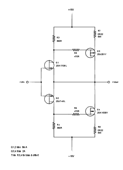

I had this idea around July last year, and discussed with Nelson.
The worry was (in)stability.
We even did some simulations which shows stability should be OK.
But one has to build to find out.
And since my original protos are with MarkLai, I cannot try it on them any more.
Here is my schematics (unproven).
