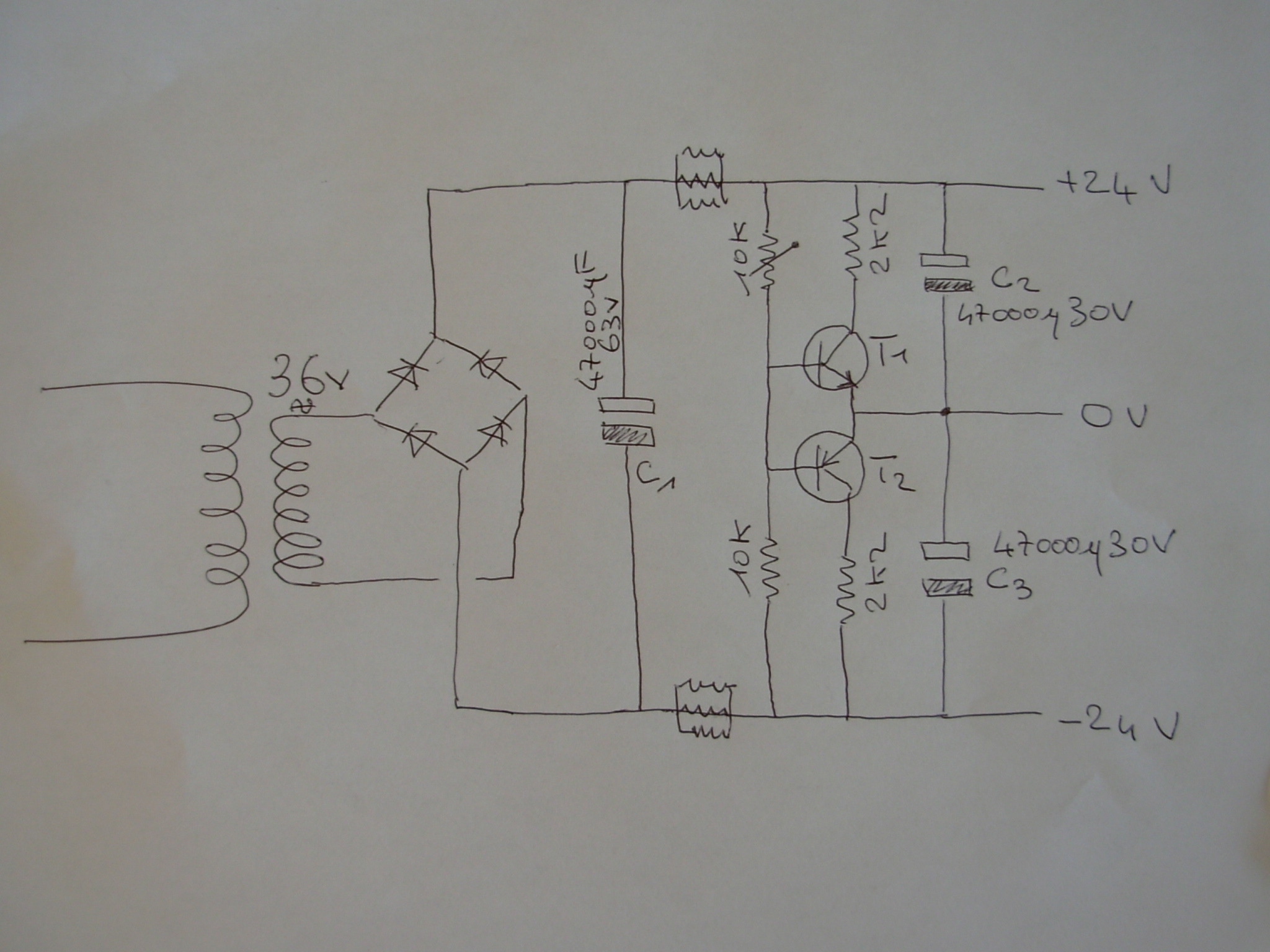

Splitting the two rails supply by creating a virtual ground such as Quad used to do works also.
Can you point me to schematics? Or how could be this done?
Is there really no way how to convert F5 for single rail supply?
Quad Download Page - quad-606-power-amplifier-schematic.pdf
Applied to F5
0V point is floating or connected to the ground? And what are those transistors for? Are they necessary?
0v is the reference point connected to ground.
The transistors avoid a drift due to unperfect symetry.
They are necessary.
I used BD139/140 without heatsinks.

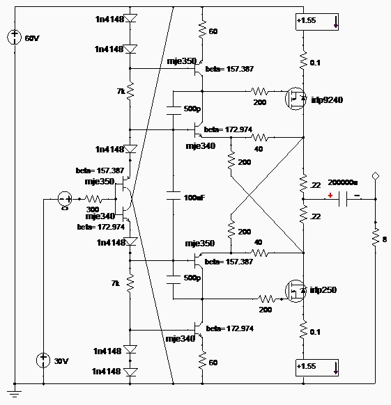

New circuit
And what about this circuit? It is circuit based on the schematics from earlier post (moskido schematics), but it should have no temperature drift already. Do you know how to adjust bias on this scheme? If I wanted to implement temperature thermistor, where should I connect it?
Thanks.
Thanks.
