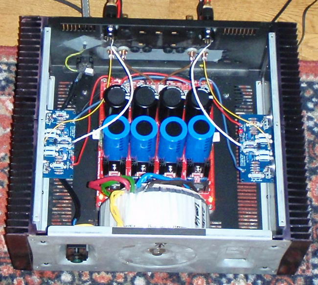

My first F5 up & playing ;-)
PSU type "Sjøstrøm-overkill-pcb" filled with 4 x 47 000 + 4 x 56 000uF + 2x18V -1000VA-trafo
Maybe it does make a difference, as I think it sounds surprisingly strong on not so efficient speakers, with good bass-punch.
Arne K
Arne K
Excellent boards, P-A did a fine job.
Costly to fill, but worth it.

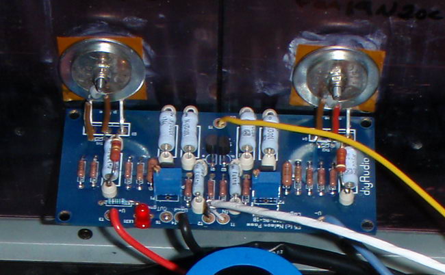

I used som time to figure out the bias-adjustment, the 2 pots did react quite different.
Running 1,5A now, heatsinks are warm, but not @£$# hot, and I can hold my finger on the mounting-washer for several seconds...(they are %£$# hot).
Chassi used to be a NAD 208
Arne K
Arne K

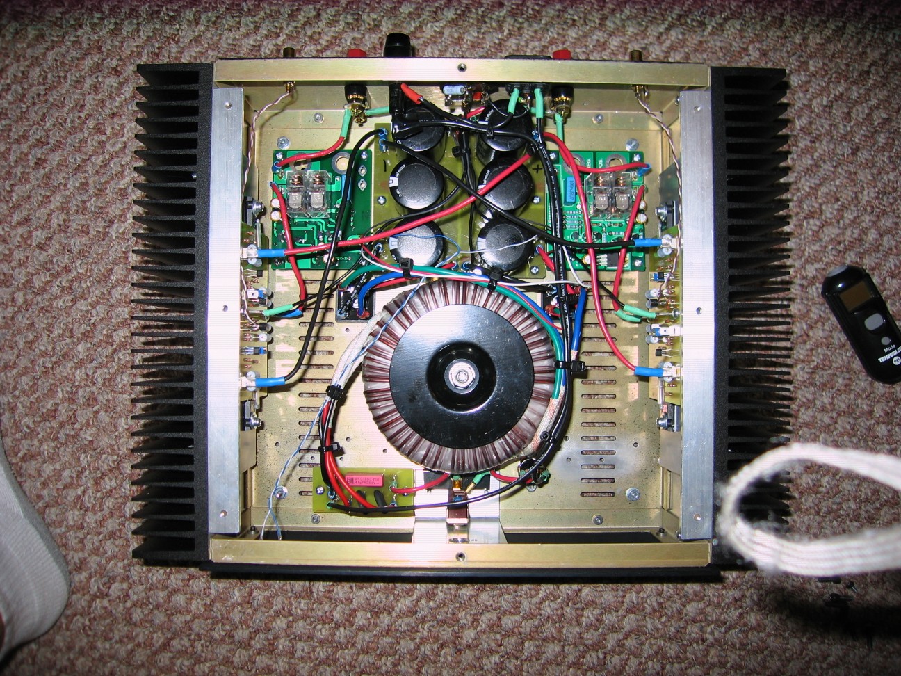

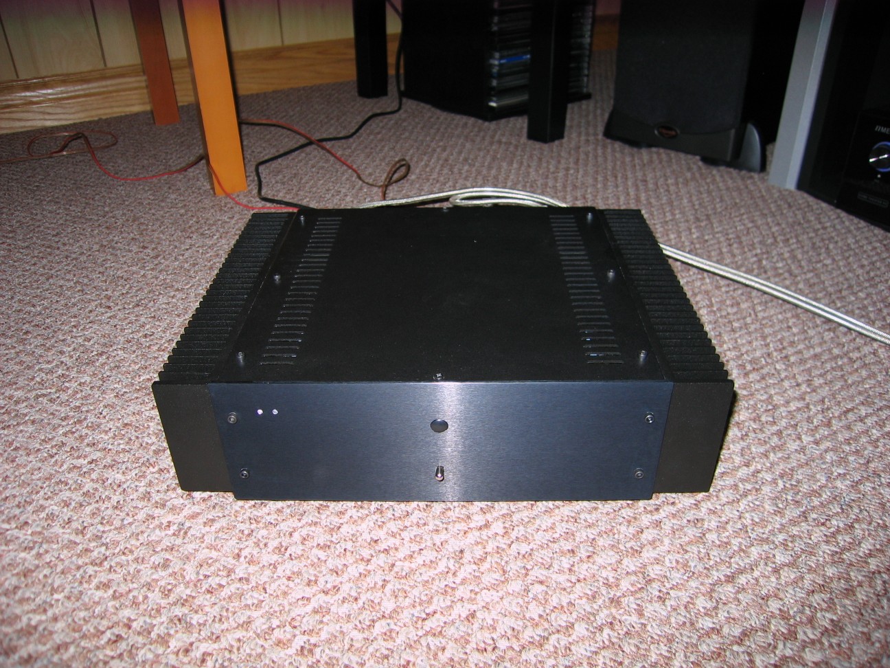

External: 400x300x100mm (w/o feet)What are the dimensions of this handsome beast?
Internal: 300x300mm
More details:
18+18V 400W transformer
77000uF caps per rail (154000uF total)
I use resistor pairs for R11 and R12 - one 3W resistor is obviously not enough.
temperature is about 50C at FET cases with standard 1.3A bias and 45C with reduced 1A bias (i'm using reduced one becasue the amp will have a shelf on top of it and i need only 3-4W for normal listening)
2x16A relays in protection modules
less than 1mV DC at outputs
