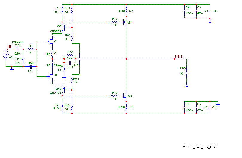

PROFET Question
Since I do not have complementary vertical mosfet in hands but lateral mosfet, I have tried the "Profet" version and I can not make it work on the bench when loading with 8 ohms. When I connect the 8 ohms load, the signal amplitude drops to about 70%. The open loop gain is way too low. I even used lower degeneration resistors for the jfet and less close loop gain than the original profet. I used only one output pair as the Profet. And the THD is quite high. It seems that laterals 2SJ49/2SK134 (or 2SJ162/2sk1058) have about 10 times lower transconductance than IRF244 for example. Has someone successfully built and heard an F5 or Profer with lateral outputs? I know that jackinnj has described a lateral F5 adaptation in one post somewhere... he had 3 output laterals but even that is a lot less transconductance than 2 output verticals...
Nelson Pass said:
Much of the difference is due to the high degeneration of their
input JFETs, the lower transconductance of Laterals and their relatively
high output gain. This means a lot less feedback, as seen by the
output impedance and distortion specs.
For Common Source topologies, damping factor = feedback.

Re: PROFET Question
That appears to be consistent with "Chuck" Hansen's review of the
Profet in AX magazine, in which he measured a 6.8 ohm output
impedance. That doesn't mean that the amp sounds bad, but it
tends to limit its application.

jam said:Fab,
.................Nice! My thoughts exactly.........byt do you need the compensation capacitor (C21)?
Jam
thanks Jam
C21 made no difference on my proto board but I put it there only by precaution. The value could be increased though since the frequency cutoff it creates is so high that is had probably no effect.
