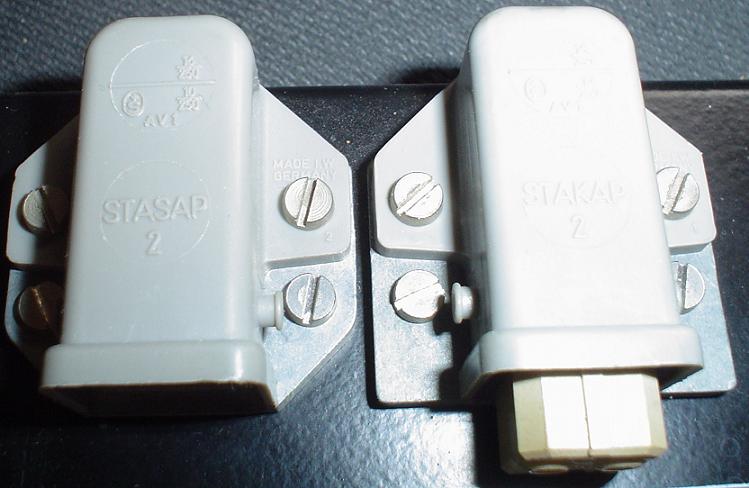

For that kind of connections i've been using Hirschmann Stas/Stak for decades, assembled a 3-piece Gerard Perrot (Mr Lavardin) amplifier design that was published in l'audiophile with them.
The Stas/Stak connector system is also highly water resistant, from 2 to 5 pole versions, example
A picture of the 2-pin types =>
