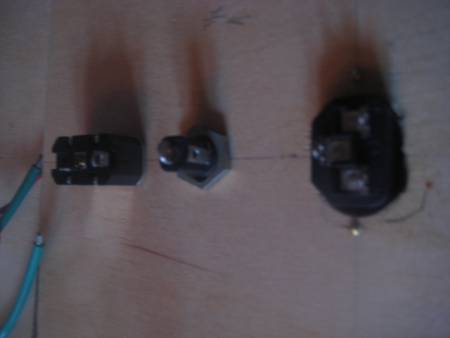

Dumb construction questions: (pics attached)
How do I wire the IEC, fuse, and switch?
Also, is the earth common for the AC, line level and speaker level connections?

Regarding my initial question "How do I wire the IEC, fuse, and switch?"...
Positive from the IEC -> one terminal on the fuse. The next terminal on the fuse is wired to one terminal on the switch and the next terminal on the switch to the hot lead on the primaries of the power transformer.
Thanks Gentleman,

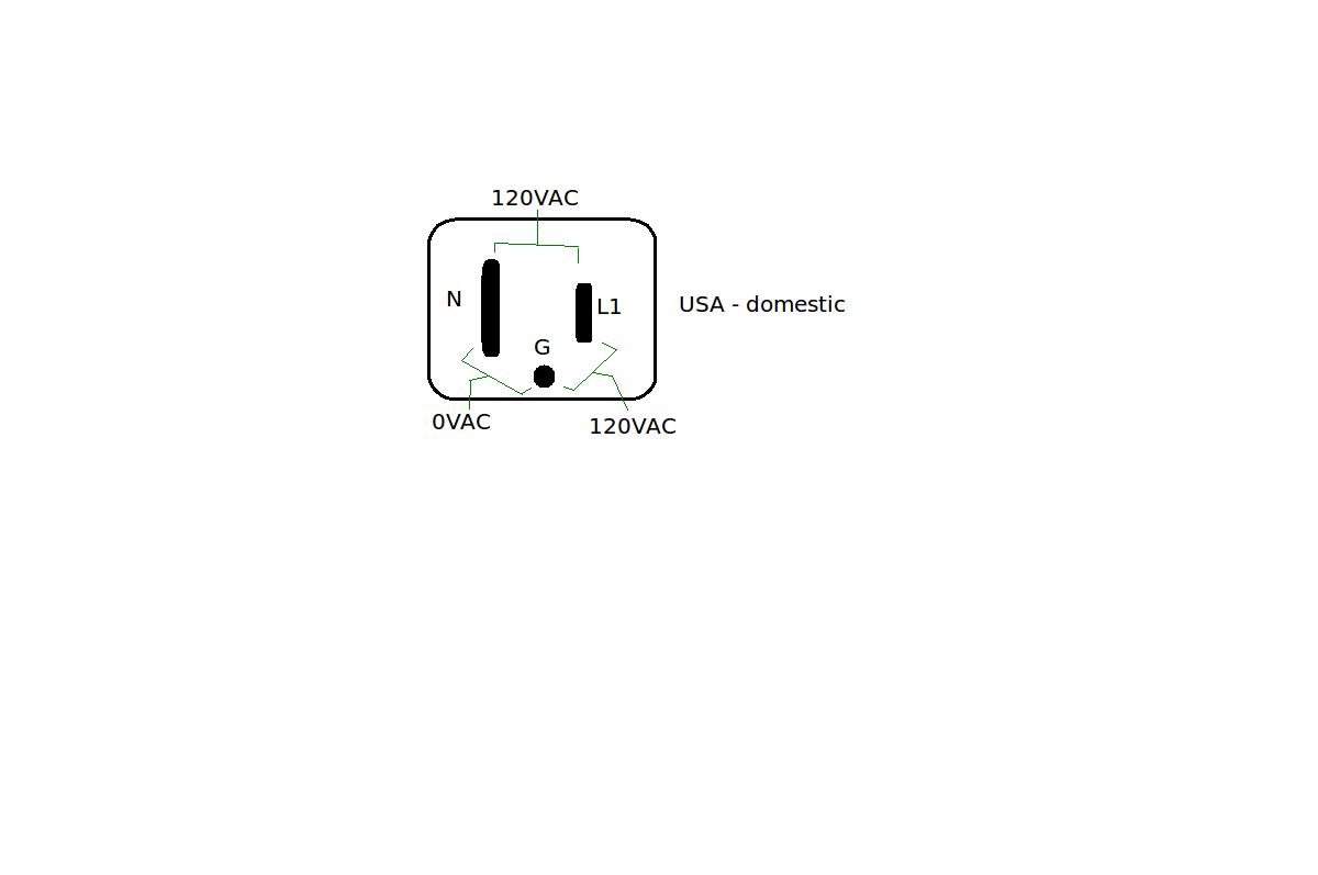

Correct! With the exception that it's AC, there's no positive as in DC. Make sure L1 connects to fuse>>switch. AC ground>>directly to chassis. Speaker and signal (line level) connects to PS ground or to a star ground. PS/star ground connects to chassis ground via thermistor or bridge rectifier. Take a look at the ZenV4 article, specifically Figure 6 - unregulated power supply example.

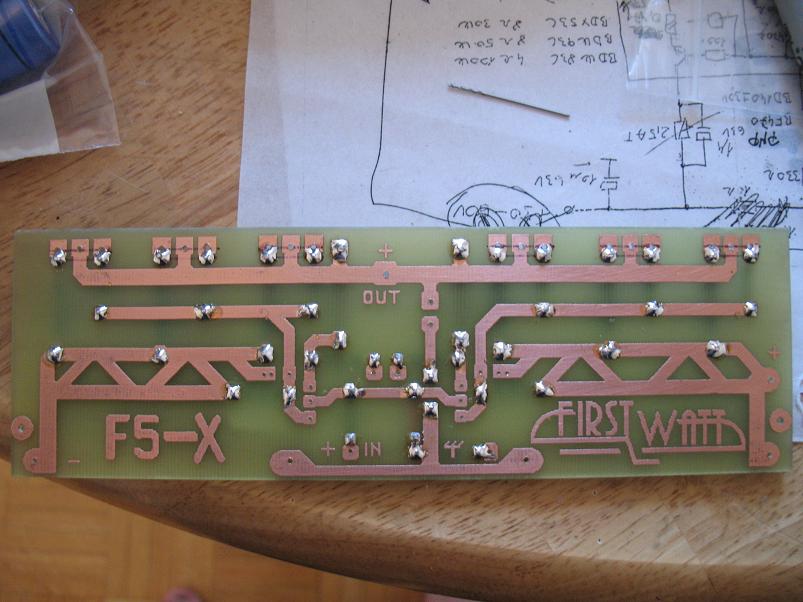

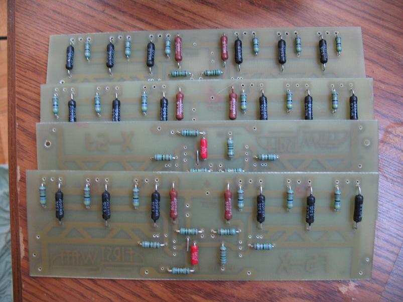

High power F5X
Today I started to populate my high power F5X PC boards .
I need to ad the 3 pair (Toshiba) MOSFETs /PC board and JFets .
Also I will have to buy some 5K trim pot .
I hope soon I can set up for testing .🙂
Some pictures
Greets

It was already successful built by 3pair IRFP MOSFETs as SE type.
I'll use Toshiba MOSFETs , easier to drive !

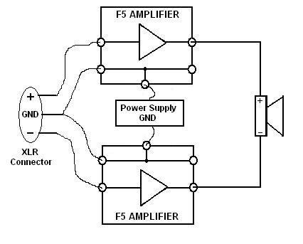

In case If I'm unable to set up the X I will connect in bridge mode .
Greets
