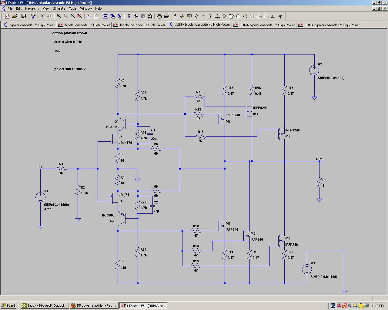

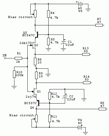

I posted the cascoded the input before .But I will posted one more time and also the full schematic .
My orig question was : The cascode was design to 40V rail , now I go with lower voltage actually 24V rail .So if I want the cascode to work fine do I have to use lower value resistor to connect the cascode to the rail and to the ground or to the JET source.

You may want to consider using V grade jFETs to give more current capability to drive the load capacitance and the lower Gm of the Laterals. This may require the cascode voltage to be altered to bring the Vgrade temp back down to acceptable levels.[/QUOTE]
Sorry about Andrew I didn't saw the "j" before the FET .
How Juma said your advise is great , I agree but if is JET or FET there is no base .
Probably he thought abut the original drawing were the cascode uses BJT .
A bit I got confused!
Posted by JUMA
Exactly! V grade JFETS are better solution here and resistors in voltage divider should be something like 4k7 from base to rail and 2k7 from base to ground.

How Juma said your advise is great , I agree but if is JET or FET there is no base .....
Are you dyslexic ? What is JET ?
JFETs are amplifying devices, BJTs are cascoding devices and they have base.
I'm afraid you can not be helped further, you disregard good advices or you interpret them wrongly, so as far as I'm concerned, you are on your own.
