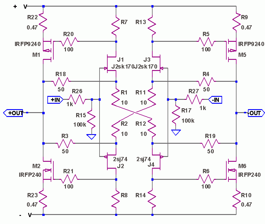

One additional remark on the difference in the balanced F5 implementations :
> But I didn't implement the output protection circuits (Q4, Q5 in the original schematic) and used identical values for the source resistors (R1,2 =10Ohm, R11,12 = 0.235Ohm) and the feedback resistors (R5,6,7,8 = 100Ohm). The output devices are 2SK1530/2SJ201 from Toshiba.
In my published circuit, which is identical to what I built, I did use different resistor values for the top (2SK170 / 2SJ201) and the bottom (2SJ74 / 2SK1530) halves. This is because while the MOSFETs are perfect complementary devices, the JFETs are not. Using different resistor values would allow gain balancing between the two halves, such as they contribute equally to driving the load, and also allow better harmonic cancellation.
In a balanced system, this cancellation is less important as in SE, as the cancellation will take place again between the left and the right halves, assuming you have (near) perfectly matched devices.
And the reason I run mine at +/-16V, 4A is simply that I have low impedance speakers. As is, you get maximum output power at about 6 ohm. (I always leave 4V Vds as minimum, by design)
Patrick

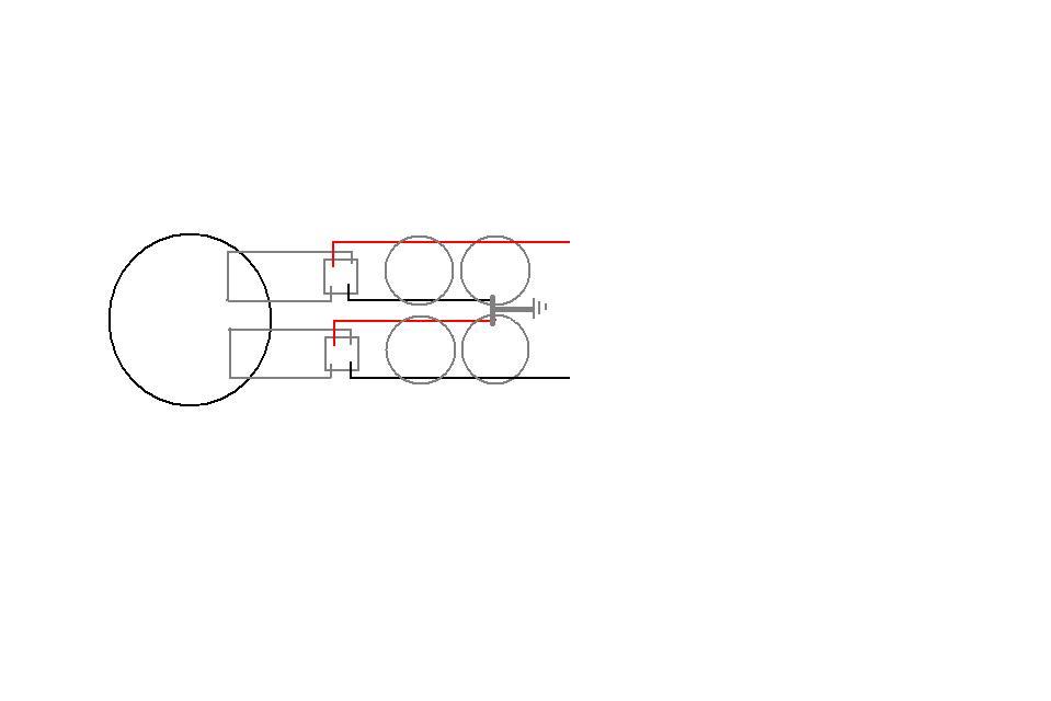

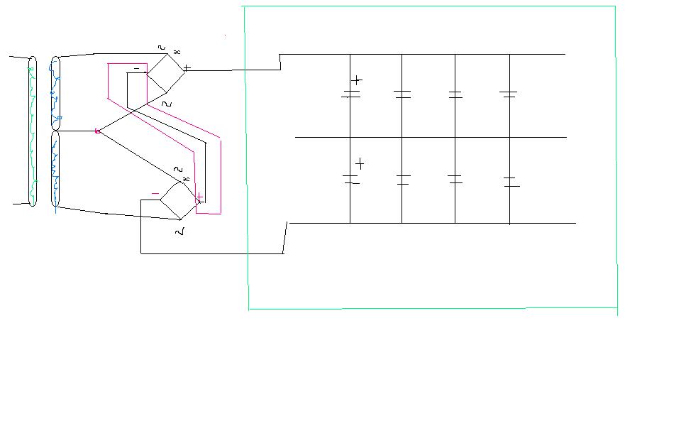

Hello ,i have problem with f5 power supply.I have transformer 18-0-18 ,2 rectifiers and capacitor bank.when i put the minus from first rectifier bridge to plus to second one ,become short cut.what to do?

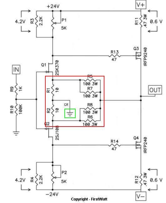

The cascode story out of the table after I decided to go with the X wich would be powered by 24V rail .
For that reason I no longer need cascode .
Our question with Thanh the feedback loop ground .
If you take a look the regular F5 the four 100R resistors (R5, R6, R7, R8) is connected to the ground by the two 10R resistors (R1,R2)
Now at the X verizon R1 & R2 cross connected , X-ed .
My question if those resistors still have to be connected to the ground to ???
I think is very important these to be clear !!!
Sorry I forget to attach the schematic , that would make easier to understand our question .
If you look at the red box there is a ground connection .
Do I have to use that ground at the X verizon???
These is my last question , if I will know the answer I can go on to each the PC boards .
PLEASE IF SOMEONE KNOW THE RIGHT ANSWER LET US KNOW ,please help with these . Thank you very much !!

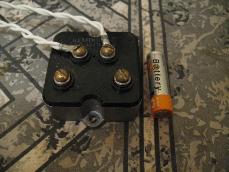

I have a heavy duty Semikron 100A bridge probably I will use that .
In my Aleph X works well . And the quality not bad either . Also your drawing is OK .
I did com paired these bridge with a couple another type bridge , I like these better .
My opinion about the ground question we not supposed to connect the X to the ground at least not that way how is connected in the reg.F5 . It would be shorted the X .
But I hope I get some answer from some expert guy . Because the feedback at the F5 is connected to the ground by the 2 10R resistors .

I think it was answered before
Balanced input has a pos and neg AND a ground
You may say that the usual ground on a "single ended" is changed to a hot negative
Ground on a balanced is different from ground on a single ended
Probably not right either, but whatever
Also bare in mind that F5 is a ready to go design
And in its commercial form should work flawlessly anywhere in the world, with all sorts of strange gears connected
Could be its just a precaution against noise issues
Anyway, either of them are supposed to work as is
Just choose the one you like and build it
