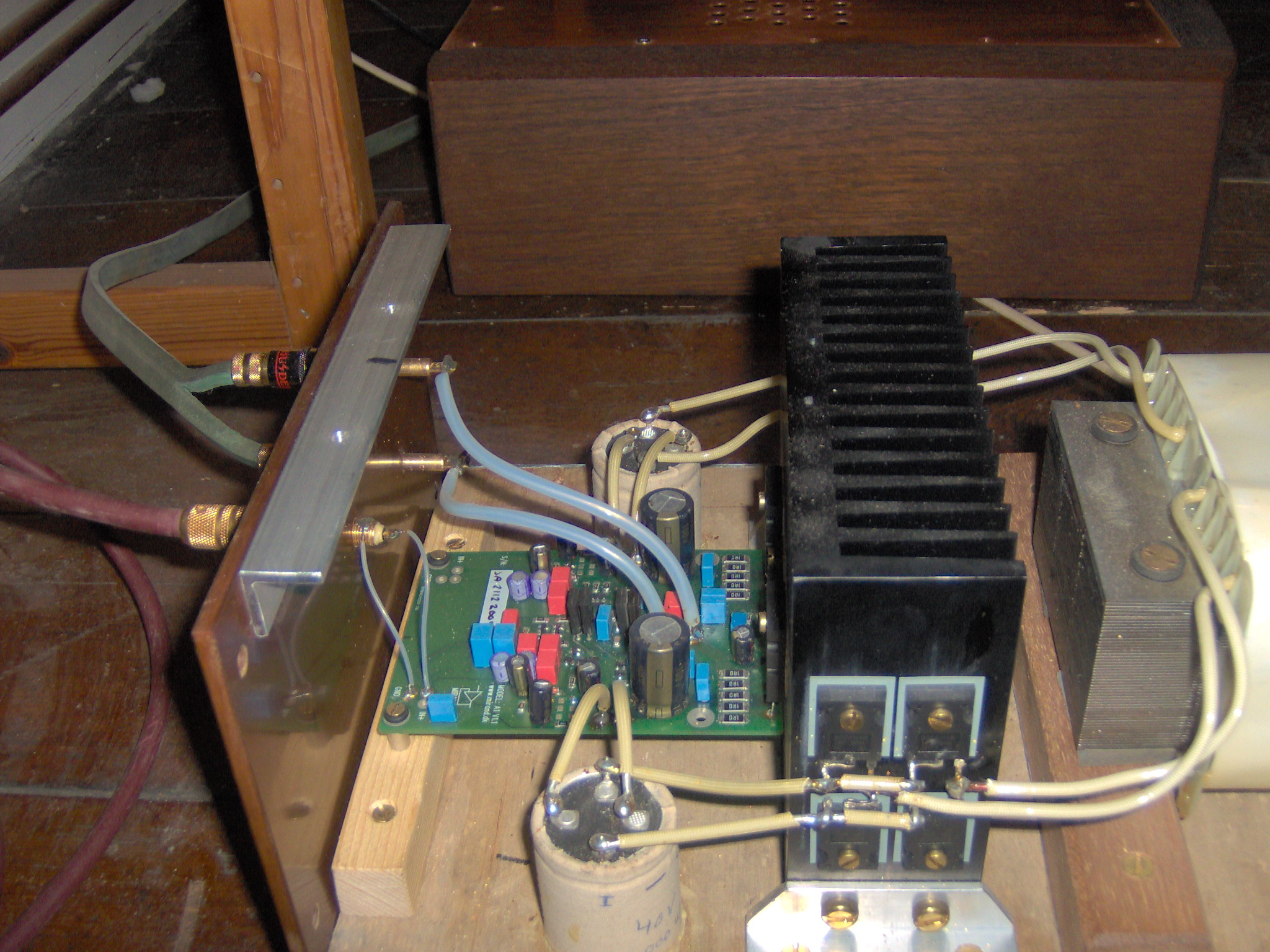

I used this
Hyperfast :snail:and fast recovery, which I didnt know about back then 😱
Appears to work ok though, since amp sounds nice, and beats many around
But now I wonder if I should try "soft recovery" types
https://www1.elfa.se/data1/wwwroot/webroot/Z_DATA/07023393.pdf
Bridge is mounted on sides of heatsink
I would NOT do that with classA
Hope picture will change to F5 next time😛

I have used MUR860's and HexFred diodes...ashamed to admit I can't tell the difference.
Nothing to be ashamed of - maybe both are quite good at it.
I was wondering whether the MUR 860 (I have got bunches around) is up to the task for 2 channels of F5. They are specified with 8 A maximum. Is that enough safety margin for this application?
I have also got spare PCBs of the CarlosFM PSU here that uses these MUR 860s. I could use them together wit Civiller PSU boards in a CRCLC configuration, if they could stand the current draw. Can anyone advice on this?
The IR 30EPH06 used by Tinitus is of a totally different caliber. It is rated with 30 A. Has anyone else experience with these?
I used this

BTW, do they get warm?
Hi Tinitus,
I didnt see the soft recovery, so you saved me there, thanks
No, they dont get hot
Or, as hot as the heatsink the outputs are mounted on
I have driven a 1ohm speaker, but it definately liked 2ohm better
Its a 50wat, so could ad up to considerably amount of current
I dont know, but F5 is not designed to deliver huge amounts of current
Might help if you use double bridge on each channel
May depend on the heatsink, or whatever you choose to mount them on
Maybe power-up is the worst possible situation
But really, I dont know how much current flows in each diode of a bridge
But basicly it shouldnt be much more than bias current, and use the original curcuit with limiters
And maybe save a bit an trafo size
And, depending on your speakers
But again, power-up could be the most critical situation
But personally, that may not be where I would save money
