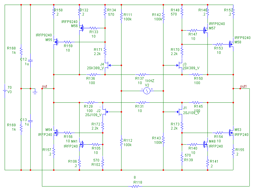

High Power Balanced F5
To run the amp at a higher supply voltage, as some one suggested, I tried cascoding the input JFET's but I really couldn't find much advantage. I find just adding resistors fixes the problem and the performance is almost identical.
I think this is my last iteration of this design, I have tried many other variations with not much improvement in the performance. Though I may scale the design down for a preamp.
I think my next step will be to build it. I have the heatsinks, the transformers and most of the metal work for the case. I just need to design a board and find some JFETs.
Cheers
Tim

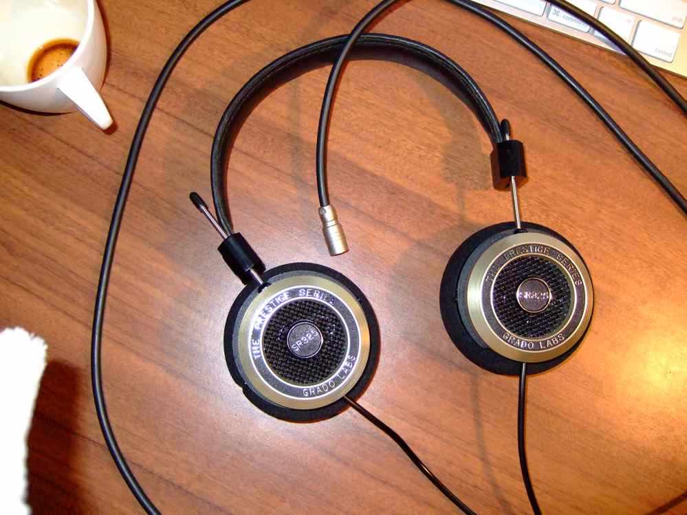

jameshillj said:
Tim,
While you're at your computer, could you possibly scale this cct down to drive a pair of headphones from 32R (grado ) up to 600R (Senn), with matched pairs of k170+j74 and 610+9610? And still have Zin of >100kR?
I could probably do that, I could make it a preamp that is able to drive headphones, but do you realize, you would have to cut the plugs off your headphones and replace them with a 4 pin plug.
