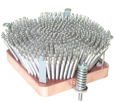

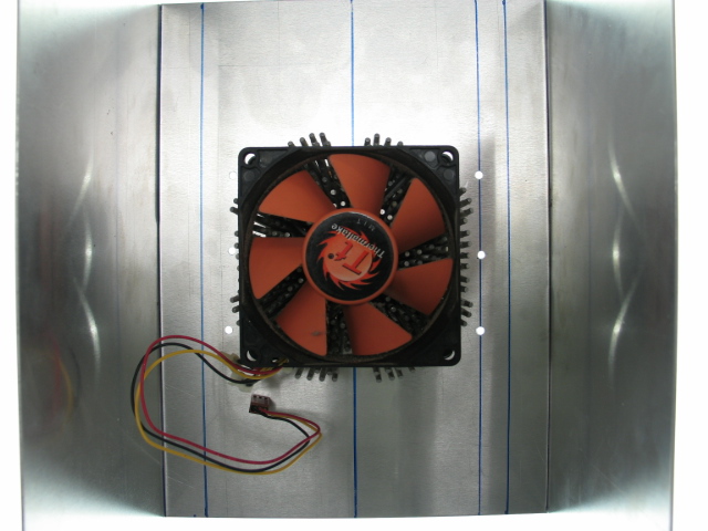

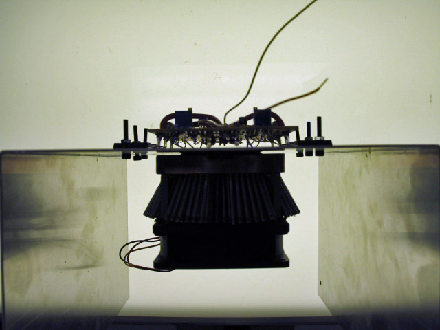

I just did some calculations.
One of these heatsinks will dissipate 200W for a 30 degree (celsius) rise above ambient with the right type of fan (ie very noisy). OK for testing.
For a silent setup (ie quiet fan) it will dissipate 130W.
very interesting if this works out good for you. 130w is a good achievement, what's one of those things cost? Is it cheapert than a appropriate heatsink?
