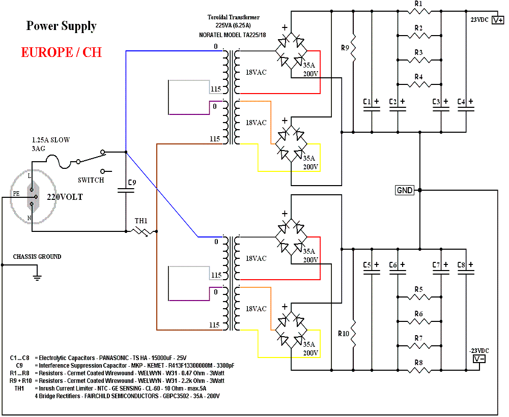

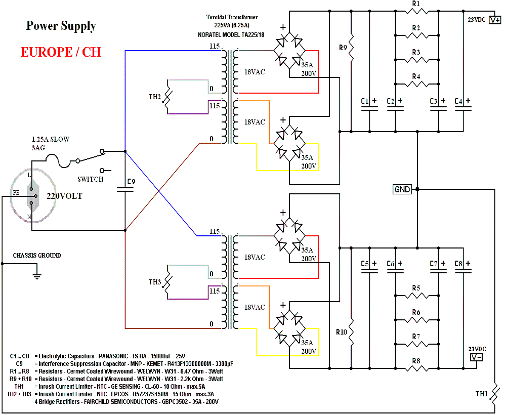

First i have to put the PSU into the case,
and there are some questions about thermistors i should use.
This is something I DO NOT KNOW IF IT REALLY WORKS FINE,
How should i calculate those Thermistors ?
TH1 should be ok i think, but how about TH2 + TH3 ?
Please correct me, if there is something wrong.

Sisyphism said:Yes, pots at minimum = Zero Ohm.
Please correct me, if there is something wrong.![]()
You seem to be using 3 thremistors where one would do the job.
I dont think you need TH1 just connect it to earth for safety.
If you put TH1 in series with mains you dont need TH2.
Those thermistors are calculated for you. Check the bottom of your schematic you posted and it tells values and part numbers for all of them.
When you fire it up you can use your variac but you can use this as well
http://www.antiqueradio.org/dimbulb.htm
This is the dim bulb tester they were talking about and it has saved a few of my amps.
500w is more than enough.
Uriah

Re: PSU 230V
Yes, providing you can get a thermistor powerful enough to take all the current to both transformers.
Sisyphism said:If i understand it right, nigelwright7557 thinks this way is ok.
Thanks.
