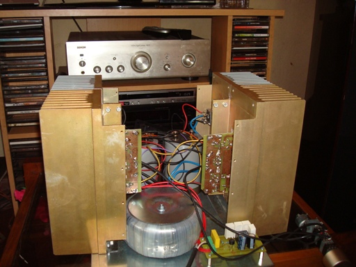

Hi Stein2
As an experiment could you try running those big motor caps along with a 1000uF cap in parallel and directly connect them to the source pins of the output mosfets and the other end of the caps run to ground.
I tried this on another amp and it made quite an improvement.
It is worth a try if you are the type that likes to experiment a bit.
