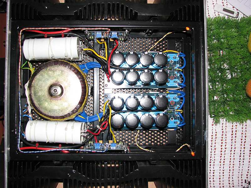

I found out the hard way that this amp is sensitive to picking up emf/rf noise if you have your speaker outputs or power cord close to your input rca's. I spent a lot of time on trying to fix my grounds but it wasn't a ground loop hum (sort of sounded like one but higher pitched and more staticky). I used magnet shield from lessemf.com around my transformer and this cut my noise in half. Using heavily shielded interconnects and adding a shield wire for the signal path internally eliminated all noise.
juluska said:I have this 100hz hum from psu. I use 8 x 10000uf caps. I suppose i must use more than 8 x 15.000 uf. What about 8 x 220000 uf, can these reduce this noise.
Re: Re: hum
Interesting... This is how I built both my dual-mono F5s, no hum, no interference, no problems....

Assuming that the amp is not actually miswired, then it's almost
always the magnetic field radiated by the transformer. You can
rotate or move the transformer, and of course any distance you can
place between signal wiring and transformer will help.
Very often the transformer field creates a ground loop issue between
the input grounds being connected together at the source. You can
check for this by using a pair of shorting plugs on the inputs or by
lifting the input ground on one channel.
