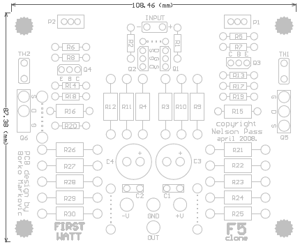

bogdan_borko said:I`ve been working on the F5 pcb for some time and this is my version. (This is "3D" view from Protel).
naah ..........
too green !
(fugly!)
and let me tell you, those pots are "titchy"
