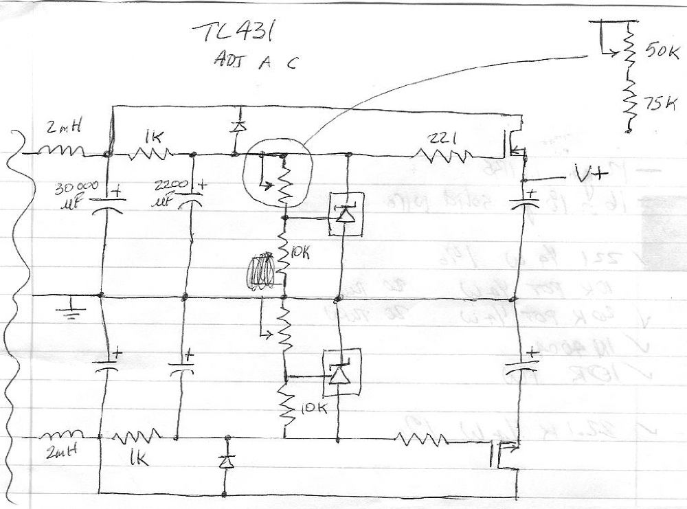

Nelson Pass said:If you use a voltage reference like a TL431, it needs 0.4 mA. That
allows a loss of about 0.5V if you use a 1K resistor from the supply
to the drive for the Mosfet and use the TL431 in parallel with a cap.
Place a diode reverse biased on the resistor that biases the TL431 so
that the Gate of the Mosfet won't see any voltage on turn-off.
There. Now you can have only 4V loss = 24V.
Put a big fat capacitor to ground from the Source of the Mosfet to
reduce the ripple due to audio currents.
Thanks for the help Nelson. You are too kind.

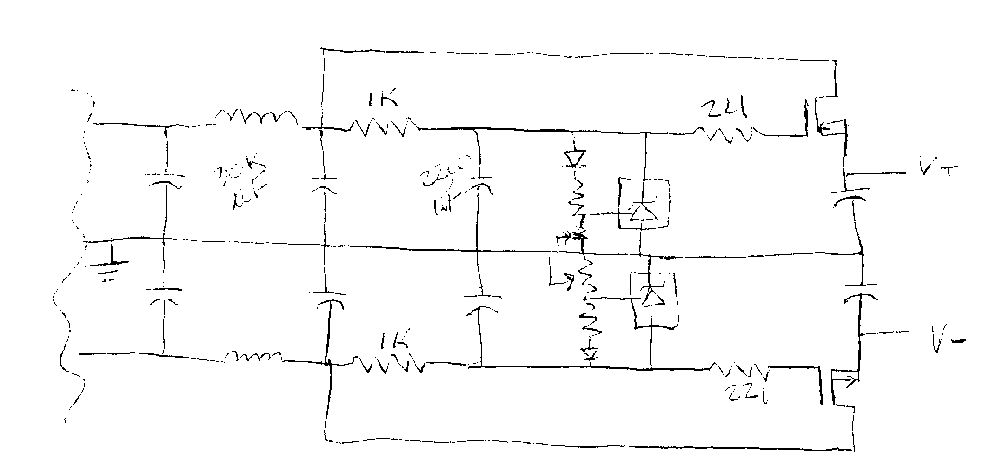

Do you mean to take the Zen5 power supply and replace Z1 and Z2 with
TL431's (with a voltage divider network to "program" it)?
Or do you mean to take the Zen5 power supply, replace Z1 and Z2 with
the TL431's, and move D1 and D2 like the attached diagram?
I have really learned a lot, but I'm sorry my friend, I still have a long way
to go. I think the main part of my confusion with this power supply (the
original Zen 5) is a lack of understanding of how we handle when the
coils de-energize, and how we discharge the 2200uF caps (where does
the energy go and by what path?).
Thank you again,
Robert

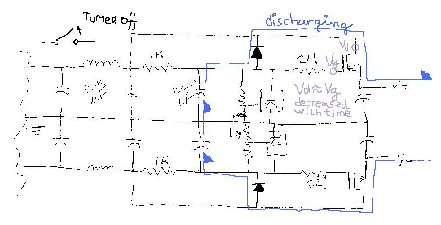

I have just finished some breads for breakfast. Ah . . . Papa has already been here with good advice . . .
Anyhow . . .
I have thought about the diode location as attached. Then, 2200uF could be discharged as shown.
The closed LCR circuit with initially charged cap would create an oscillation. But, the oscillation will die out with time because of the energy lost in the resistor.
Anyhow . . .
discharging path and soft start ?

Re: discharging path and soft start ?
Yeah . . . !
Nevertheless, the "diodes" are
to protect the mosfets in case . . .
Zen Mod said:
amp - drawing something under 3A for both channels - is pretty capable to bleed anything form cap bank - after powering off .
Yeah . . . !

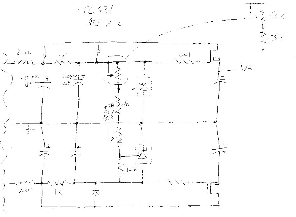

Nelson mentioned using a TL431 shunt regulator. So here is a modified Zen 5
power supply circuit with the TL431's that are (so far at least) working for me.
The surprising part for me is that the resistor values need to be so high...
Anyway, for what it is worth, here is the circuit.
Thanks,
Robert
